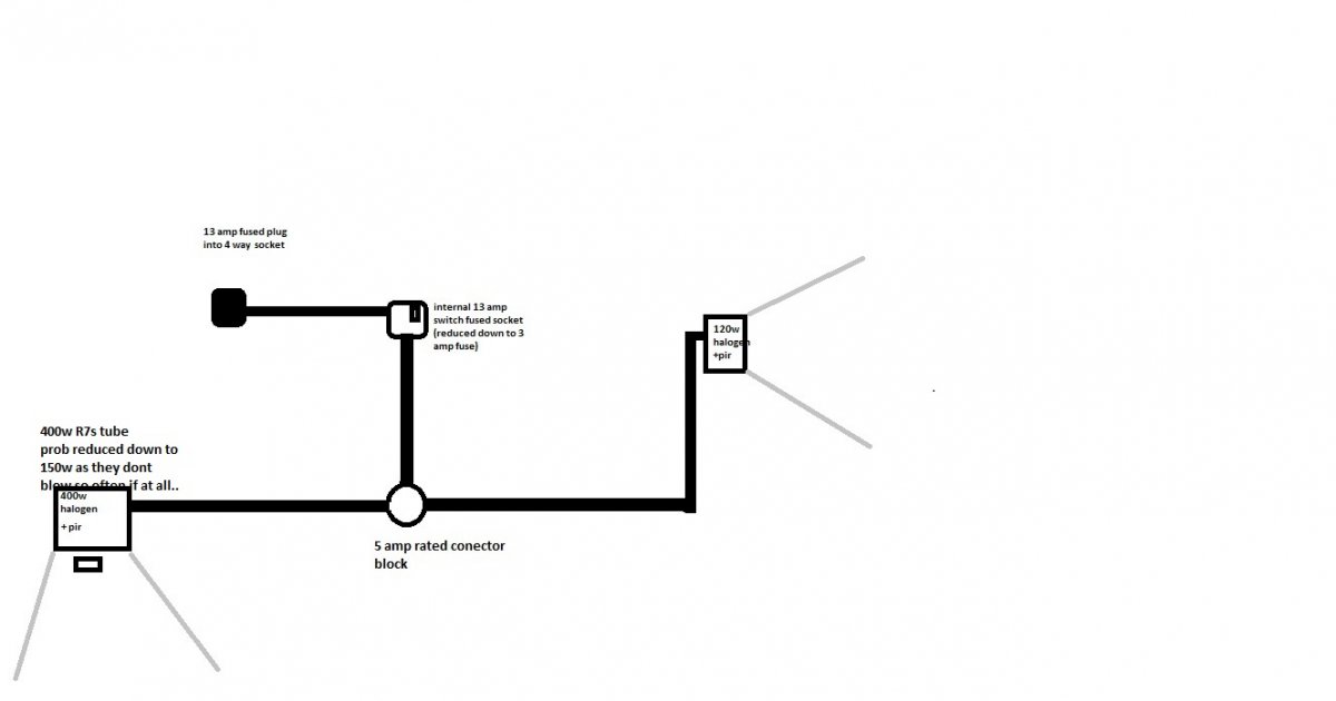

hi peeps, i currently have a 150 w floodlight on the wall with a pir but this is not working so good now. I am going to replace it with a new one and add a smaller 120w floodlight around the corner but wire two lights up into one power lead...i have asked a sparky mate if this is ok and he said yes with a few changes...so iv done a diagram first and thought id get you guys to see if its ok? thanks.

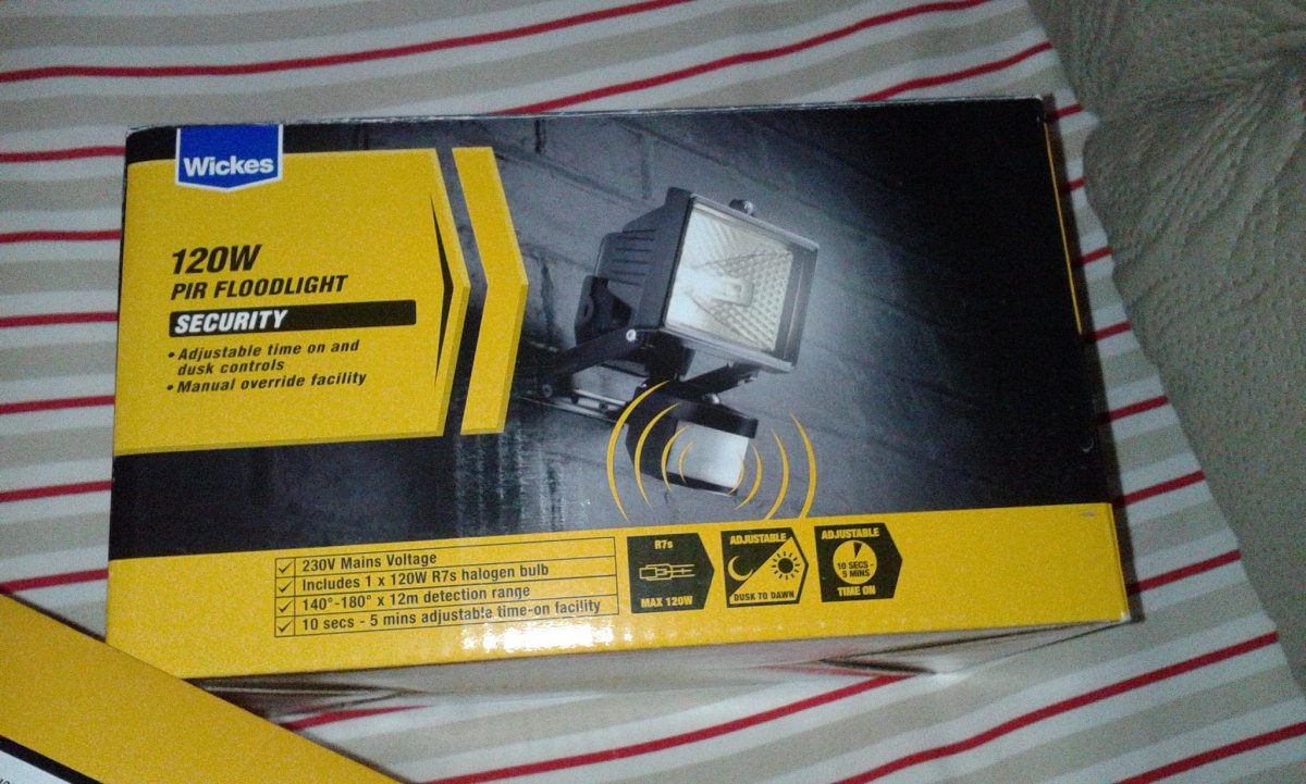

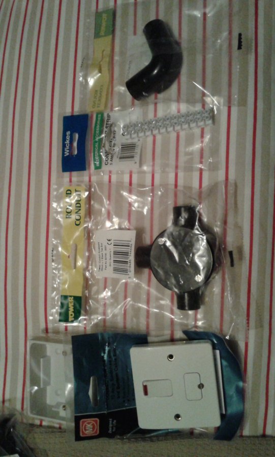

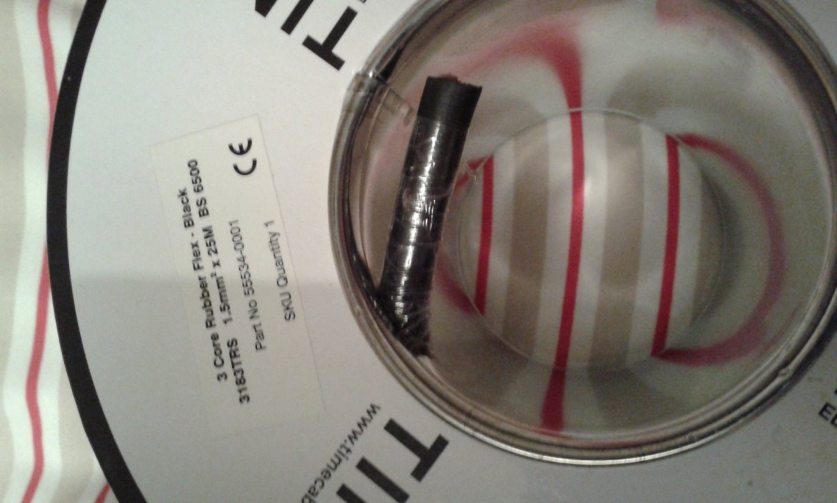

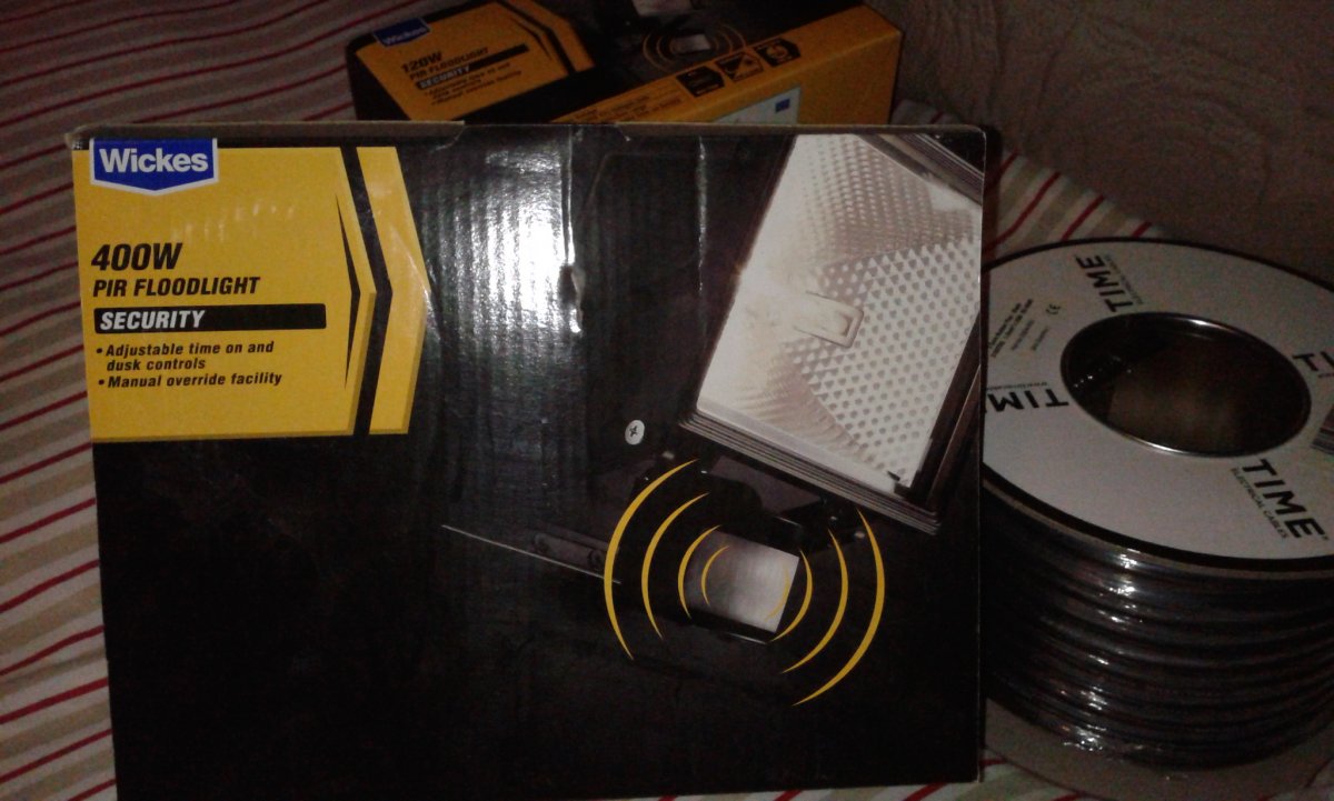

some of the items i would be using if its doable...if not i have the reciepts..lol

If you want to reduce the bulbs blowing (per your drawing) and save yourself some energy cost ££££
Then take the two halogen floodlights back and get 10 or 20watt PIR LED floodlights instead.
Not only will they use a tenth of the electricity, but they have a life of 10 times that of halogen.
the pirs should be ok...the main ones been ok up till now..lol would you replace the 120w with 10w and the 150w with 20w....are they as bright ?
Probably. But the problem is that watts is the amount of ENERGY used by the light. It has very little to do with the amount of light emitted.
To compare light output you need to compare the number of LUMENS. That's why lights these days include the output in LUMENS.
The type of lamp has a bearing ie the colour temperature of the light. Is it cool white, or warm light or daylight etc.
A general comparison table can be found here
https://bright-led.co.uk/led_comparisons
look at the halogen section.
