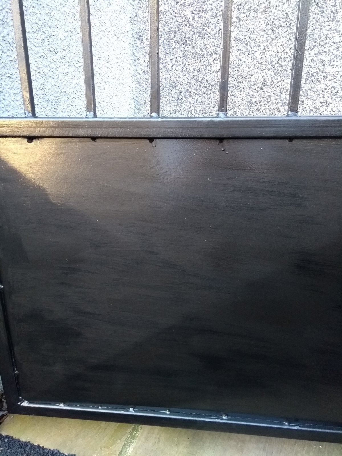

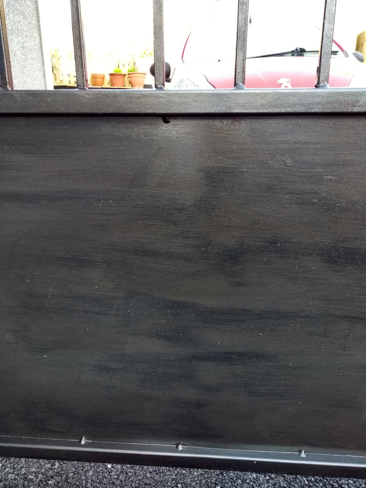

Hi, my galvanised gates needed freshening up so I put this stuff on. Looks ok on the bars, but on the bottom panels you can see every brush stroke, looks worse than before. Gave it a light stir as directed, but the top of the paint maintained a sparkly look, just doesn't look right, is this the finish to be expected?
If you painted direct to rust, I guess so
You can probably improve the look by waiting a reasonable time for the paint to dry and then a light sand. It takes a while to go off, and if too soft will mess the job up
Being xylene based, Hammerite is a most difficult product to apply on any larger area.....the brush picks up the paint every time and causes streaking. This is called ‘overbrushing’ on the can.
Although it has its uses on metalwork, it certainly doesn’t cure rust. Maybe you’d get a better finish from a spray can?
John :)
Cheers guys, there was no rust it was just weathered, assumed it would be ok and all that screwfix had in, would the "normal" satin paint sit ok on top of this? Not happy tho
Worse than before despite following instructions

Would normal gloss go on this to make it better? So disappointed with this product as not cheap. Thank you

Nope, metal. That's why I can't understand the state of it, if it was cheap paid I'd understand but this is probably one of the most expensive. Not impressed
For sure, its a difficult one. You could improve things, I think, by laying the gates flat and going over them with a Hammerite Smoothrite silver aerosol.
No guarantees of course, Hammerite is awful to remove and will only sand once its been on a while.
