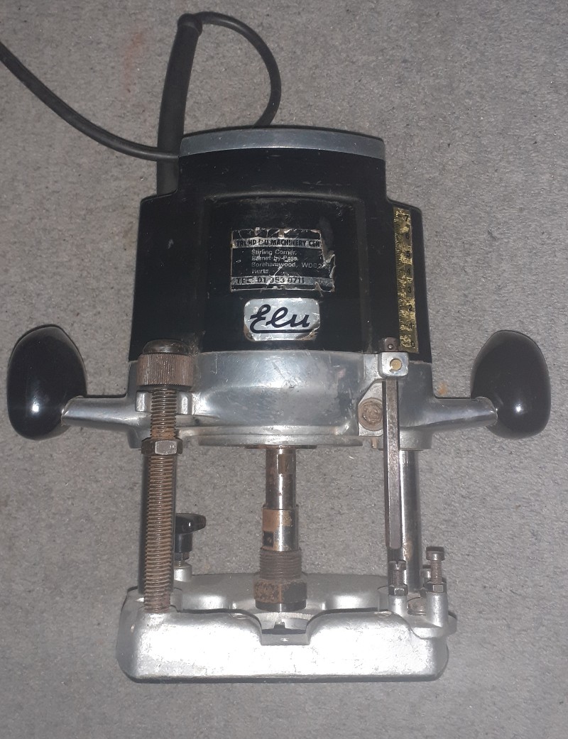

1200 watts may not be a lot of power, but it was all that was available in even professional/industrial plunge routers in the 1970s until the "massive" 1600 watt models came along...
Above: Elu MOF31 industrial plunge router from about 1969. 1200 watts at 18,000rpm fixed speed. Probably not too different in size to the OPs tool
