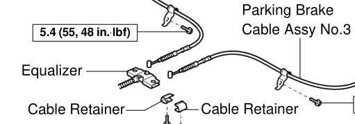

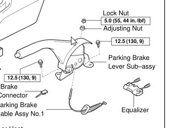

    Hi,
    My Toyota Corolla has handbrake cables as in the diagram below.
    It has separate cables going to each rear drum, which as I understand, the equaliser should apply equal force to each.

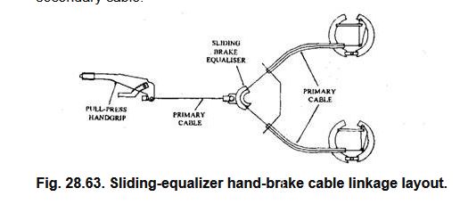

    ( that said its a little easier to understand the equaliser on set ups that have a looped cable going to both drums as in the second pic fig 28)
    However am having real problems adjusting the shoes properly and though I can see, with the drums off, the cables move ok and 'open' the shoes, when the drums are on, one side fails to exert any real pressure.
    Could its cable be overstretched and the equaliser not able to produce the force needed to hold it on properly ??
    The other drum locks up properly.
    The cables have been inspected at all ends and are not frayed or rusted; actually very well protected.
    Toyota cables
    Typical loop cable

    Is the cable arrangement on your car like the first pic or the second?
    If it's like the first, the equalizer would turn to a crazy angle if one of the brakes was having an issue - much less so if it was the second type as it would be much more difficult to tell.
    When I set up hand brakes, I put the lever up two clicks, and then spin each jacked up wheel, checking that the wheels spin with the same amount of effort. One more click and the wheels should lock - again with the same degree of force.
    It interests me that you say the handbrake lever on the drum is external.....not too common I would have thought these days.
    Best of luck with it!
    John :)

    Its like the top pic in post #1, the Toyota one, its the same as the full system below but they only show the earlier model with drum only whereas mine has the combined drum and disc. Handbrake drum ... external , think I must have described incorrectly.
    The only adjustments being on the handbrake lever and the two star wheels on the shoes, the rear cables are fixed with no adjustment.
    Yes, I adjust them in a similar fashion.
