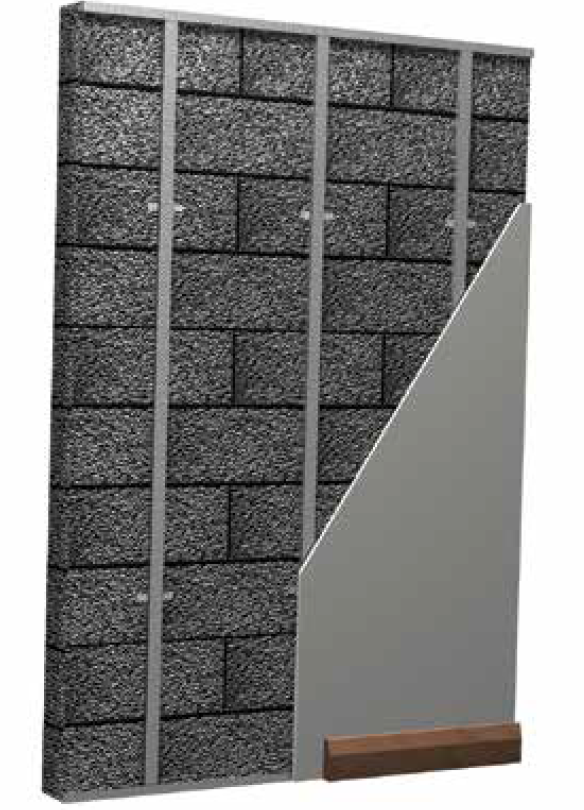

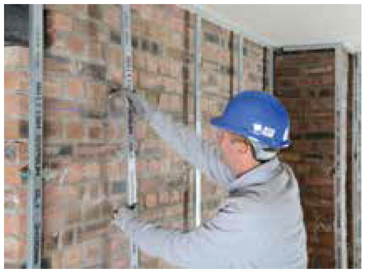

Sorry about the confusion on the wall. I remember seeing it as they were building it and I thought it was breeze block with metal studs i.e. an internal load bearing wall with metal studs and plasterboard (Apologies, but I don’t know much about building walls).
OK, sounds like you could well have GypLyner or similar then...
Something like corefix fixings would be ideal then in order to fix into the block. They bridge the gap(up to 25mm) between the back of the plasterboard and the block so that the plasterboard doesn't pull in toward the wall and crack when you tighten the screws.
Could you drill a test hole to see what size gap you have to see if these are suitable?
edit: You don't need to bother with the rail I mentioned earlier doing it this way.
