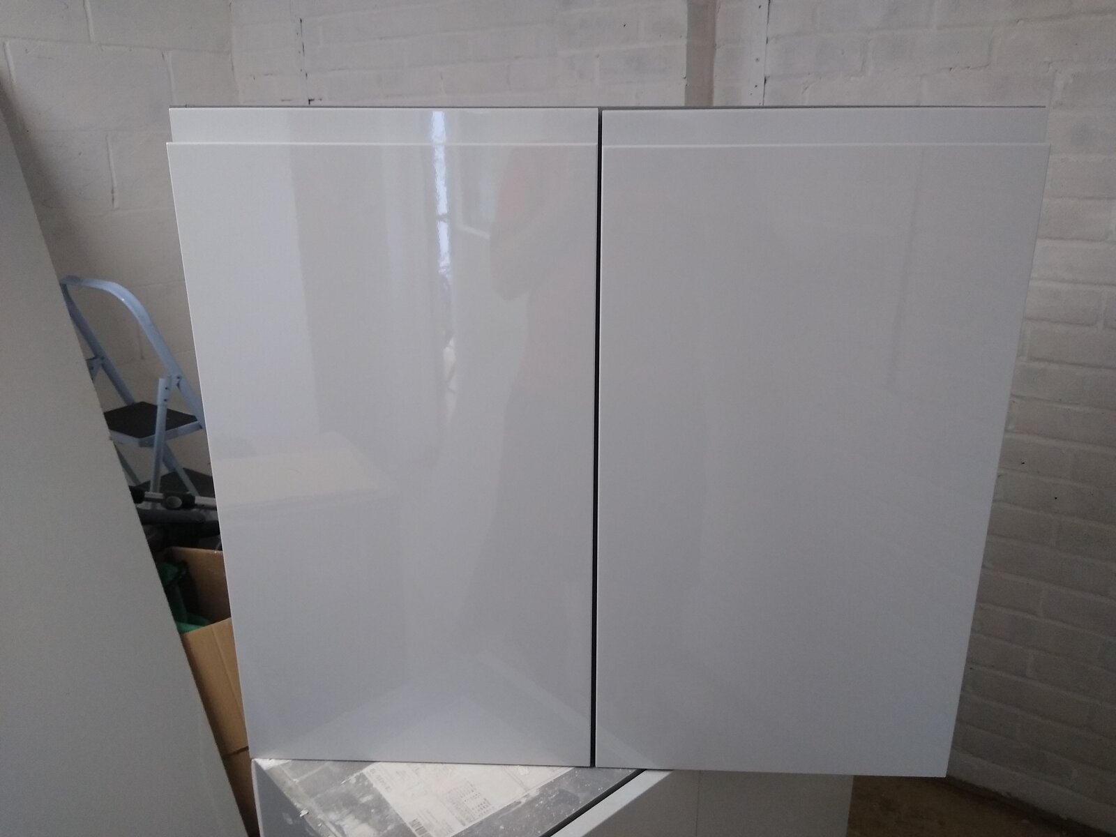

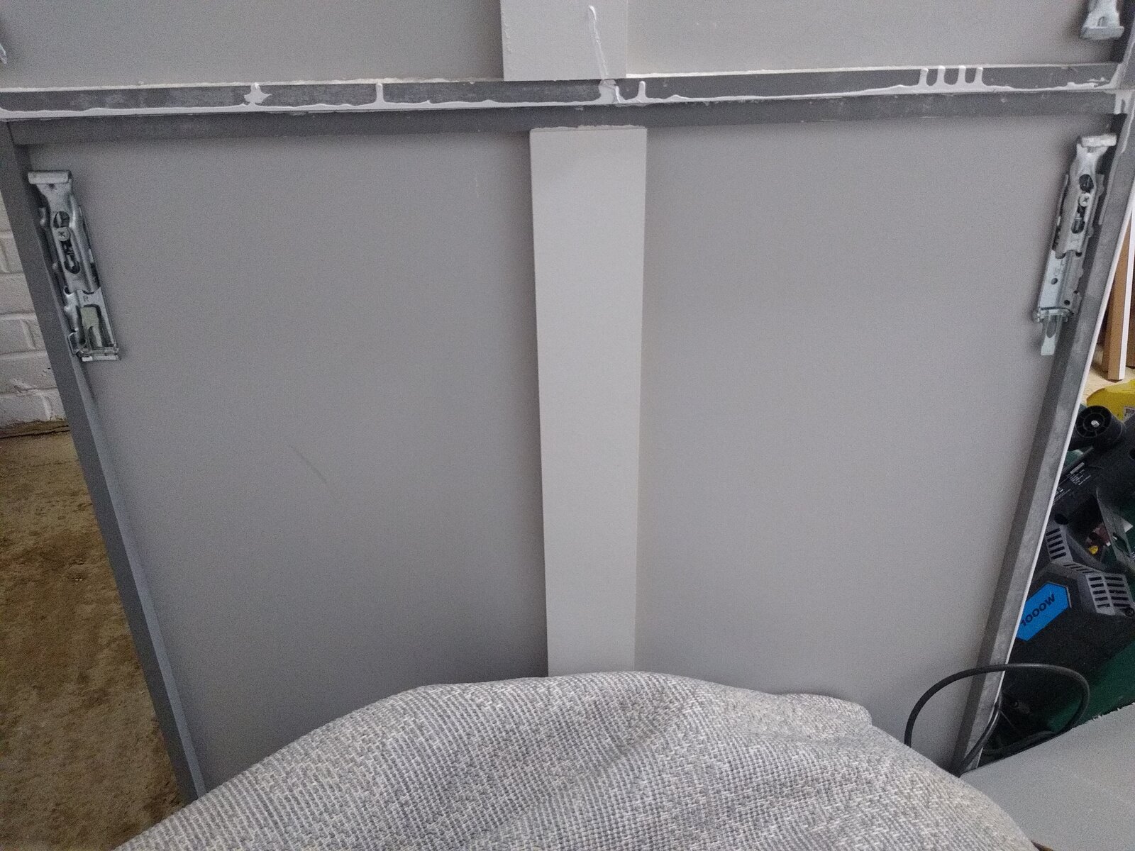

Hi,

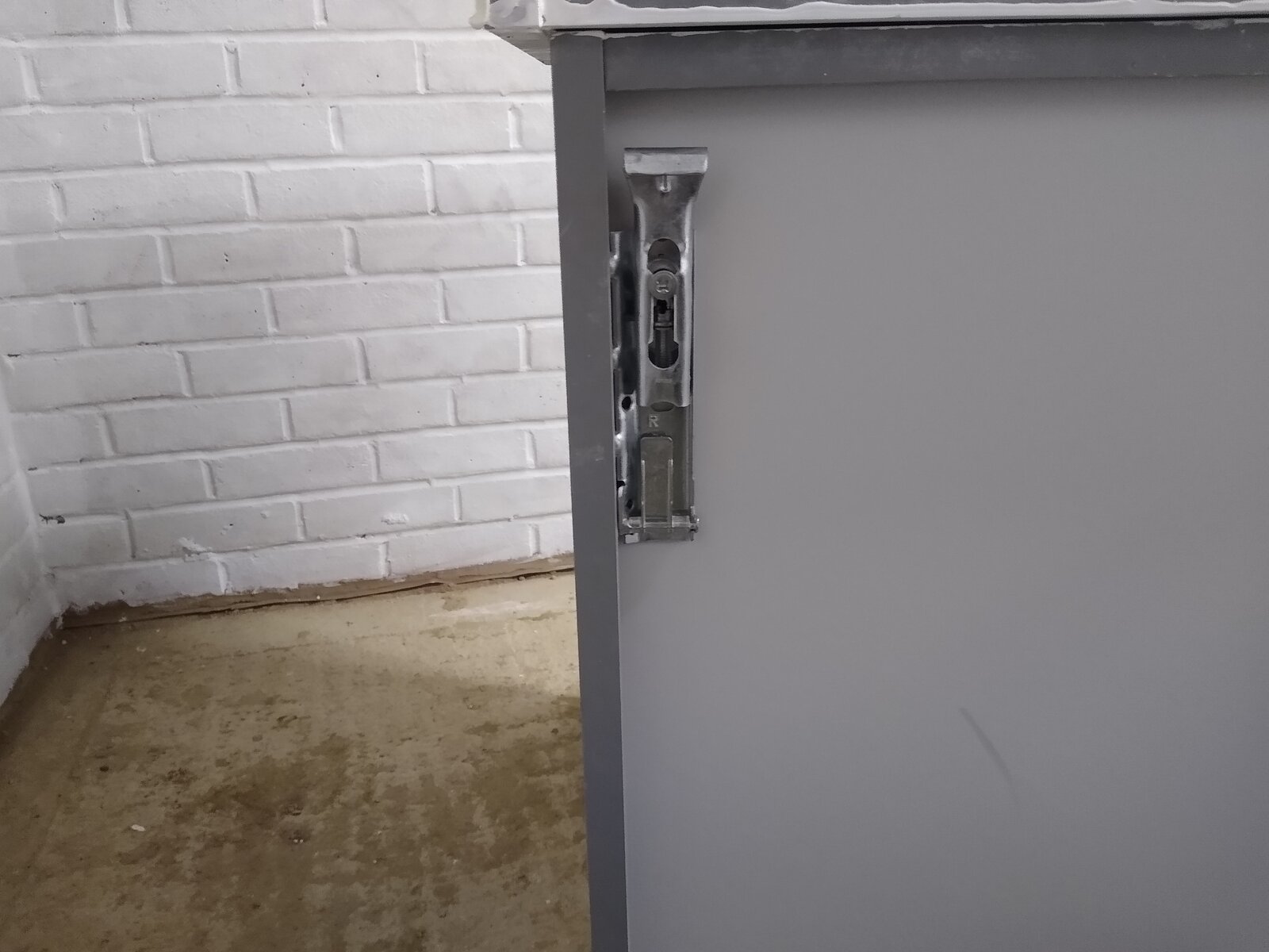

I'd like to put a spare kitchen cabinet up in my garage for extra storage. It has the following fixing as per the photos.
Can anyone kindly advise what wall bracket/fixing I'd need in order to hang this securely to the brick wall?
Many Thanks
I might be wrong (wouldn’t be the first time:D) but I think these clip on to a hanging rail that is screwed to the wall.
Ok great that's very helpful. Would you recommend one longer rail for added strength or are smaller ones ok?
Assume the fixings already on the cupboard simply fix onto these? Sorry if it's stating the obvious!
Much appreciated.
Hanging rails are easier to install and get level than the puny little hanging brackets kitchen makers supply. They are also stronger and even in a ropey wall or a stud wall you'll always be able to get some fixes in the wall to carry the rail. For a run of cabinets you will need to cut notches out at the back of the cabinets to allow the rails to run through

Ok, I have a few of these brackets as below. Do you think they will suitable/strong enough to hang the cupboard?
The wall I wish to attach to is actually thermalite I believe. Any recommendations on screw length and corresponding wall fixing would be appreciated. Thank you.
They are, but in Thermalites you may struggle to get them levelled up properly or even in the right places because those blocks can be a PIA to drill accurately. For lightweight blocks I find the longer rails are a lot easier to level up, partly because if one hole wanders off, falls on a crack or a mortar joint you can always put anothervin to left or right. BTW in terms of drilling turn the hammer action off if using an SDS drll, and if using brown plugs (normally a 7mm hole) use either a 6.5mm our even a 6mm drill bit (and make sure that your drill bit is straight)
