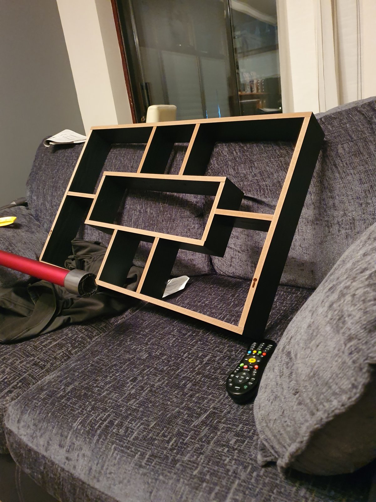

Now this time I'm hanging a frame that isnt exactly heavy duty but will of course have things on it.
The fixings I got with it wouldnt be good enough because of the dot and dab thing before hitting block (or at least that's what I took away from the previous thread but could be wrong)...
So I bought some hammer fixings no 8 * 120mm by Fischer after a recommendation.
I'm now regretting it as I really dont think they need to be 120mm... but alas, under the pressure of the mrs I went ahead and gave it a go...
Drilled in and as it was getting to the perfect point the drill seemed to finish the block and lurched forward to the wall..
Why would that be? It's like I've got through to the other side? What have I ****ed up this time?

Well the bricks are typically only 100mm wide so yeah, you've probably just broken through into the cavity. No big deal.
I'd personally prefer to have the expanding bit mid-depth of the brick as the drill may have blown a bit of the back face of the brick as it exited, not leaving much for it to grab onto. But once it's in there and expanded, it definitely wont come back out and you're not going to be hanging a huge weight on these unless you like putting your gold bars on display?
Whack it in, give it a tug, if you can't pull it out, you're good to go.
Hammer fixing way to large for little shelf, only needs 70-80mm screw in standard plugs.
How heavy roughly will the total weight be?
It looks light enough that using duopower or Uno's into the plasterboard would suffice
Hammer fixings is way overkill

So I messed up with the hammer fixings. Fair enough. Lesson learned. Since I started I thought I may as well do the second hole the same since whilst overkill people said it would be fine...
Hole went through a treat, no issue. Put the plug in, start screwing the screw in and as its bearing where I need it the plug starts rotating with every turn, so I'm guessing for some reason the hole is too big, dont understand why as everything was done the same as the other.
Next thing I know the plugs gone deeper into the wall...
What now?
I'm really not cut out for this malarkey. Still trying though ha.
Yep, definitely not my bag this. Drilled a couple of mm to the left of where I need to be. Wouldn't even fit on if the fixing had gone in nicely. WTF do I do now other than cry/laugh/give up.
You don't screw in hammer fixings , you hammer them in hence the name....
You will need to start again a little higher/lower/left/right of the holes you have already made and fill those ones in

Yes those should be hammered in, they are designed to be quick and easy to install
Thought you were drilling through plasterboard into block? If so any bog standard filler will do

That will do even if I have gone 100mm through the block? How does it push through to fill out the hole? Or do i only need to fill the plaster board hole for appearance?
Thanks for the help
Just filling in the plaster board is fine
I've never used those fixings but they look dolike they will do the job
If you are worried about the hole you punched through the block then squeeze some mastic into the hole to seal it before applying filler to make good
