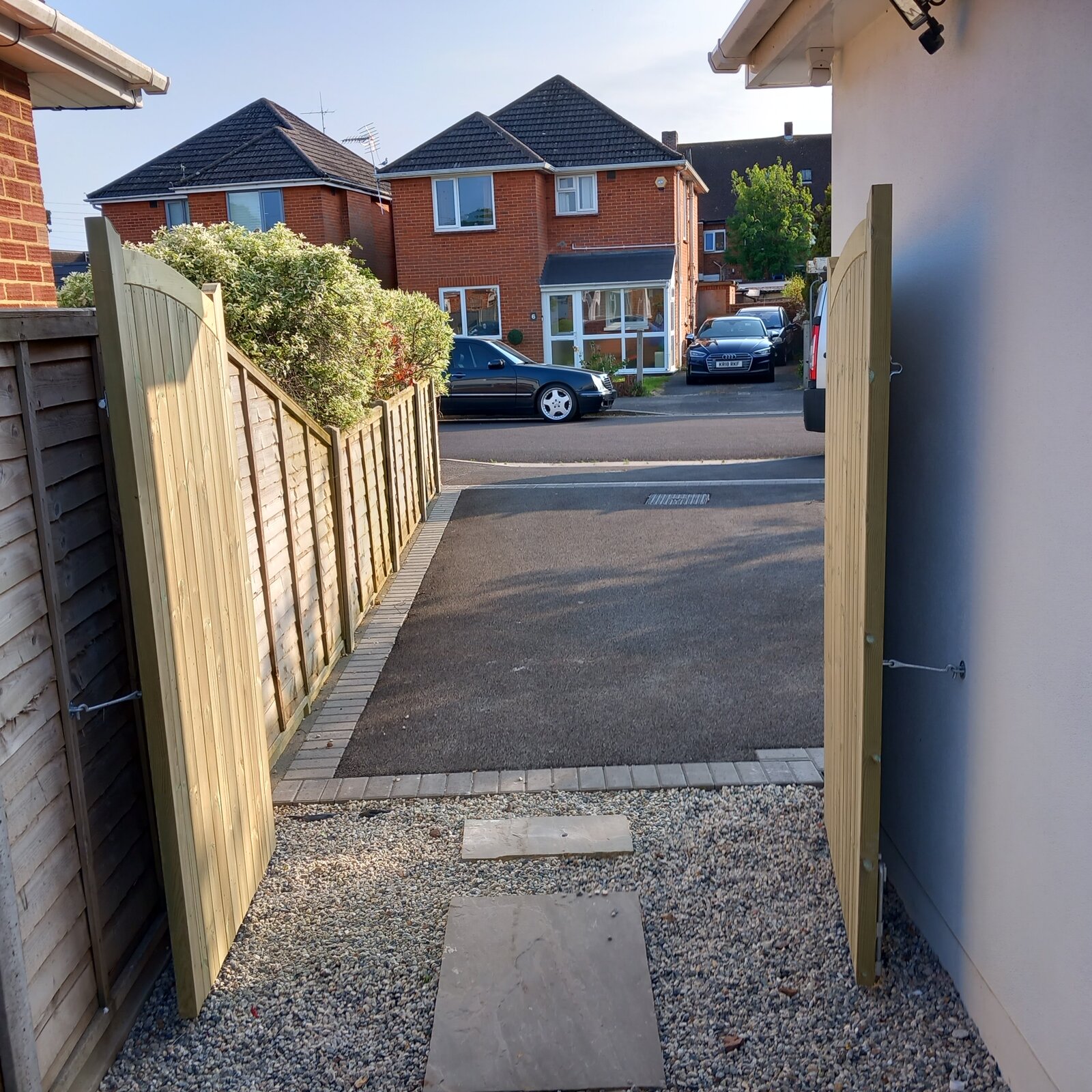

Hanging two gates.

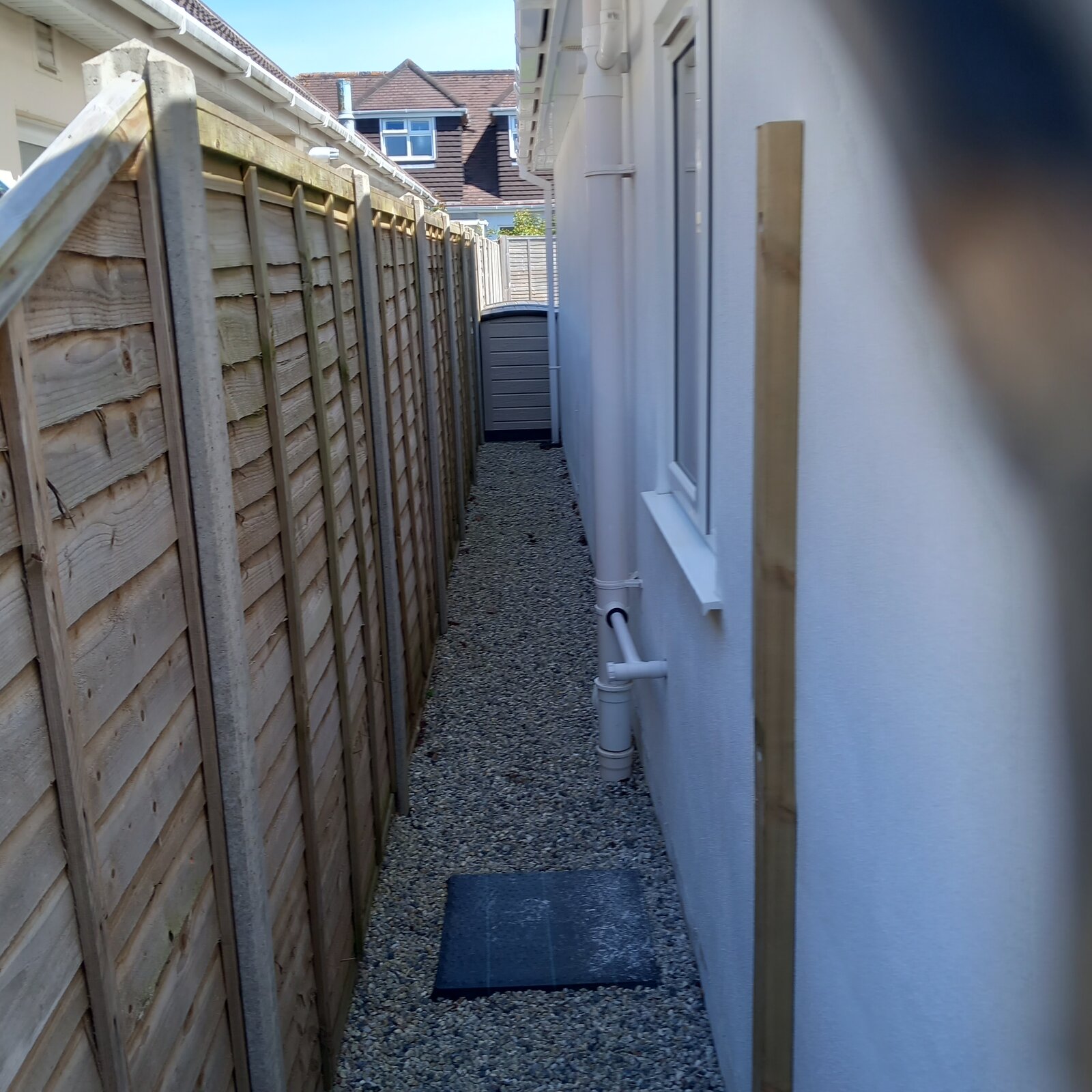

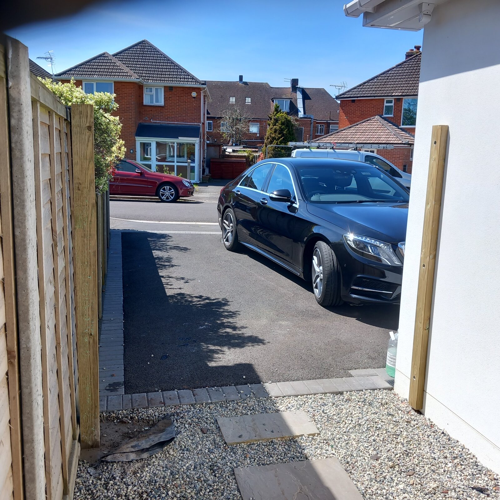

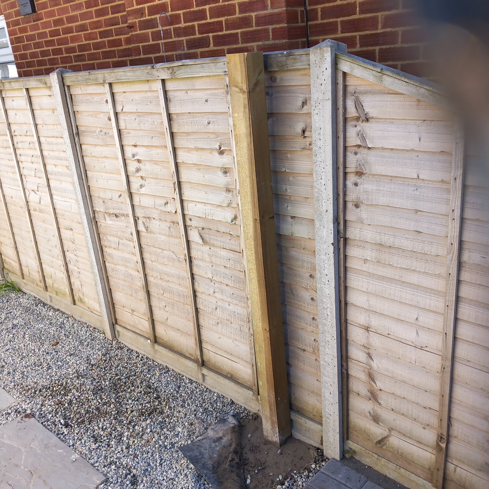

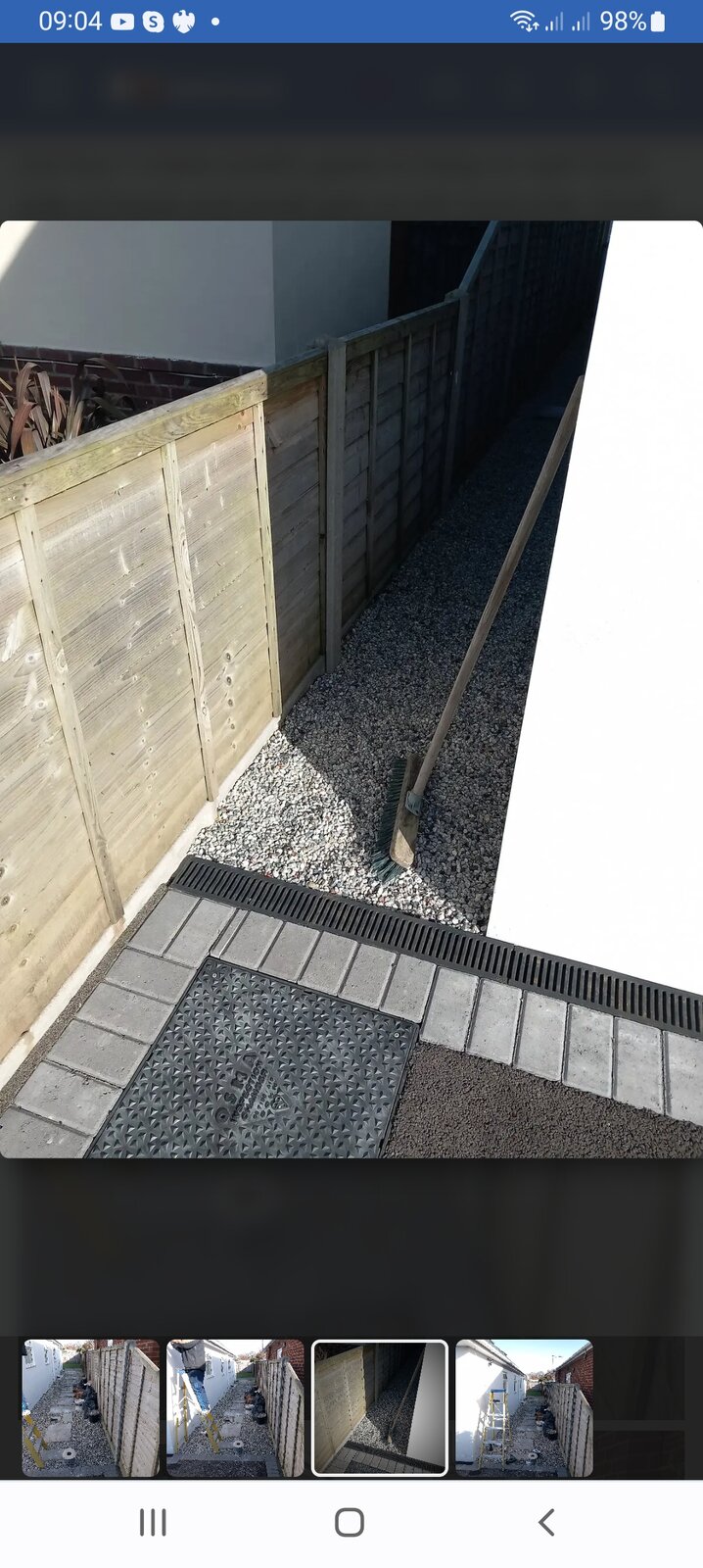

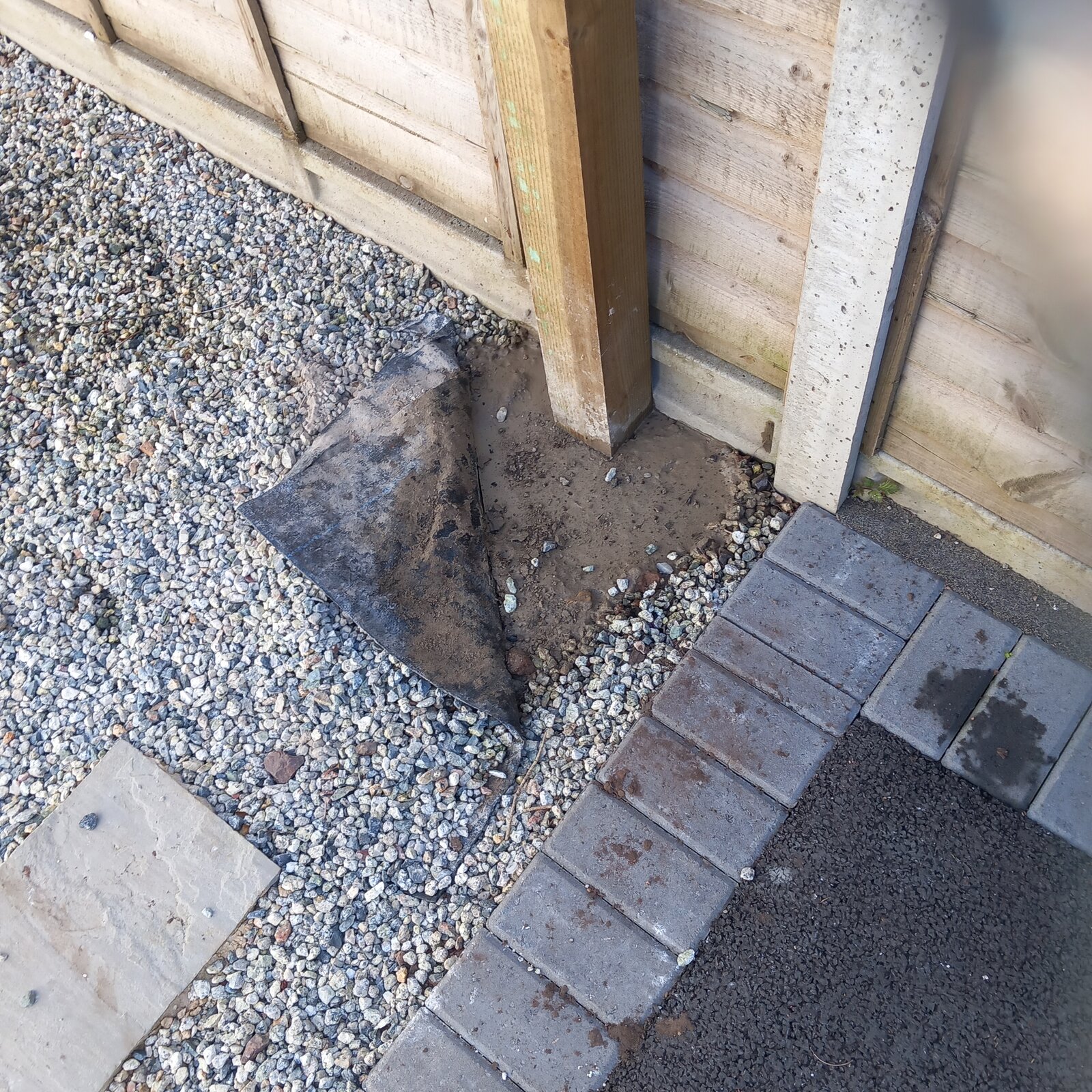

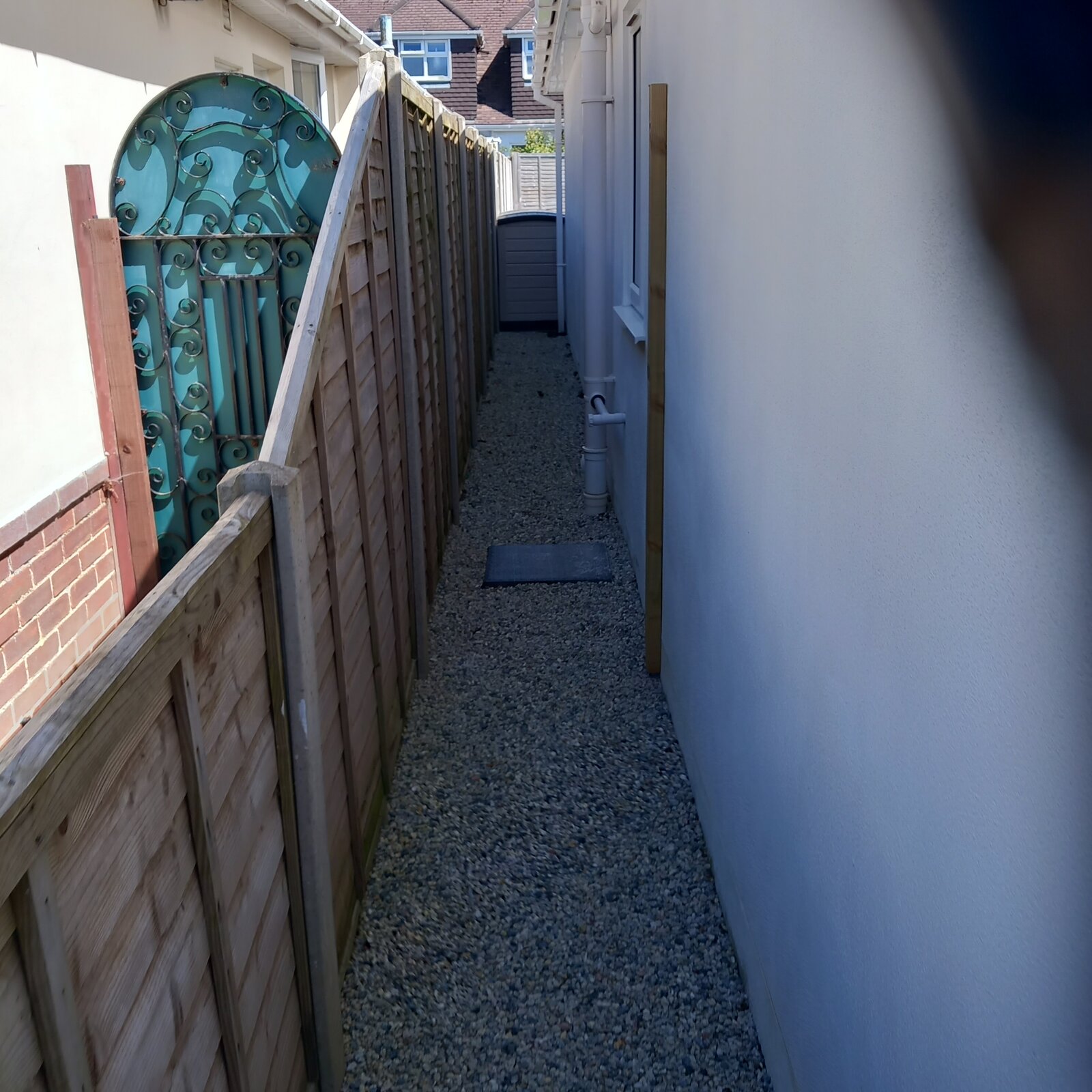

I didn't quite understand most of the query. I'd hang the gates wherever the client wants them; their house, their aesthetic. In this particular case I'd consider a post that wraps the corner to align with the concrete post you say you're fixing to on the other side (good luck!) and also mean you can mount the gate so it's on the line between block and gravel.. seeing a few inches of gravel on the block side of the gate would look a bit gash IMO
Do you remember the previous thread about fitting a narrow gate between a garage and a conservatory? I mentioned a point (that ultimately I think was passed over) about not significantly narrowing the gap the gate fitted in by fitting a large post onto which the gate is hung. If you have a space 30 inches wide, fitting a 3 inch post that then hangs a gate using a hook-on-plate style hinge you might find that 5 inches of the usable gap disappear, taken up by the gate post and hardware. In narrow gaps, strive to fit posts on a location that isn't in the gap, and fit the gate to the post using hinges that means no part of the gate hangs in the gap either

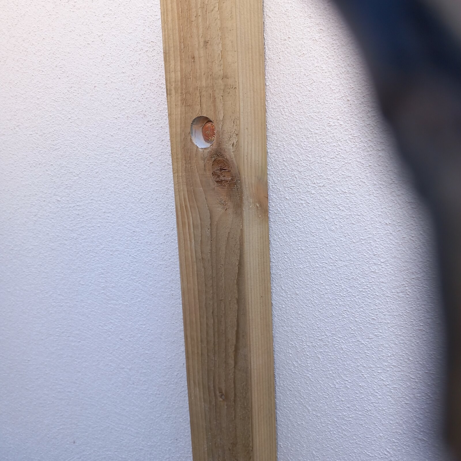

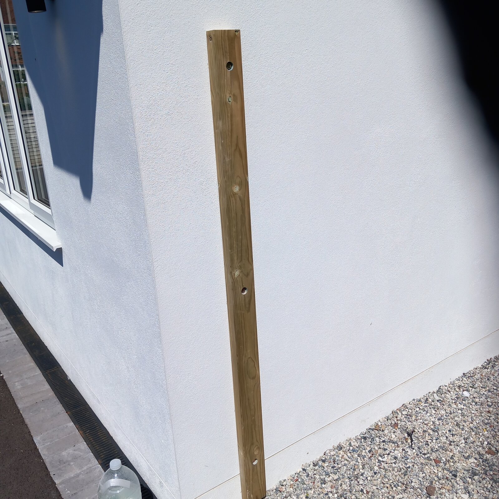

On the left side of house gotta put a little gate off wall. It will be off a 3 x 1 inch timber. I'll ask client if they want more space so it will then need to be hung on front facing side or if less space is needed then on side of wall.

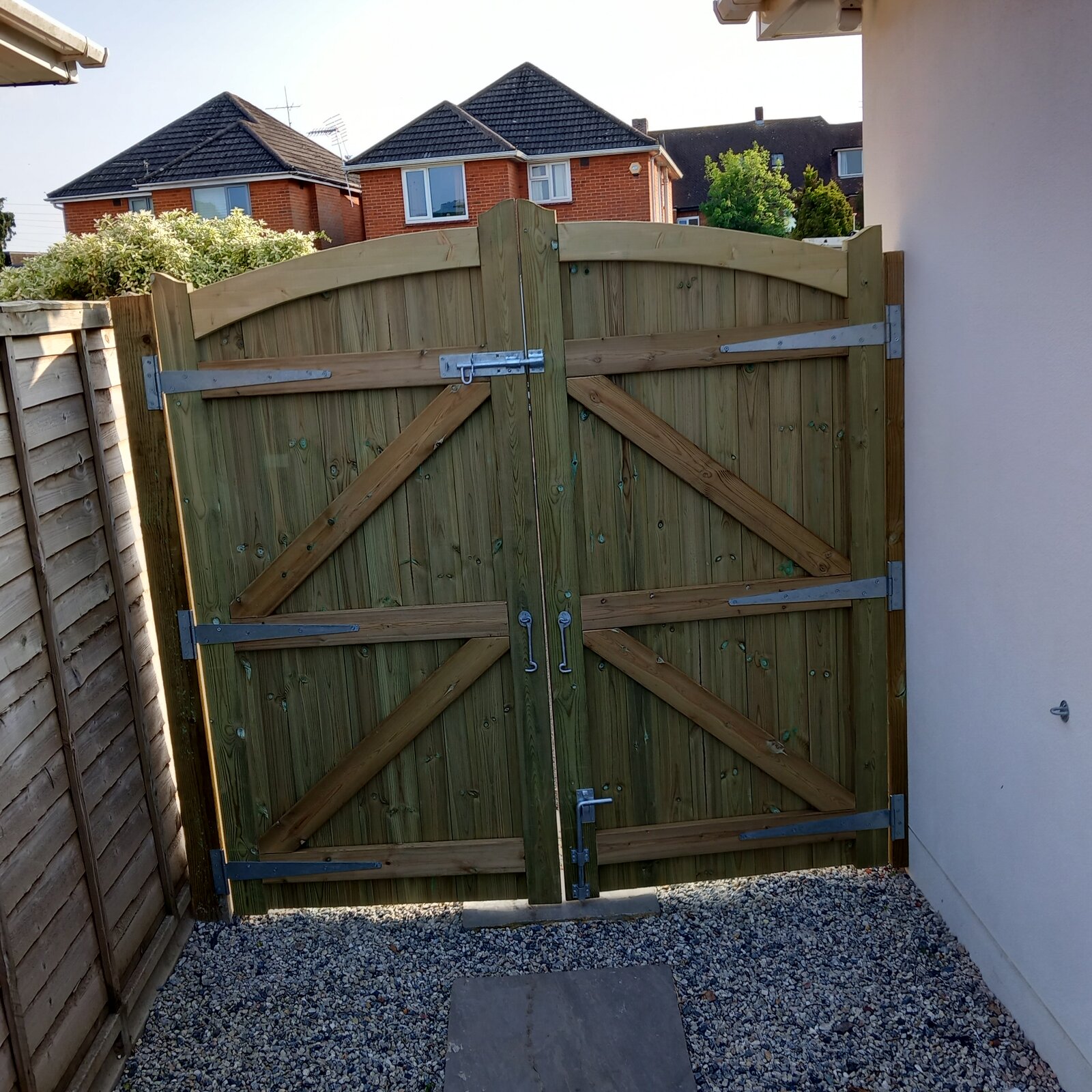

Put in post and 3 x 2 bolted to two walks. 4inch thunderbolts.

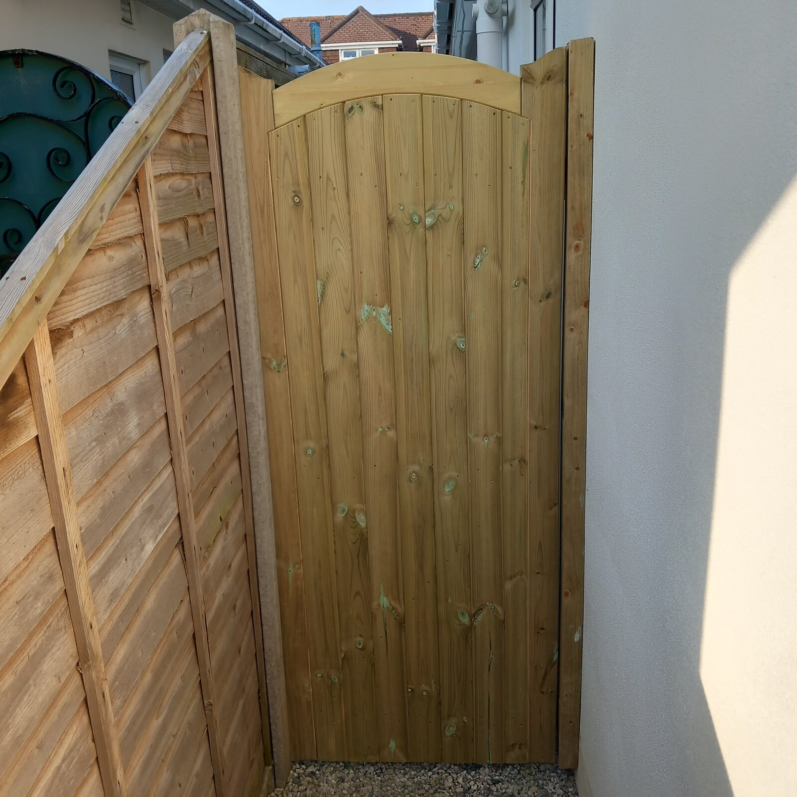

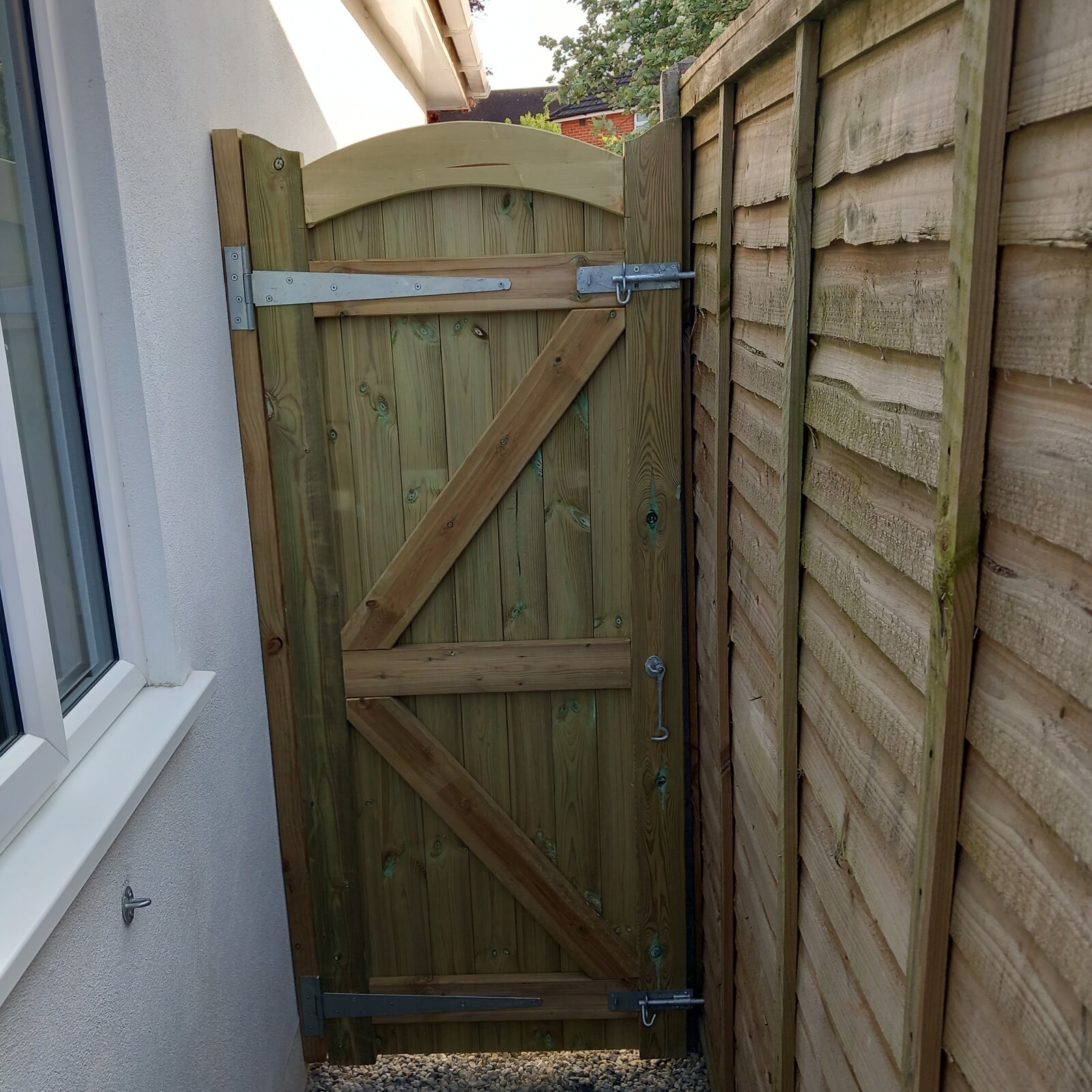

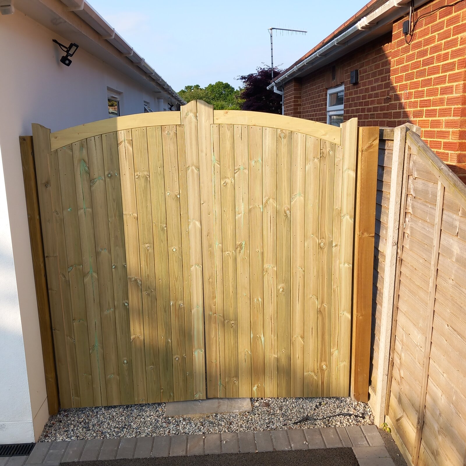

Gates have been made. Need to get the correct ironmongery to hang them and bolt into place.

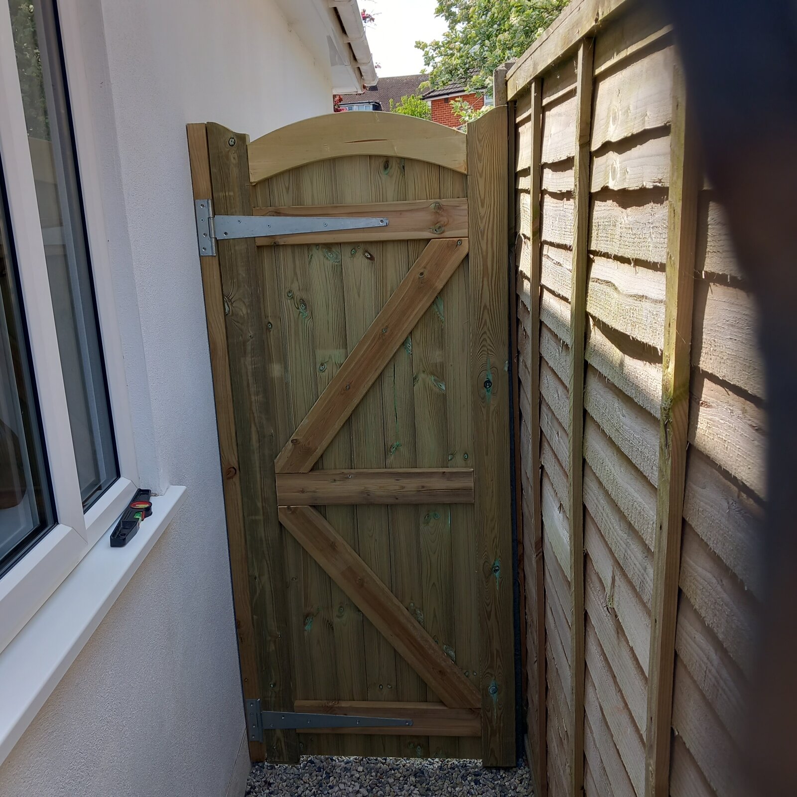

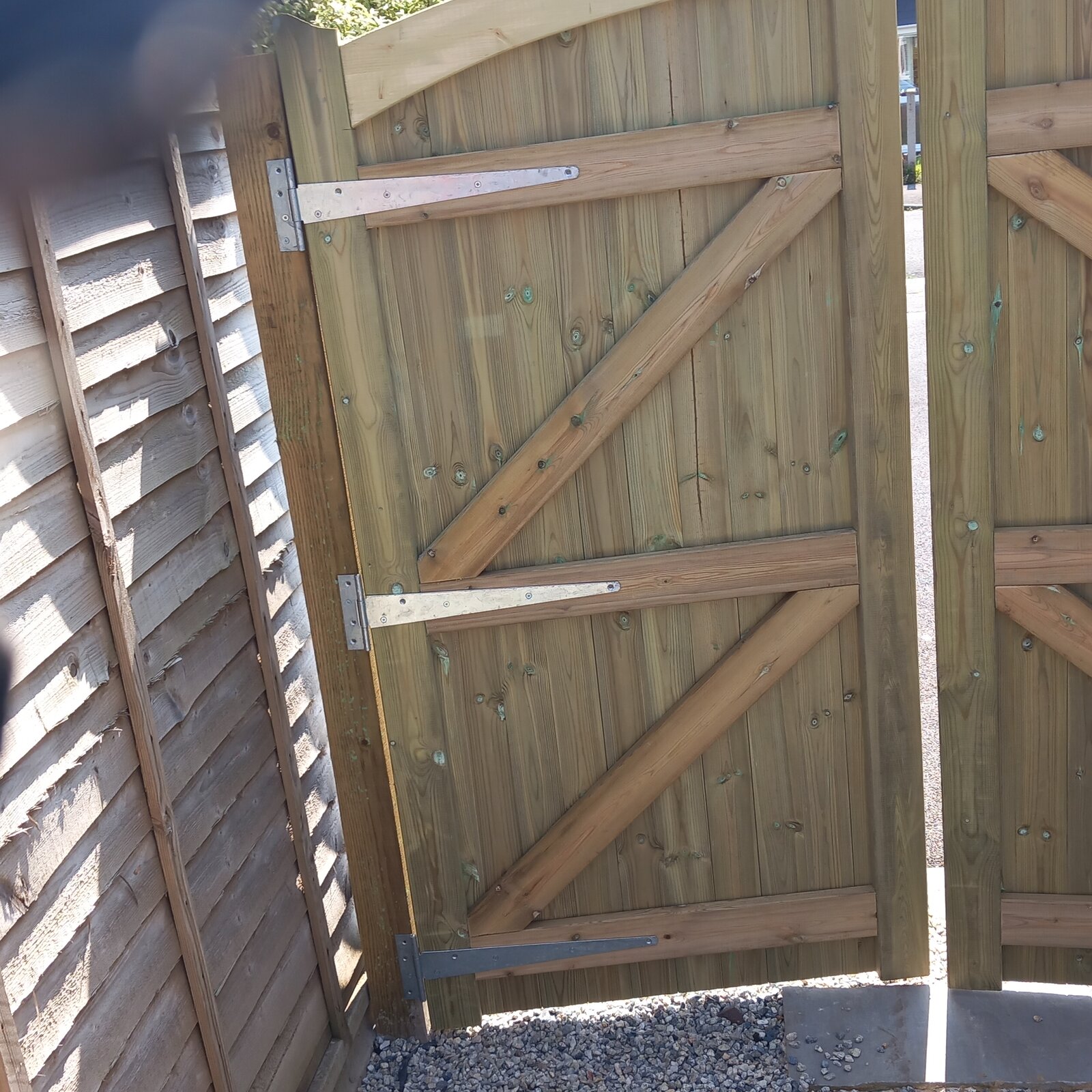

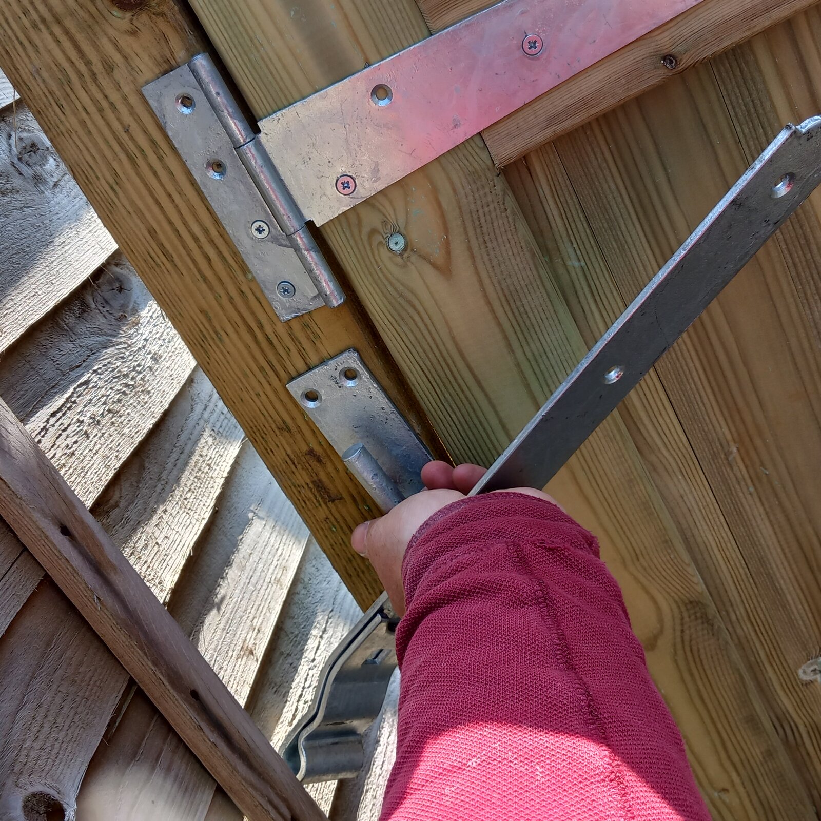

When the gate shuts, it's not level with hinge. Is this a problem? Shall I move the wall plate back? Also if hinges go on front they'll look unsightly so have to go on back
Hook and band hinges are very much better.
You can get cranked ones if you want. They move the gate forward relative to the hinge pin.
You can paint them (before fitting) to look better and for longer life.
They also look much better (tee hinges are very poor)
I greatly prefer three greased stainless washers on the hinge pin before adding the hinge, to prevent squeaking and wear
Woujd
I had some hook and band hinges but they wouldn't fit on front because gates were too wide to accommodate them and worried wall plate wasn't thick enough to accommodate them on the sides. Can you put them on the sides of post and wall plates in place of where I put t hinges anyhow?

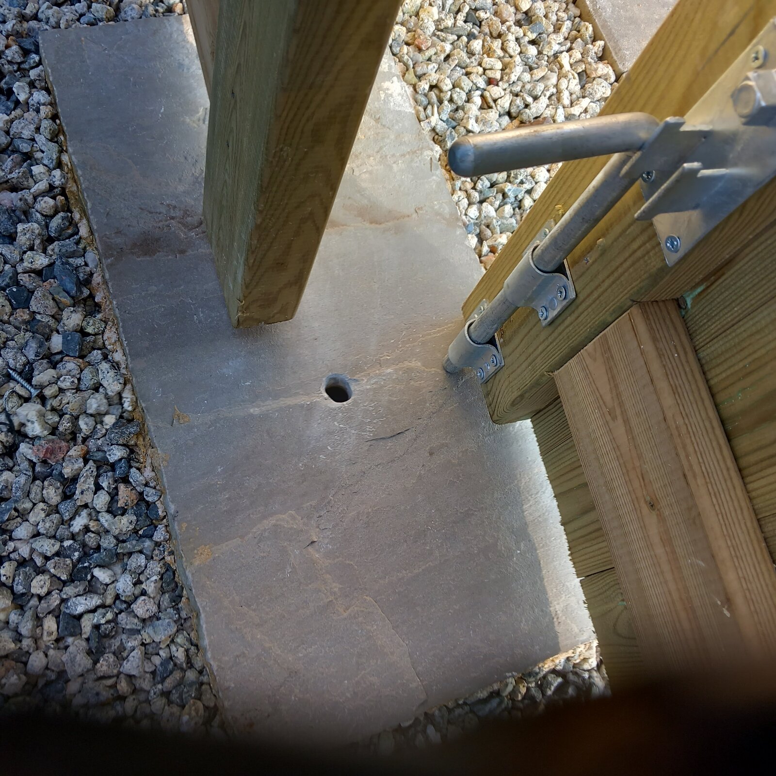

The bolt should be lined up with the receiver [hope that's the term] above it so it's guided by it [and stops it from being pulled out completely] rather than just coincidentally next to it. It's probably not a massive deal.
