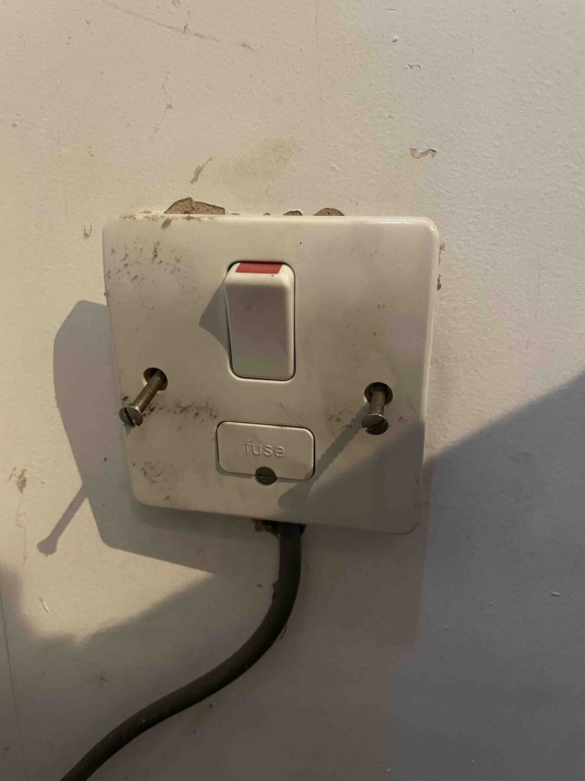

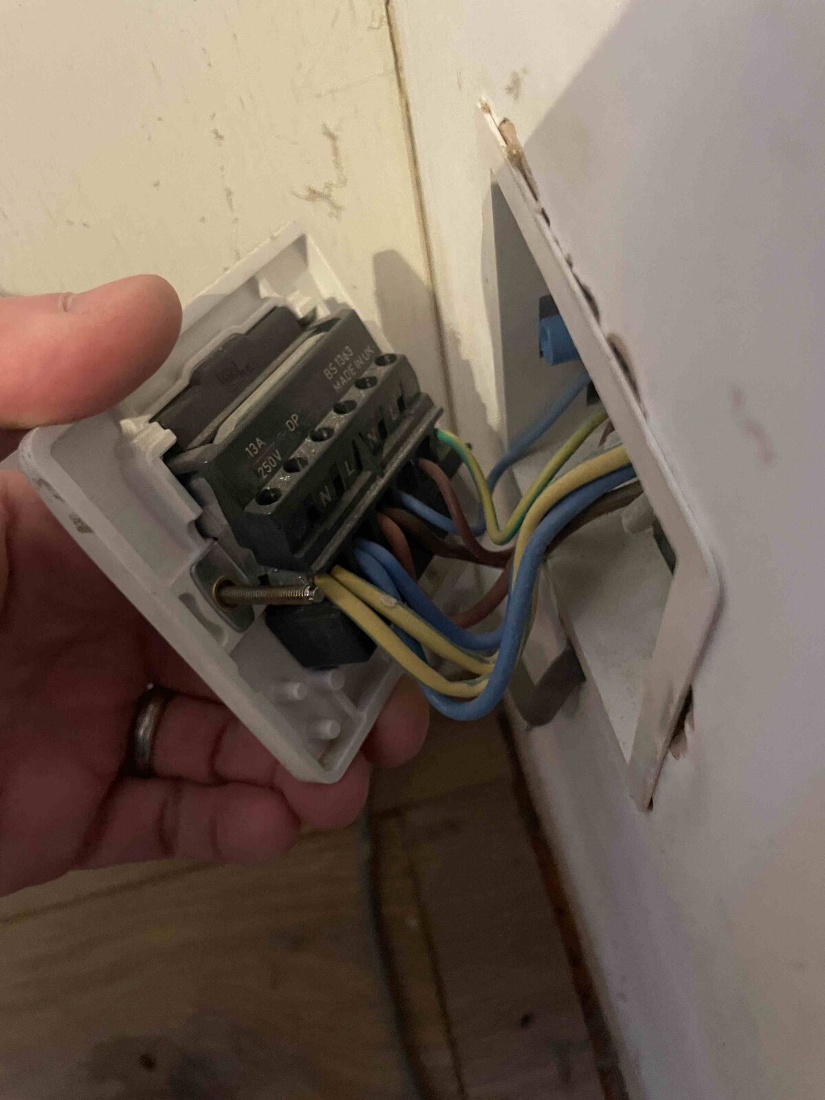

Our Fridge Freezer has died and was hardwired into an FCU, which is on the circuit of kitchen sockets. I don't want to cut the plug off the new Fridge, so want to replace with a single socket.
I've got a spare double pole socket - is this as simple as replacing the pairs of wires in each terminal into the back of the single socket? Or do I need to get a Pro in?
Thanks!
Yes it's that simple....
But will the new fridge go back properly with the plug depth, assuming it's directly behind?
Well they reckon there should be a 50mm air gap at the back, so I'm not sure the hardwire option was technically right anyway!
In mother's old house, the FCU supplied the socket for the fridge/freezer, and was where the fridge/freezer would not stop access to, and was put there so it could be switched off to defrost it without needing to pull the unit out. The use of a FCU is also so less likely someone will unplug it to use the socket for something else, but all down to physical reasons, of not being a temptation to unplug, there is no electrical reason to use a switched FCU, and there are arguments that a FCU stops the easy moving of the unit for maintenance.
