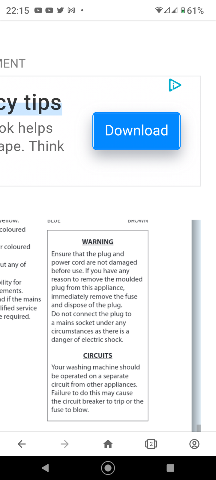

Don't believe the guff about not chopping off the plug.
This is a typical instruction manual.
