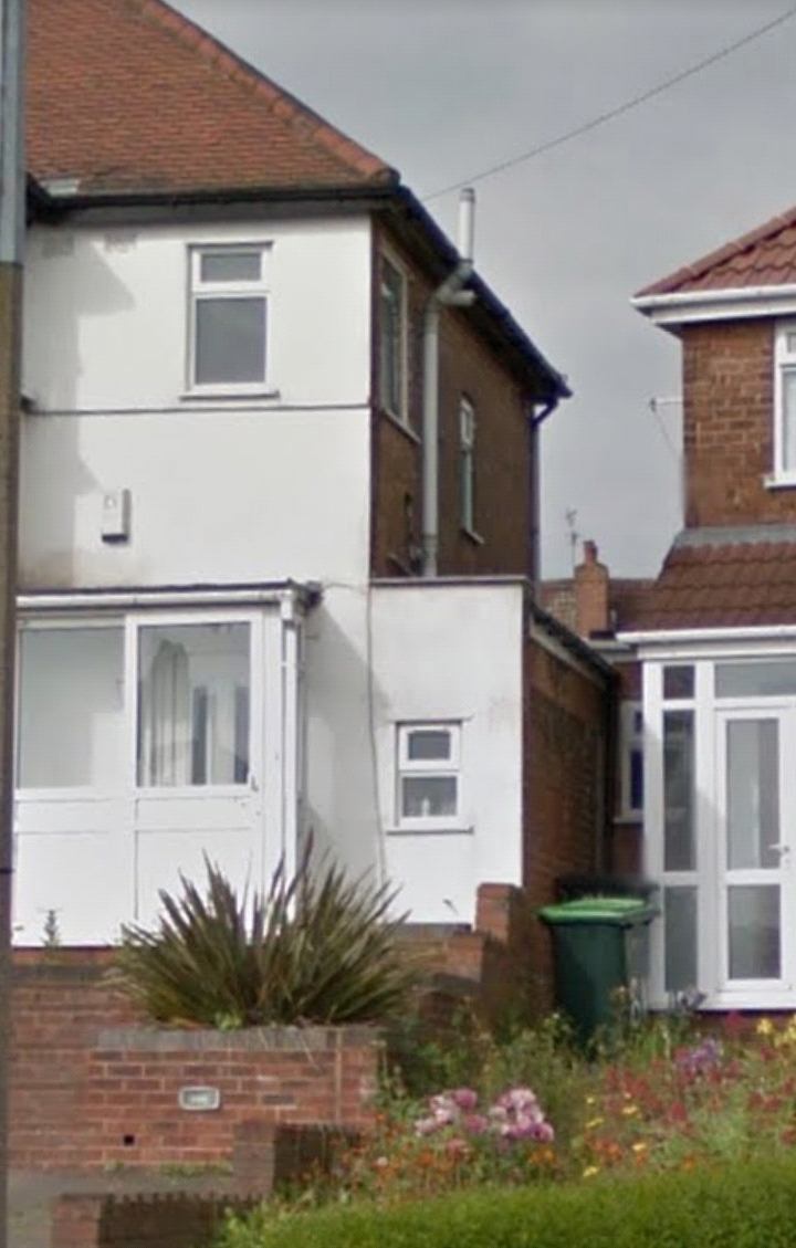

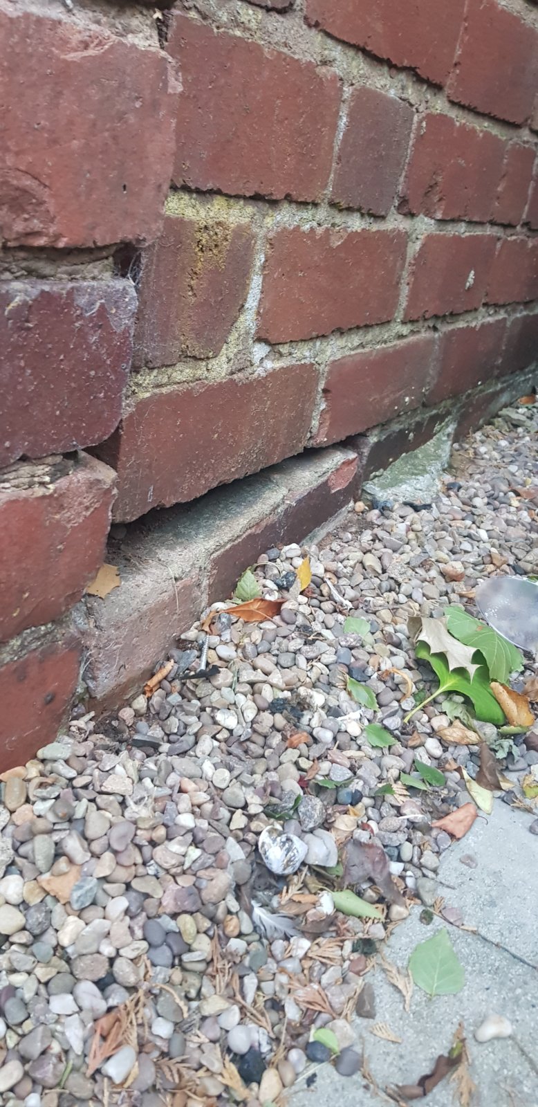

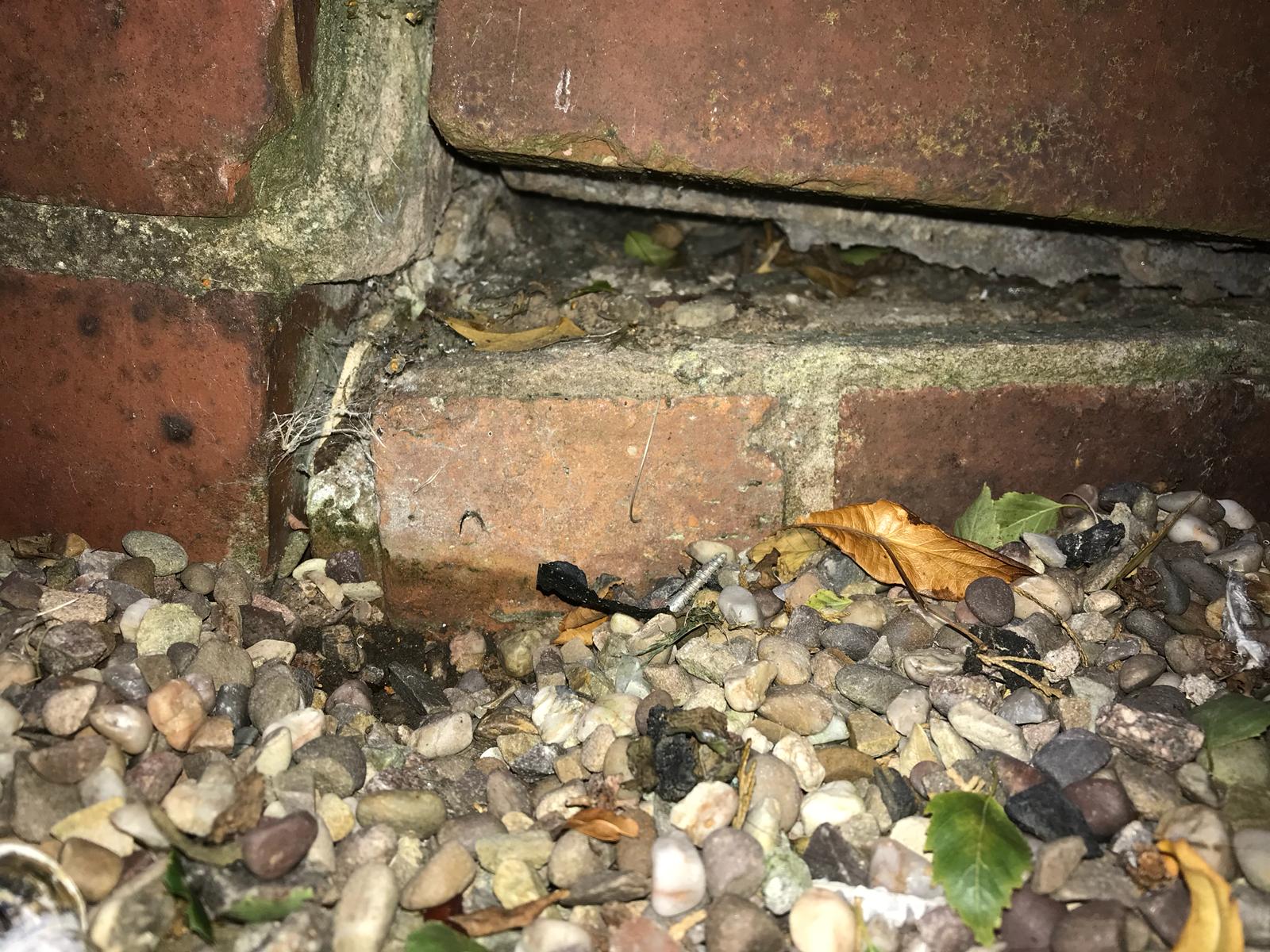

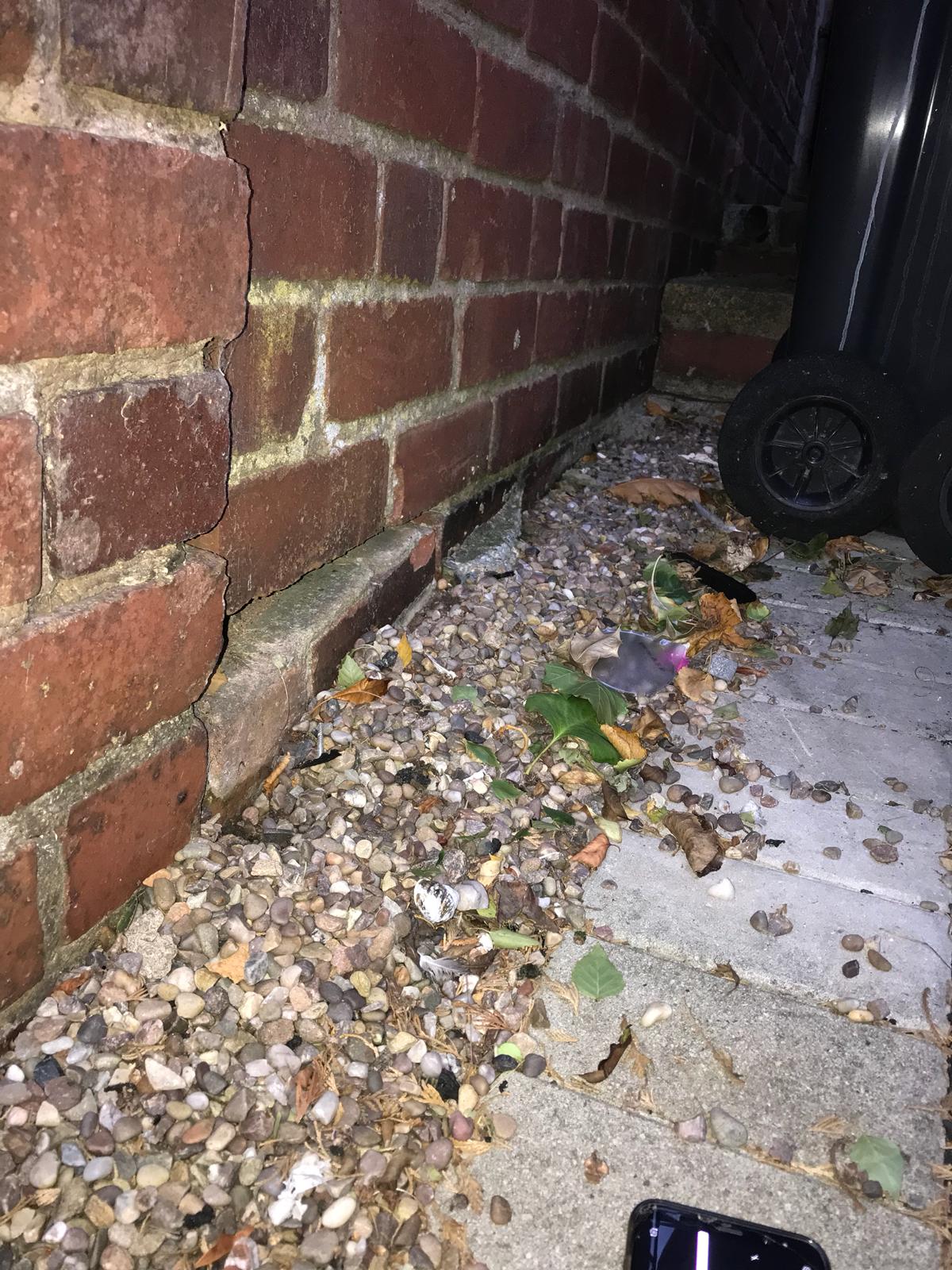

So i had the Homebuyers survey carried out today and it has picked up that the front right hand side corner of the house has maybe sank?
I have attached photos as they speak 1000 words... Is it bad? Should i pull out of the sale? Will it cause future problems? The house is 1930's if that helps.
The part effected is below the side veranda/extension
Thank you in advance everyone!

Do you mean the founds on the little extension have moved?
Probably not a big deal. It prob hasnt been built properly, maybe hardly any footing on made up ground, but that doesnt mean the house has an issue.
I'm with Notch. The way that house is perched up on that bank indicates that the foundations for the extension would likely need to be pretty deep in order to hit solid ground, as is often the case where homes are built upon banks or hillsides.
Most likely inadequate depth footings beneath the veranda.
We had to go down nearly 6 feet on our current job - a location very similar to your own.
I would also think inadequate footings.
