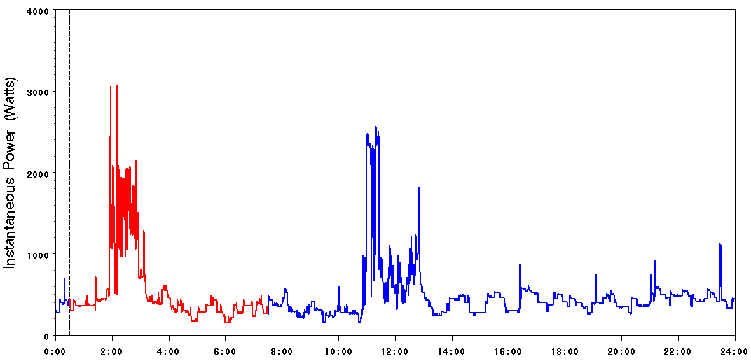

There will obviously be consdierable variation between houses/households but, for what it's worth ...
... although my house is large, I don't think it's appreciably different in terms of 'electrical loads' from any 'average house'. The below graph shows one fairly typical day in mid-Summer last year for the phase which covers the standard 'living areas' (ground floor) and, as you can see, the total demand was hardly ever significantly less than 300 W. [I presume that the nocturnal burst of usage was probably a dryer (rare in Summer) and the one around midday probably a washing machine or dishwasher]. I presume that most of my 'baseline load' (most often 300-500 W) is accounted for by a couple of fridges and a couple of freezers - things which obviously would be 'running' even when the house is unoccupied.
As above, I would suspect that that 300-500 W was probably at least as much as one could, in the real world, really expect to be getting for significant periods of time from an "800 W" panel.

Similar to my baseline then, and for similar reasons - as I said, I have two fridges and two freezers on that phase.
