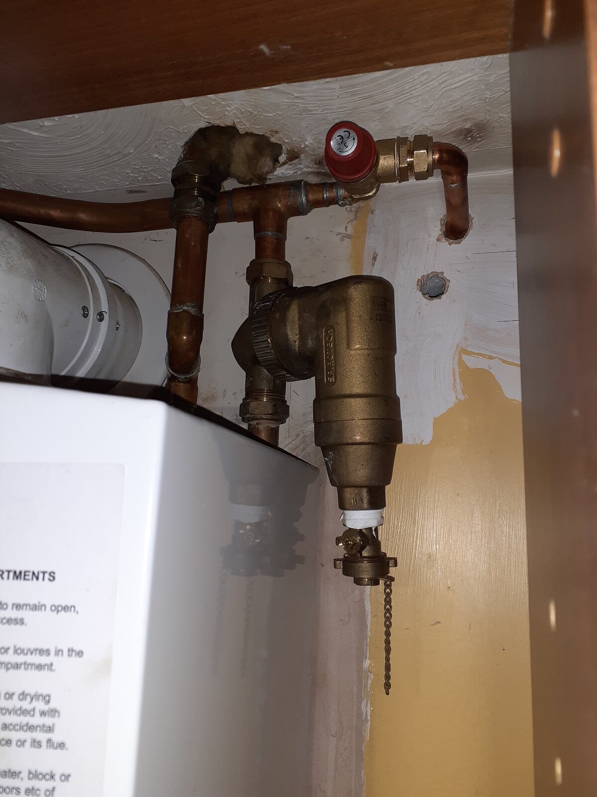

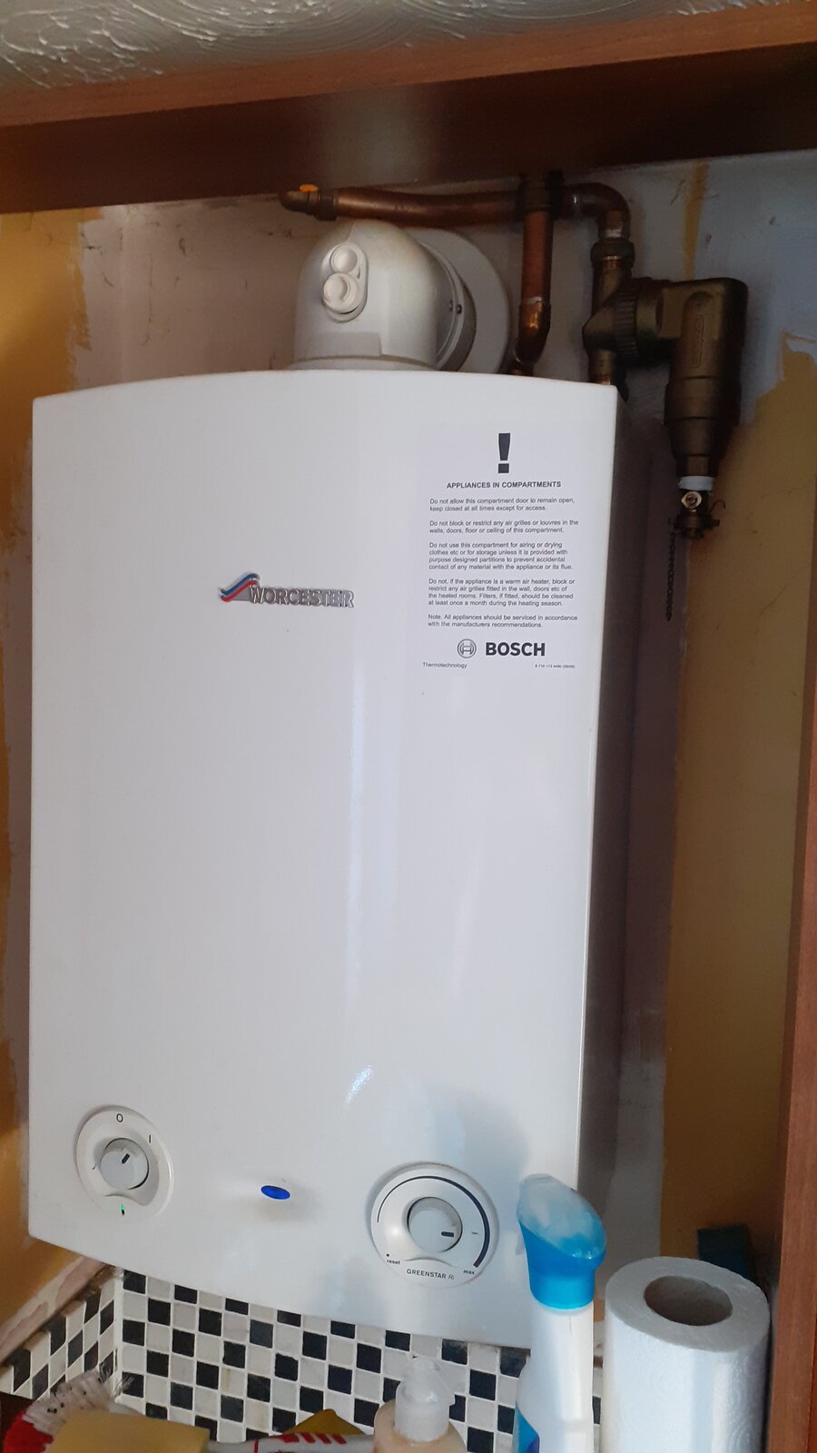

The boiler wasn't changed, and upon reflection and by comparing previous photos of the side of the house - you are correct that the initial photo showing the pipe into the downpipe was indeed there previously, but it's certainly useful to learn of the risks in its current state. That said, it would still appear we've been needlessly led down the route of having the system sealed prior to a power flush of a microbore system, and I would be curious to learn if anybody has a verdict on whether the PRV pipework added in the boiler is of sufficient standard in terms of workmanship, and what the reason is for the second hole seemingly having appeared in the wall a couple of inches beneath where the PRV exits?

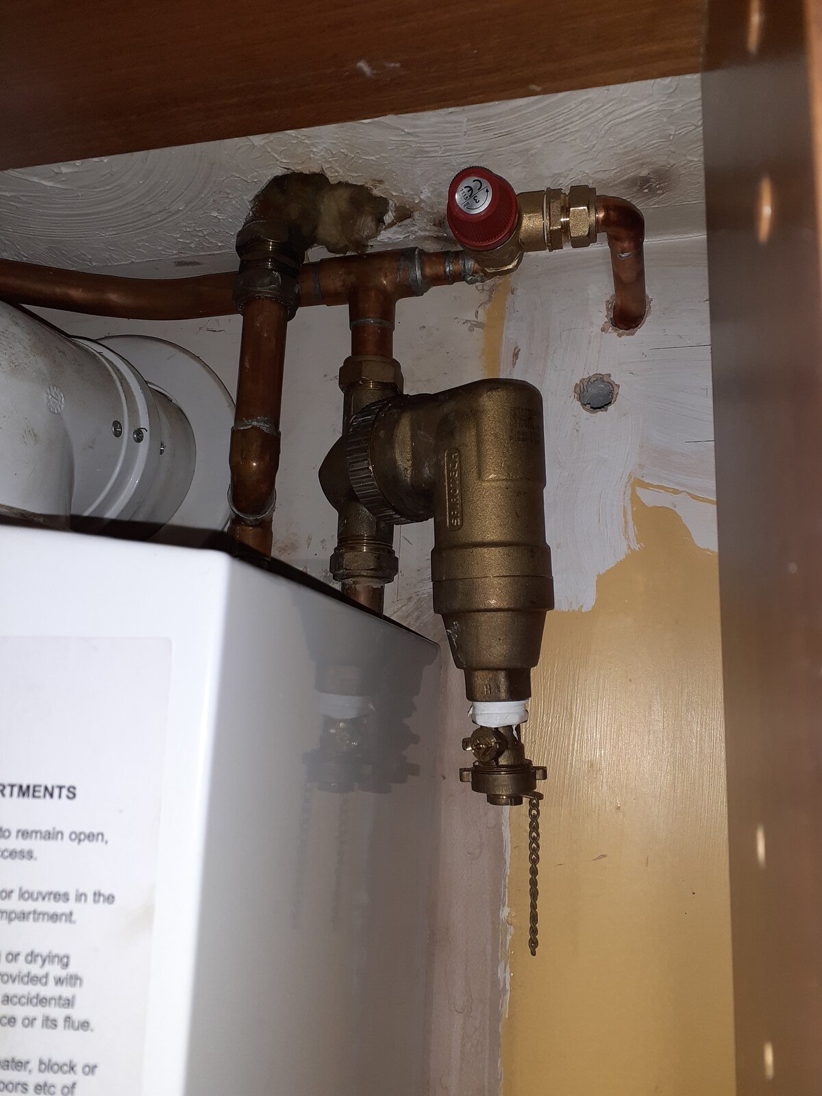

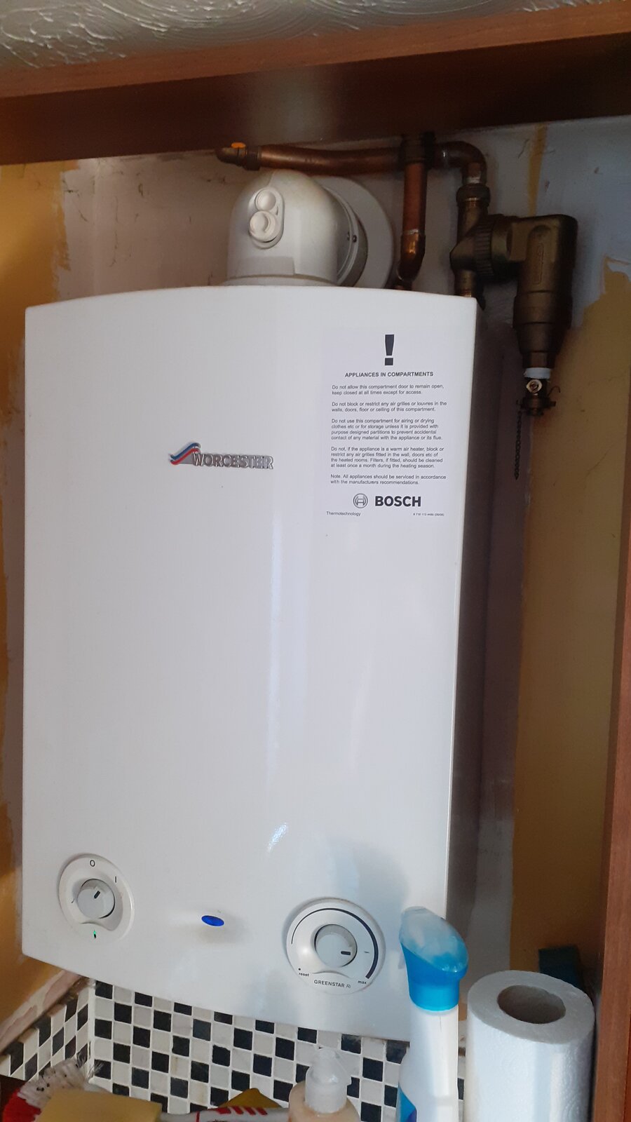

OK thanks. For the 2nd hole, my guess is the installer had a PRV outlet pipe layout in mind, but then changed his mind. You could put some filler in the hole.
I'd expect the PRV outlet pipe to emerge from the outside wall, but can't see it in any of the photos. Perhaps it's out of shot.
As above, the installer drilled the wall in anticipation of where it was needed, then found the pipe layout wouldn't work. He seems to have not bothered sealing around the actual hole he did use though, despite have used sealant to fill the unused hole.
