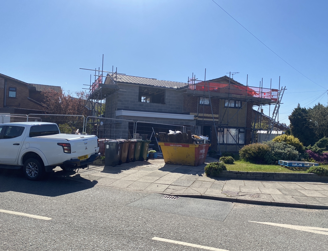

Haunching my chimney - plan of attack ok?

My original question was about re-doing my haunching. Only when I've had my scaffold up could I look at the chimney up close and understand the state of it. You have to book the renderers well in advance for a summer job, and scaffolding is time limited, so stuck between a rock and a hard place.
In terms of removing chimney, other options, etc why would I have explored them before? The chimney has always had the flue in it and I had no intention of replacing the whole stack. I never knew it was an option previously, and quite frankly I'm always of the opinion if it ain't broke, don't fix it. Not really a lack of planning is it?
Sorry, I didn't intend to rile you. I made my comment on the possibility that the option could still be explored.
I would have considered removing the whole stack to below roof level and roof right over it, if I was aware that it needed some work, it only served the gas flue, and there was some roof work required anyway.
If I was in your place I would still explore that option anyway.
IMO, it's the better long term solution and opens up other future possibilities.
It will depend on what draw the flue gets. Too low and there may be no draw or a down draught, and then you end up messing about with different pots or terminals
True! you will need a gas man to advise/test
