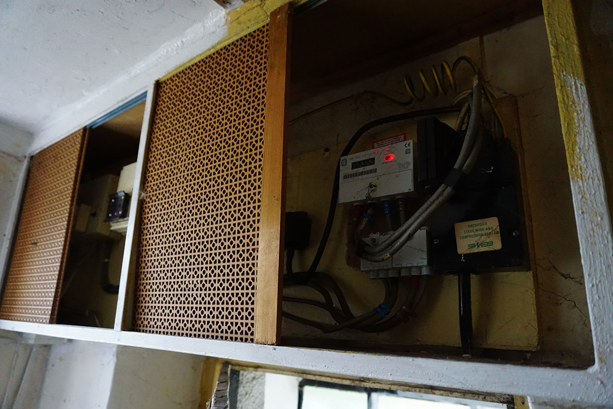

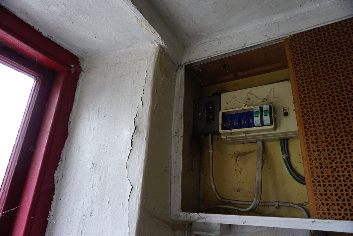

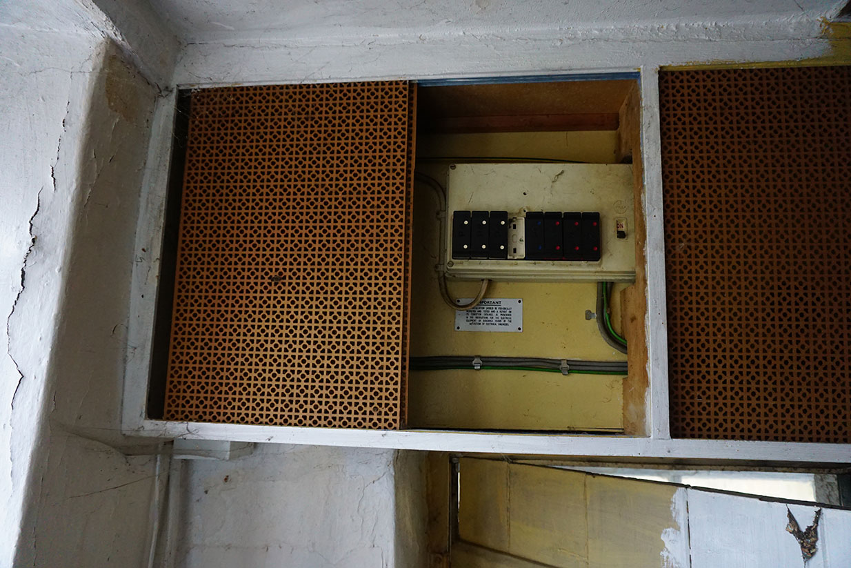

Below are photos of the CU. Im not sure whats being used and whats not! From the looks of this, does it look ancient/dangerous?
Looks like it was fairly neat, the main problem is IP rating, those missing fuses and covers allow access to live parts.i wouldn't say dangerous based on what I see though, but it's impossible to tell for sure.
I think an eicr is the best idea to know how good everything is actually in terms of functionality, but I would recommend a new cu regardless as those have been butchered up pretty well on the fuse cover
