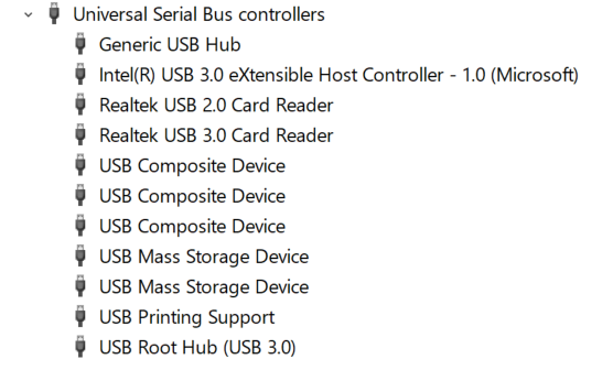

It says this, which I don't understand particularly...:

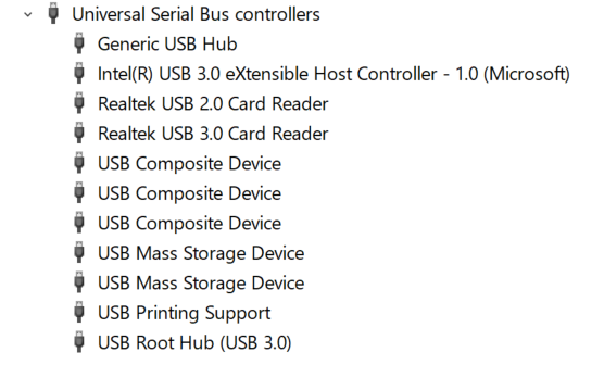

It's not meant to be understood, if that happened how would Desktop engineers make a living?
The throughput rates are useful but a bit misleading at the same time. USB was primarily designed for small chunks of data, not for huge continuous streams. That means it performs a bit worse in practice than you'd think.
Your typical HDD around 8TB can probably manage up to 200MB/s read/write sustained. Some are slower, not many are faster. That is a cap to your transfer speed, nothing can make it faster.
USB2 is too slow, USB3 is fine, the rest might show a slight performance boost because they're better storage protocols, but probably not worth the effort. 3.1 and 3.2 are even faster but your disk will limit you well before then.
Things get complicated and difficult when you're trying to maximize speed. Good luck.

Theres some headers on the motherboard to provide front USB ports, but it sounds like you're already using them. Half your front connectors will be on USB 2 by the way, unless you've got a PCIE card supplying them already rather than the built in motherboard, that could be why one of your card readers is sluggish.
USB 3.2 is fully backward compatible to 3.0. If you're using high end SD cards you can get up to 300MB/s off them (they're just tiny SSDs), which is just at the point where 3.1 or 3.2 might conceivably give some benefit to your card reader. But anything less than top of the range wouldnt be able to see any difference between 3.0 and 3.2.
