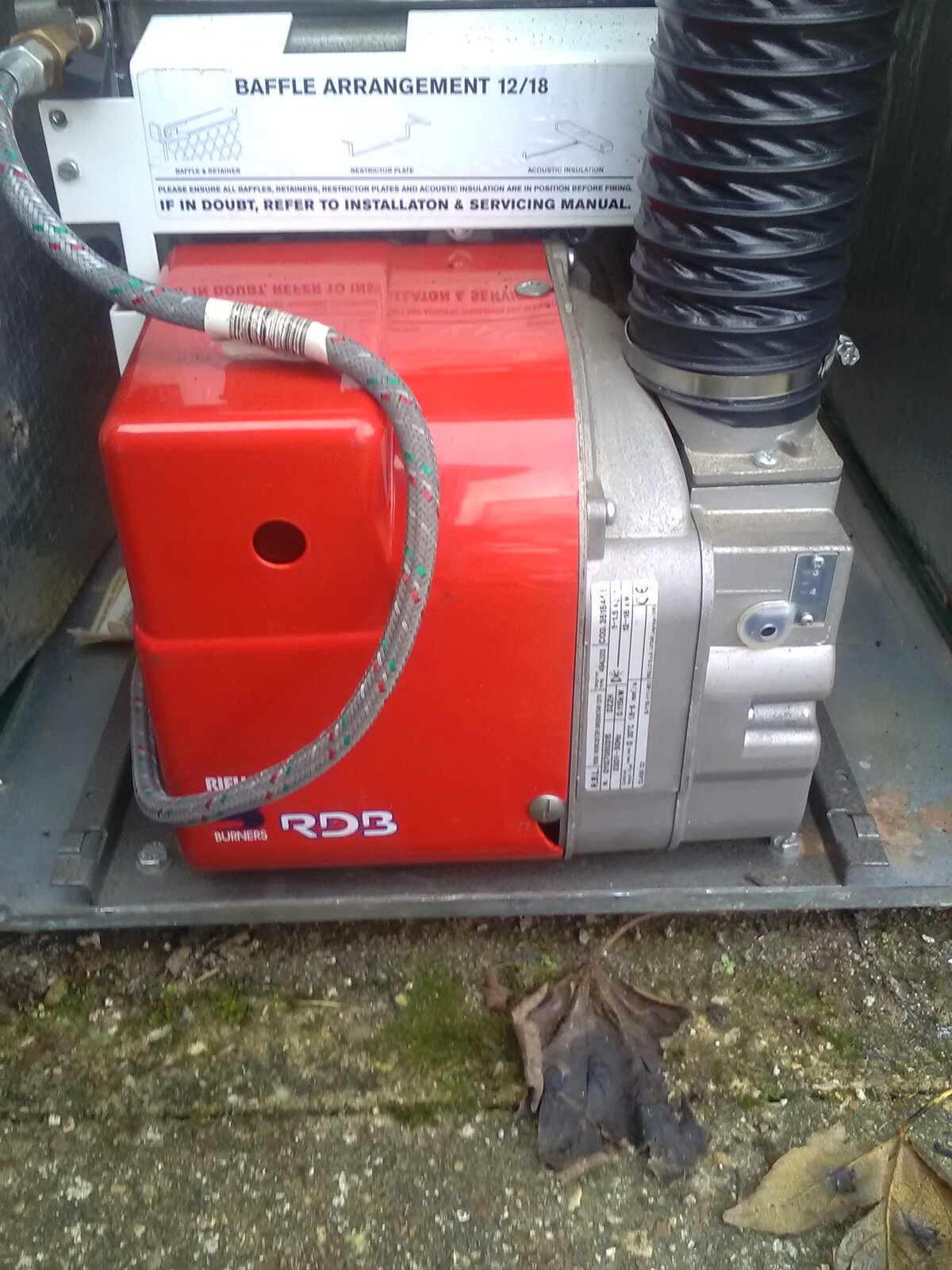

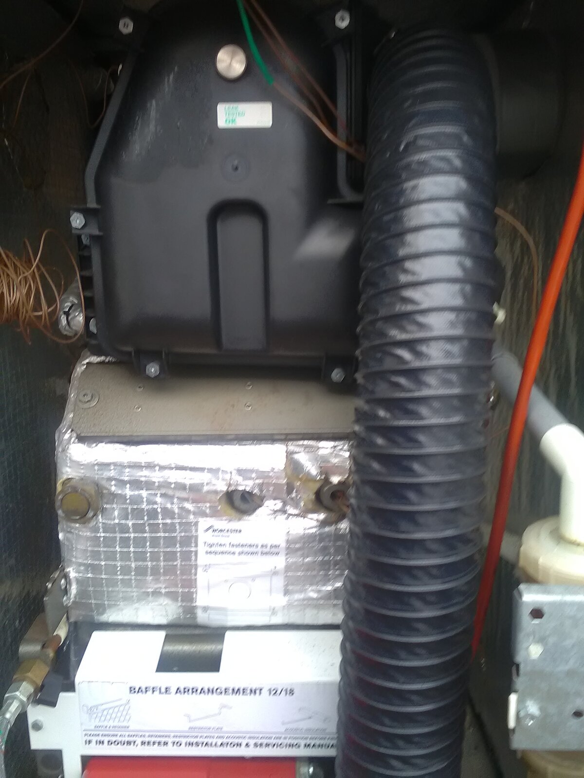

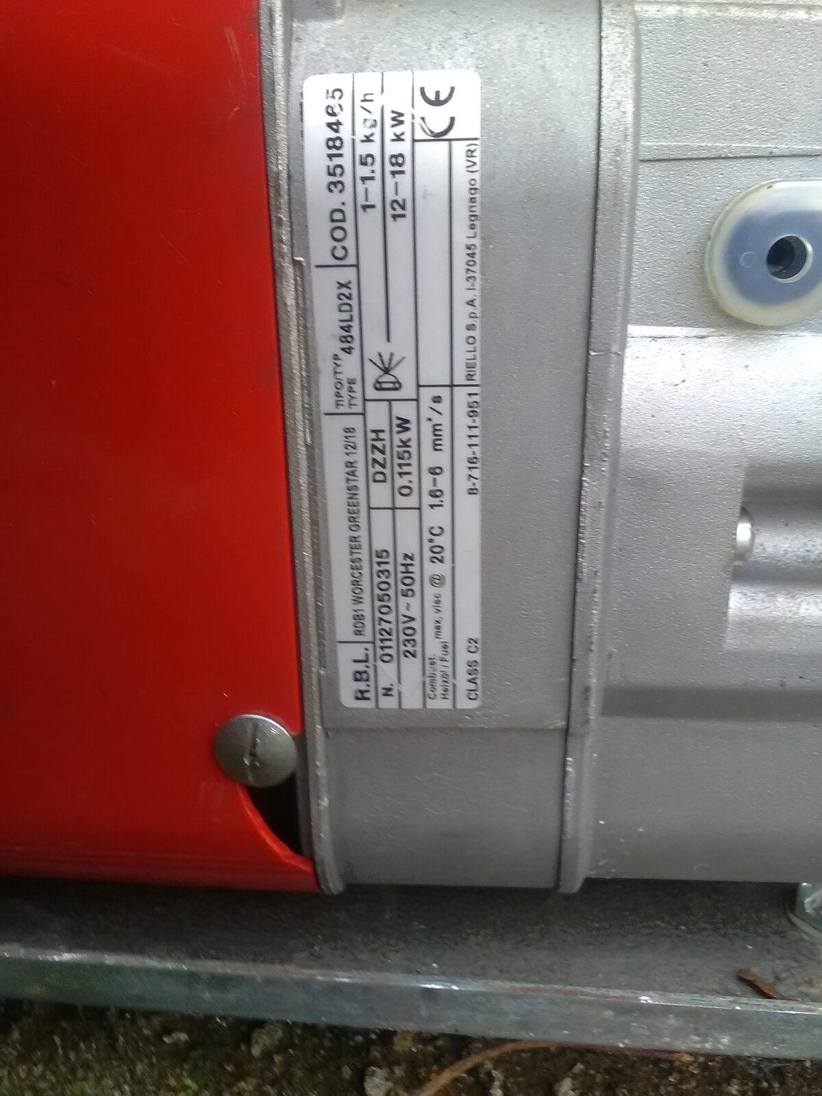

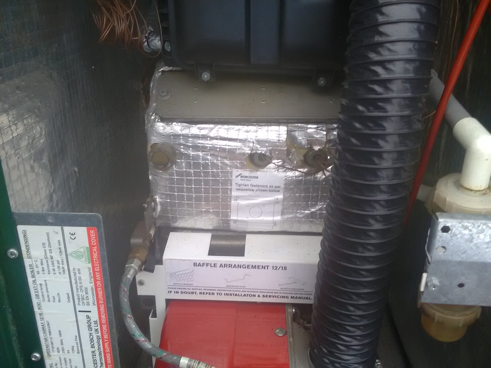

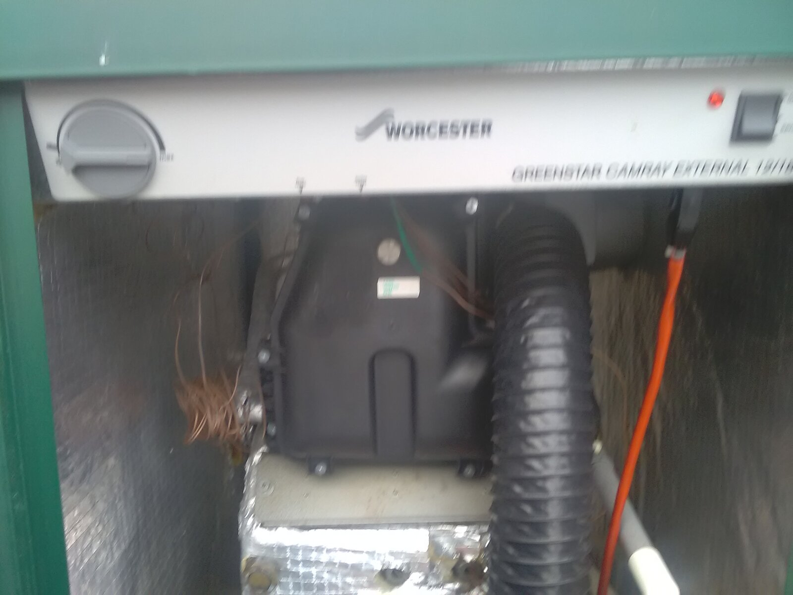

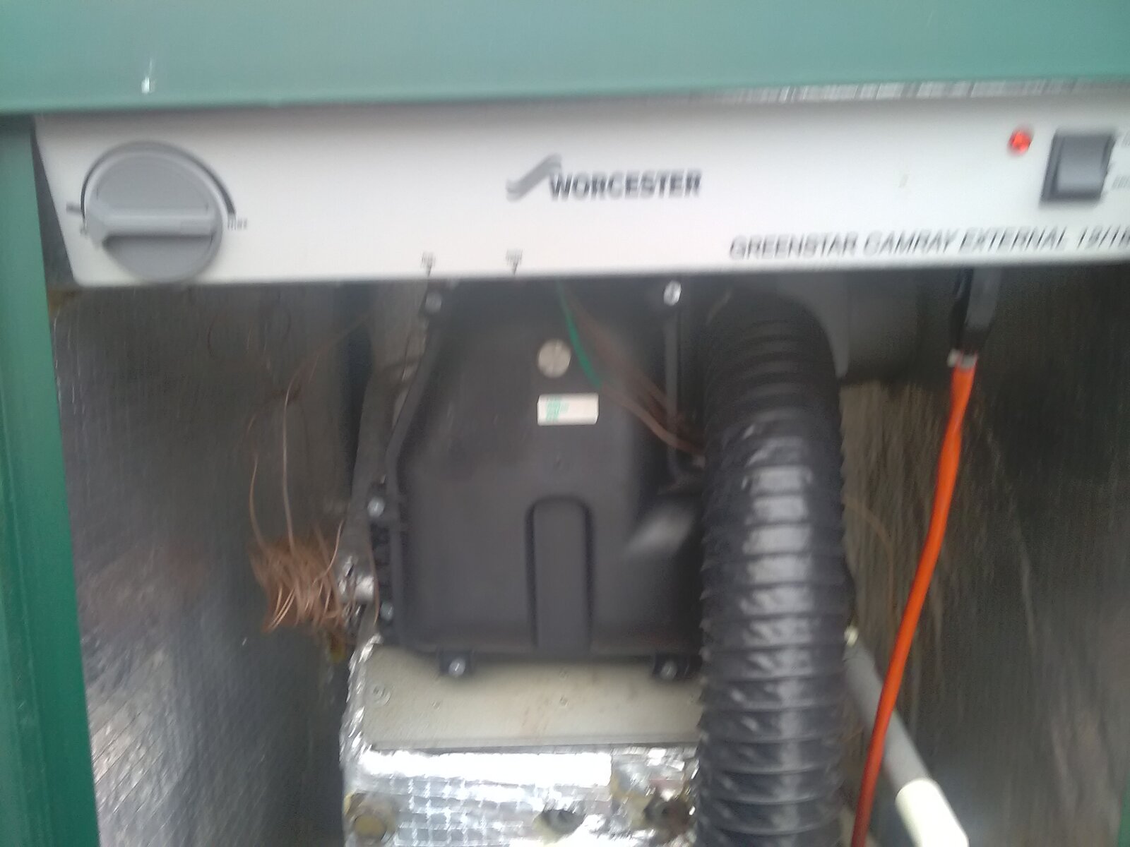

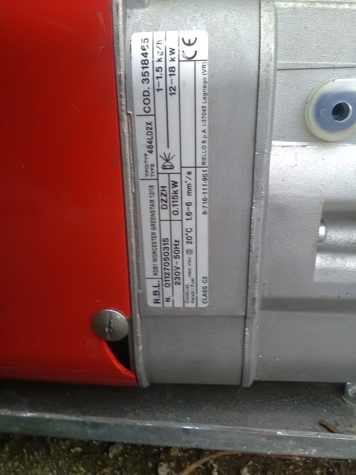

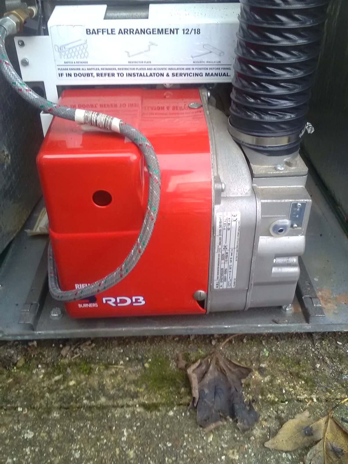

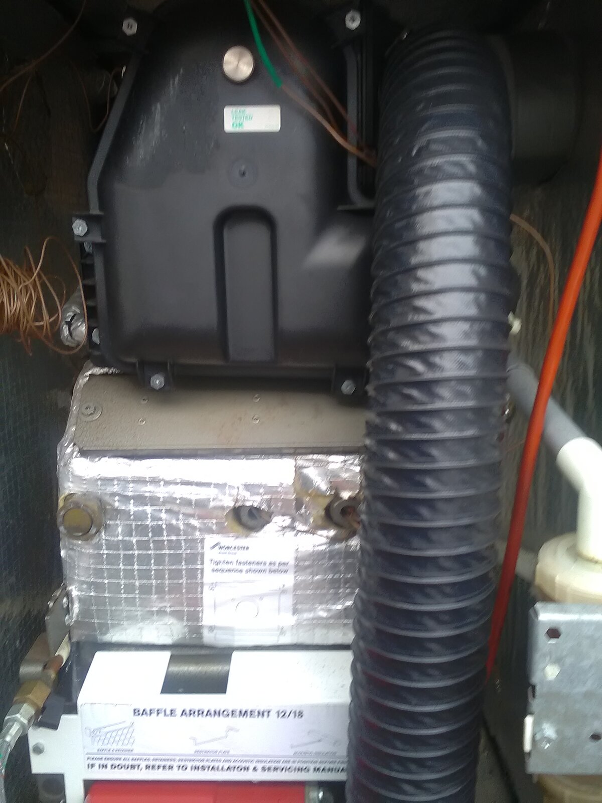

Heres a few photos
When i left the boiler last night the boiler demand light was lit and the burner reset light was lit. No pressing the burner reset it would not fire up.
This morning the demand light was lit but the burner reset light was not lit. But the boiler was not running, I pressed the burner reset and the boiler fires up and runs.
