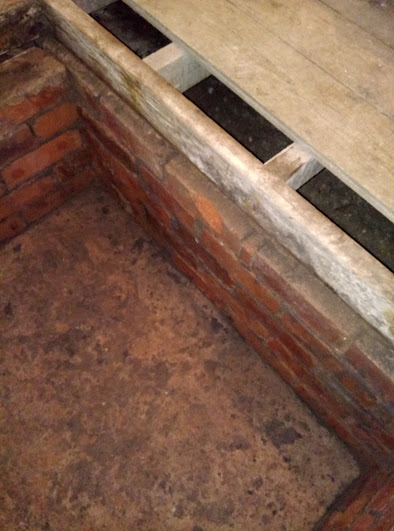

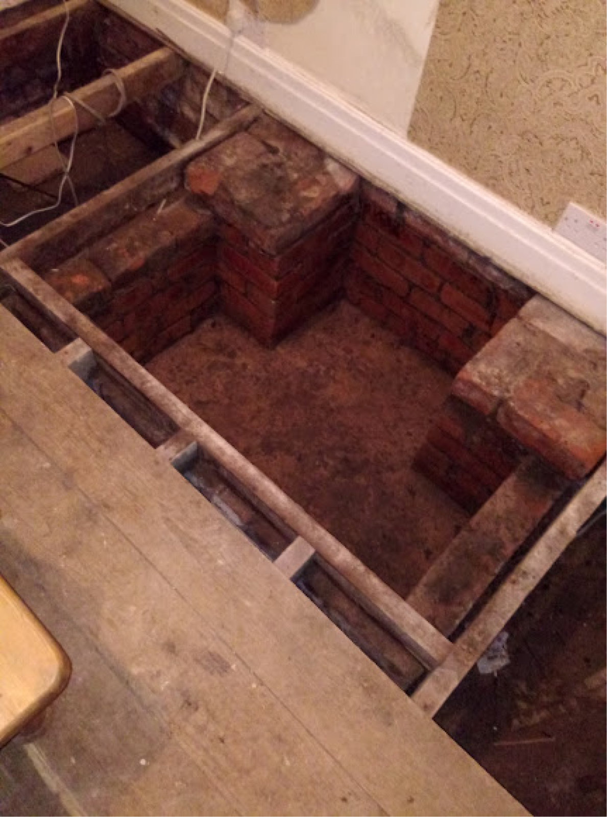

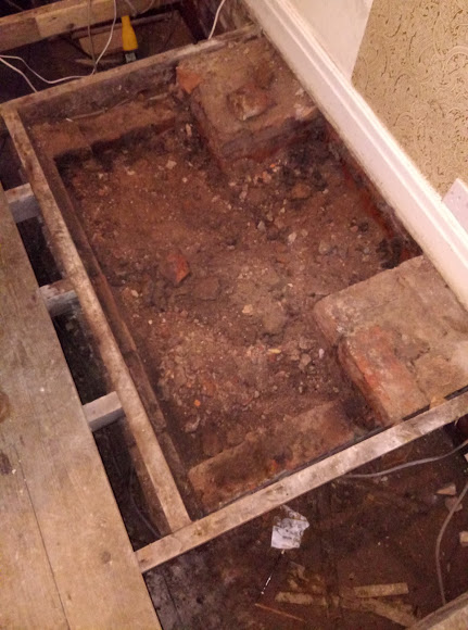

I've dug out a hearth and would like some advice on installing some joists. Please see photos.
As you can see the hearth has left a gap.
The front wall of the hearth supports the cross joist.

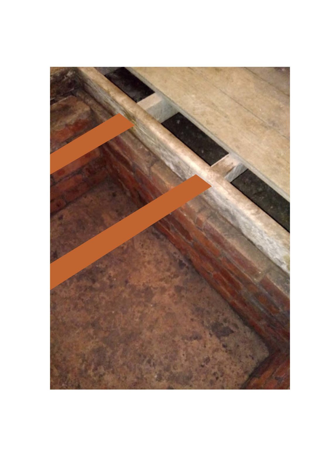

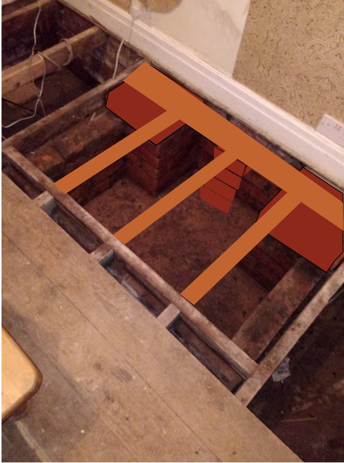

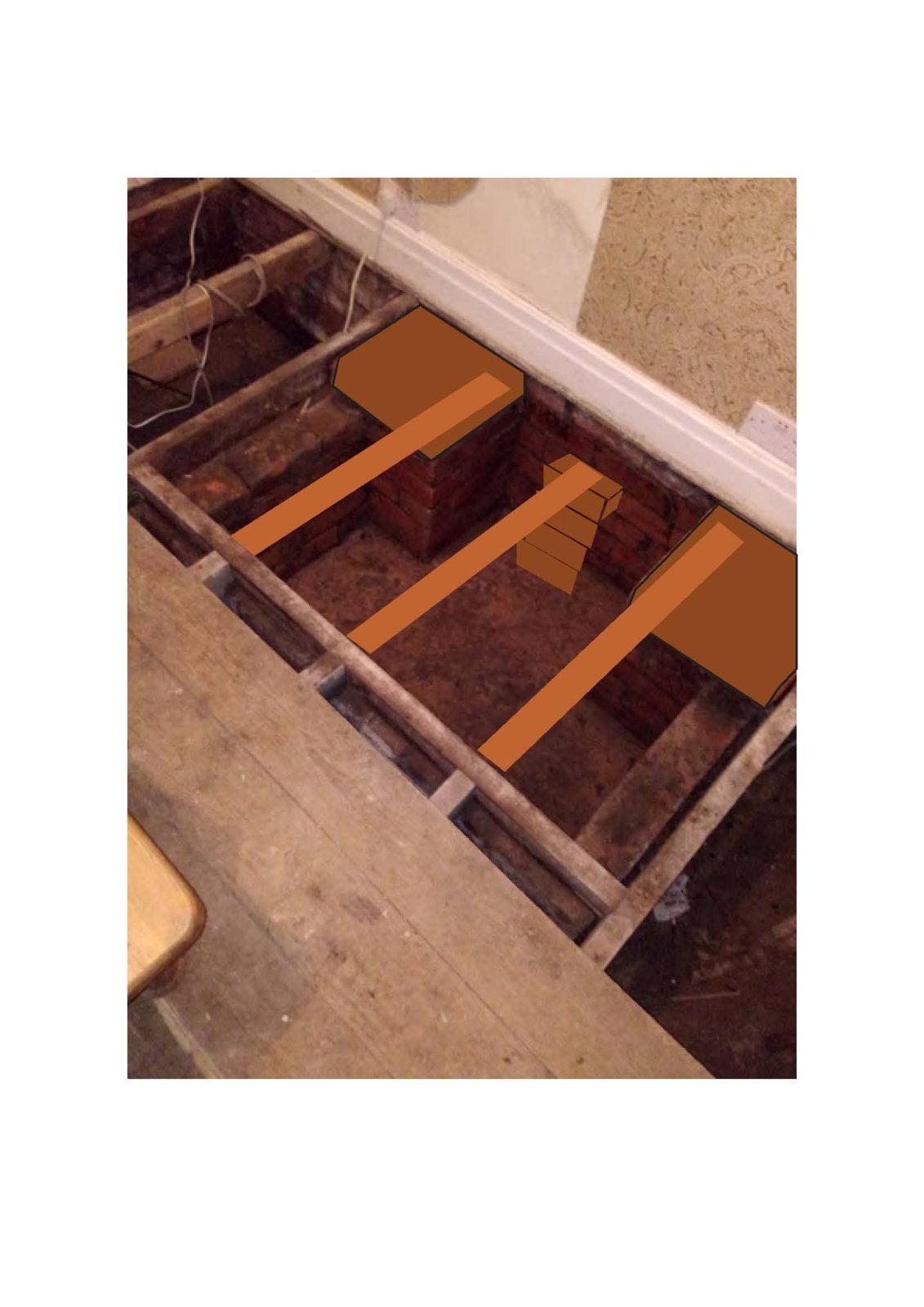

I propose the following
1. Keep the cross joist and leave all existing joists as they are
2. Add three short joists from the front wall of the hearth to the gable end of the house. All three short joists will sit on the front wall of the hearth. The other end of two of these joists will sit on the side columns of the hearth. The final joist will sit on a new sleeper wall built on the oversite.
3. Ill put the joists on battens and on a dpc.
See photos.
Does this sound ok, any other ideas
I have a problem with the cross joist which sits on the front hearth wall. This cross joists rests in some mortar on the wall. Should i remove the mortar, put a dpc under the cross joists and mortar it up again.
Advice please
