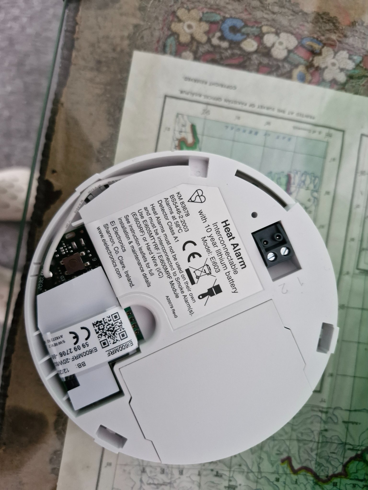

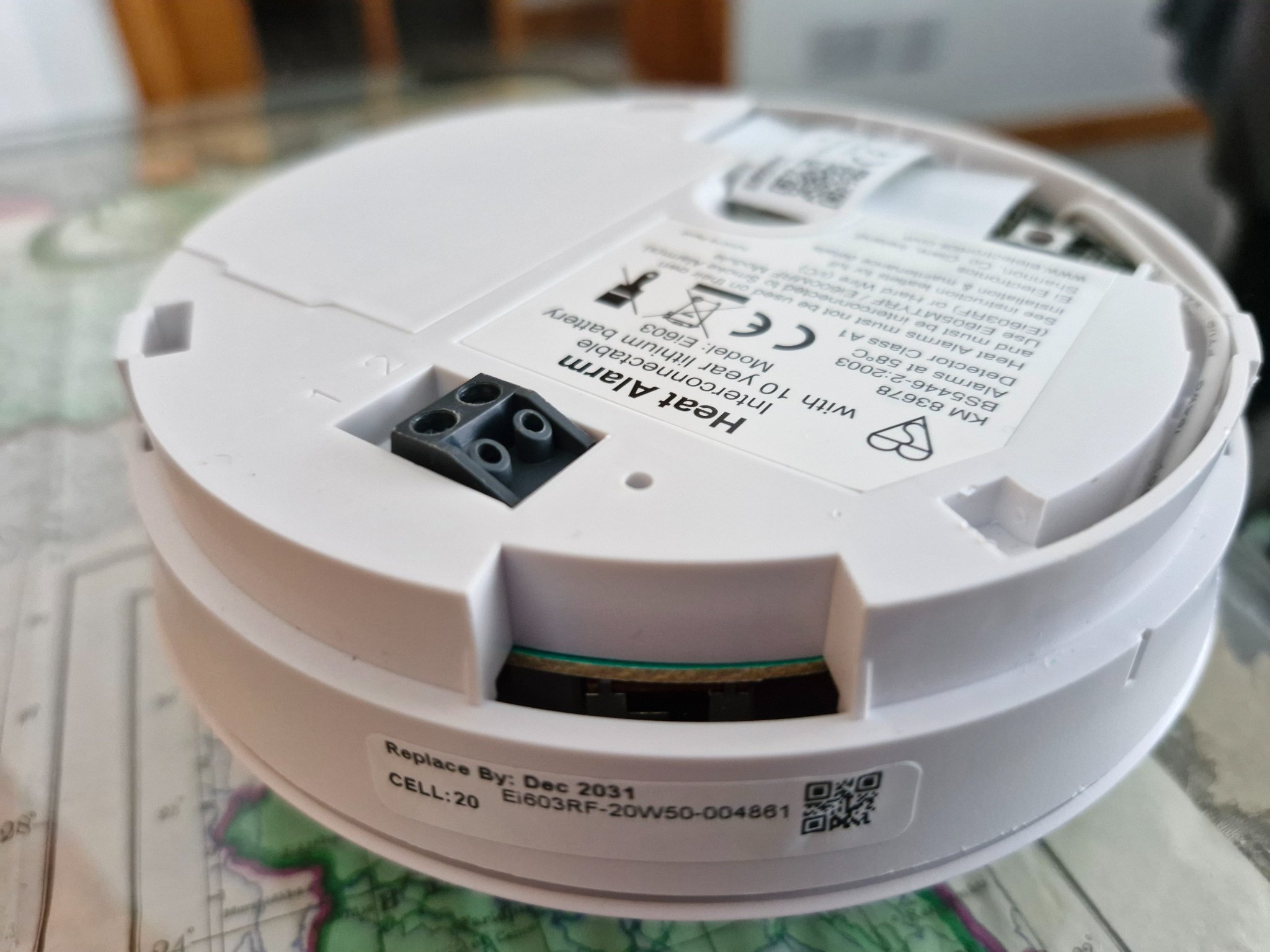

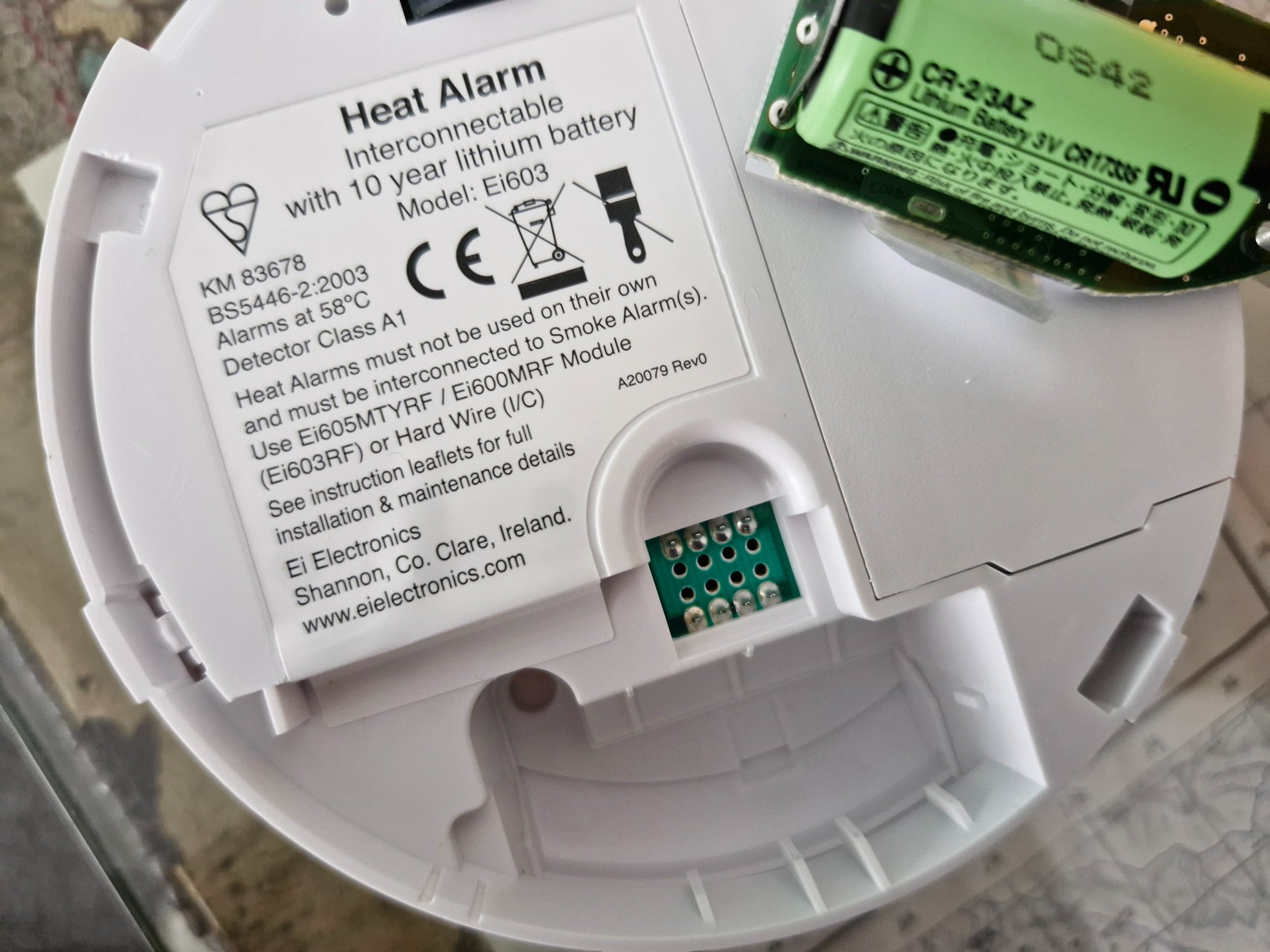

Hello.
I have a heat alarm that does not expire until Dec 2031. It started beeping, red light flashes every minute.
I tested the alarm and it works and then the beeping stopped ....but the red light still flashes every minute.
Ei603 RF- 20w50-004861
Cell: 20
See picS. Do I replace unit or replace battery
As Denso says it is indicating that the device is powered. The battery shoulld last 10 years.
From the instalation insructions
"Your Alarm is a life saving device and should be checked periodically. Regularly
check that the red light on the Alarm flashes approx once a minute to show the units
are powered. Replace the Alarm if the flashing stops"
Yes I think you may have some luck with ei/aico on this
They seem very reputable
If dust blocks or restricts air getting into the device?
Indeed so, it would need substantially more dust to have much effect on heat alarms than on smoke alarms but yes anything that reduces airflow and/or causes a barrier can effect both so always worth considering.
