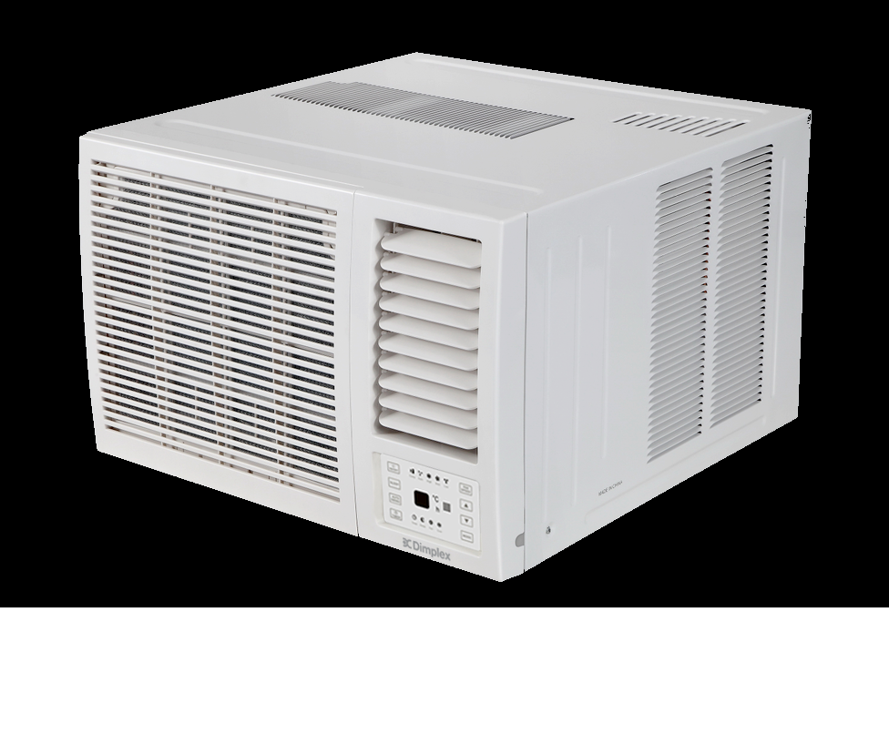

I have used heat pumps for years, they make the temperature low enough to live in comfort in warmer climes, and some did reverse, and also heat on cold days, in the main they were a box which fitted into a hole, think they were called "Window Wall Box Air Conditioner" and these worked well, but in this country they don't seem to be so popular 1685471165225.pngthe main point is they worked in just one room, it was not a central system, so worked out cheaper, the things which are being pushed to heat our homes are large fixed units which replace the central heating boiler, but to cool they need a way to remove the condensate, so many are heat only which seems a bit daft, and also to heat and cool it needs a fan of some type.
