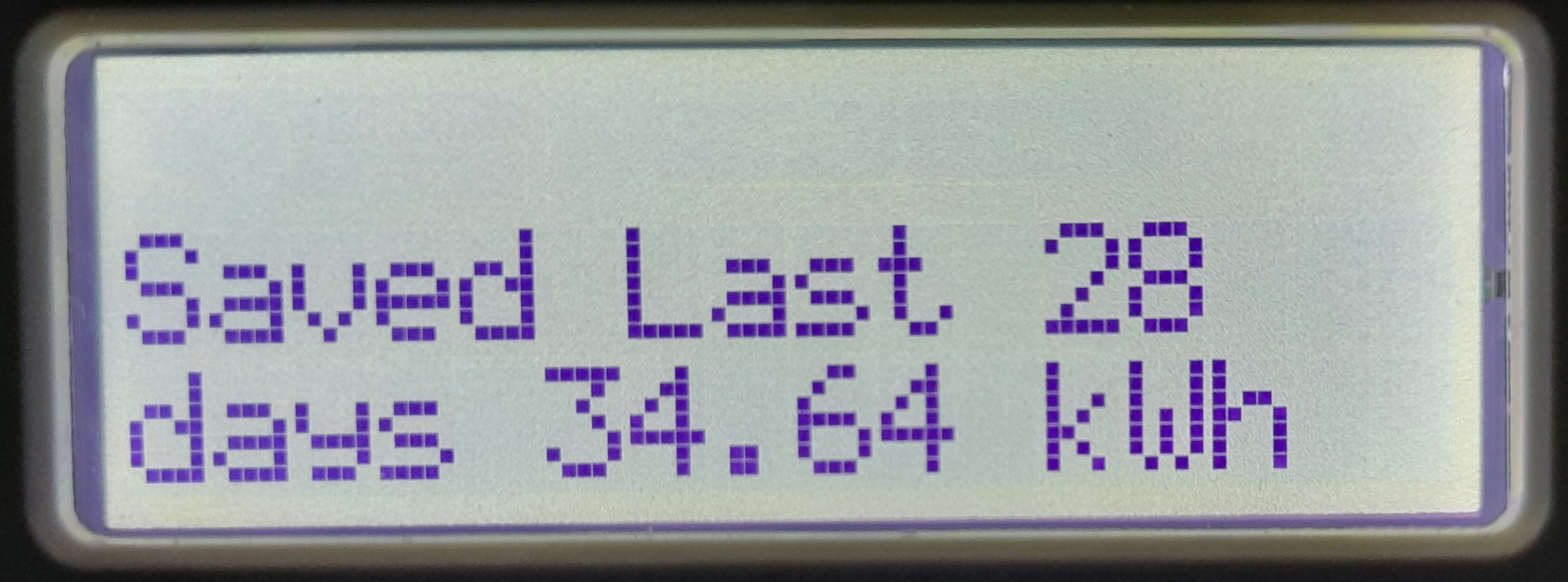

I have an oil boiler, rather old, with an external cylinder for DHW, so on having solar, hindsight and that's easy, I made a mistake, and had an iboost+ fitted.
I now look at the cost to change, and wonder how it will work, and if to try is throwing good money after bad? So let me expand a bit, two points, one is energy lost every time a boiler fires up, does not matter if one pint of water or 5 gallons, every time it fires, it looses energy as it heats up and cools down, so one wants a long burn, not a few short burns.
The second is heat lost in the pipework, again does not matter if one pint of water or 5 gallons, pipe work needs to heat then cool.
And the last one, is with solar and battery, when is the cheapest time to use energy? This depends on the tariff, but I pay 8.5p/kWh off-peak, and I get 12p/kWh to export, so I am better off heating water overnight, to using solar. So a simple timer would have been likely better to the iboost+.
But first consideration is pipework, these
have been considered, holds 10 litres, so it could possibly supply daily needs at the kitchen sink, and would remove all the losses. But I have 5 sinks in the house, only 3 used much, and turning hot water off to all but one sink could work, but the units take up space under the sink. I could supply them with hot water, so it only boosts the heat, as yet done nothing. Main thing is the iboost+ records how much it uses, 1774343758766.png as 8.5p/kWh that's under £3 a month, (£2.94) is it really worth worring about? However the boiler, no thermostat on cylinder, so had to use time, and found if I ran boiler for ½ hour every day, I got enough hot water, in fact the boiler would cut out after 20 minutes, so going for 28 days, at 20 kW at 20 minutes per day, this is 186 kWh don't know oil cost per kWh or how efficient the boiler is, but using over 5 times the amount of energy was unexpected, and I stopped using oil to heat water in summer. In winter can't stop it, but I do no sequal a time, it just heats water when central heating it running.
