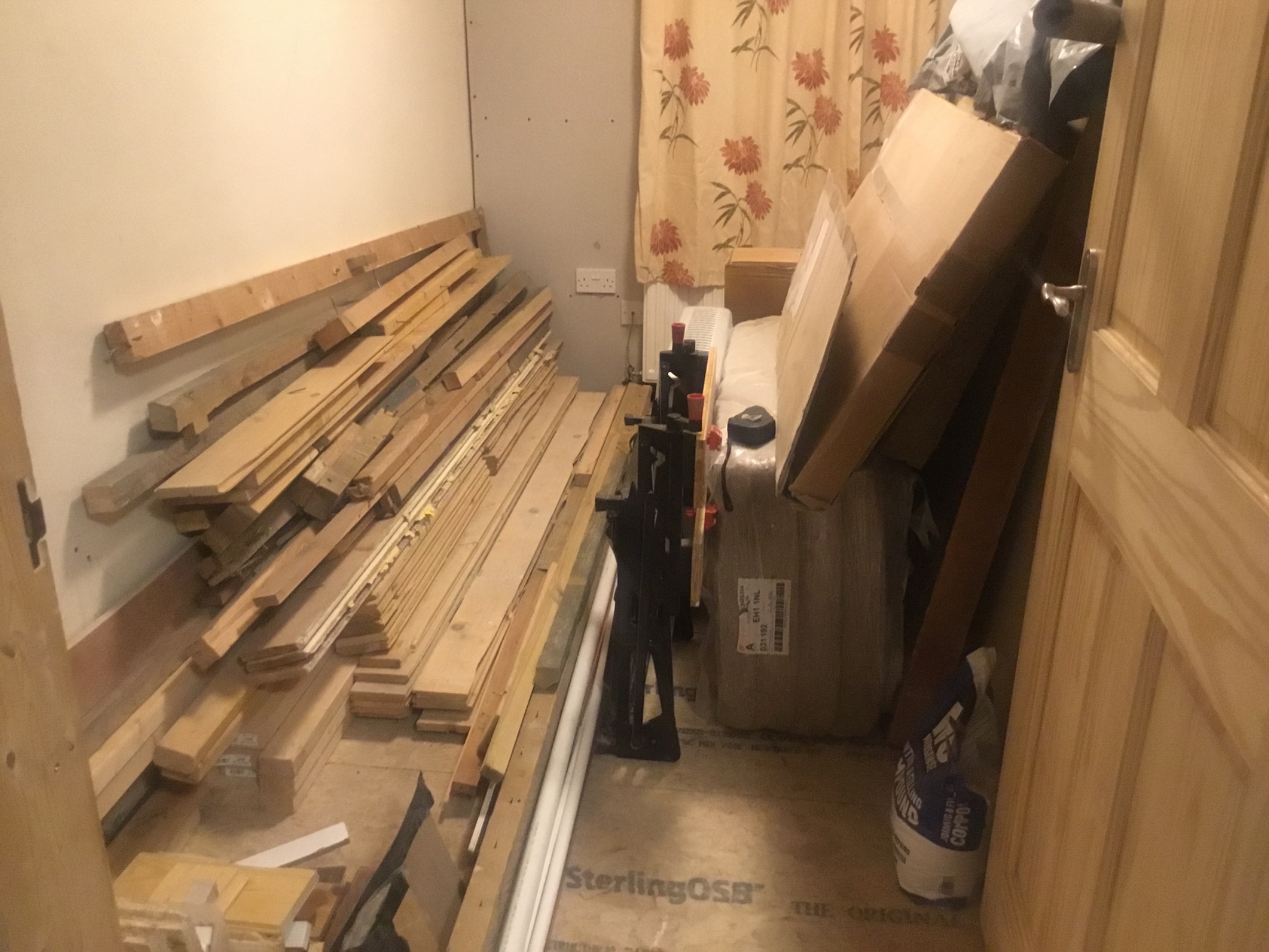

This small room is currently storing materials for my flat renovation project:
The right hand side has mostly plasterboard, insulation boards and similar large sheets which use the space efficiently.
On the left hand side, as you can see I have a pile of bits of timber (and some pipes) on the ground and against the wall. I’d like to make more use of that space vertically, to free up space elsewhere in the flat.
A challenge is that in order to access the timber, I can’t really use shelving units with legs at the front. On the other hand, shelves attached to the wall would have to be very substantial (£££) to hold the sort of stuff I’m considering putting there.
I am wondering if the best solution might involve scaffold poles, or similar, running the length of the space, supported on some sort of trestle at either end. Or some similar construction.
This is only “temporary” (i.e. a few years, at the speed I work!) and budget is minimal.
The room is about 3.5 m long and the space on the left is about 55 cm deep. What would you do?

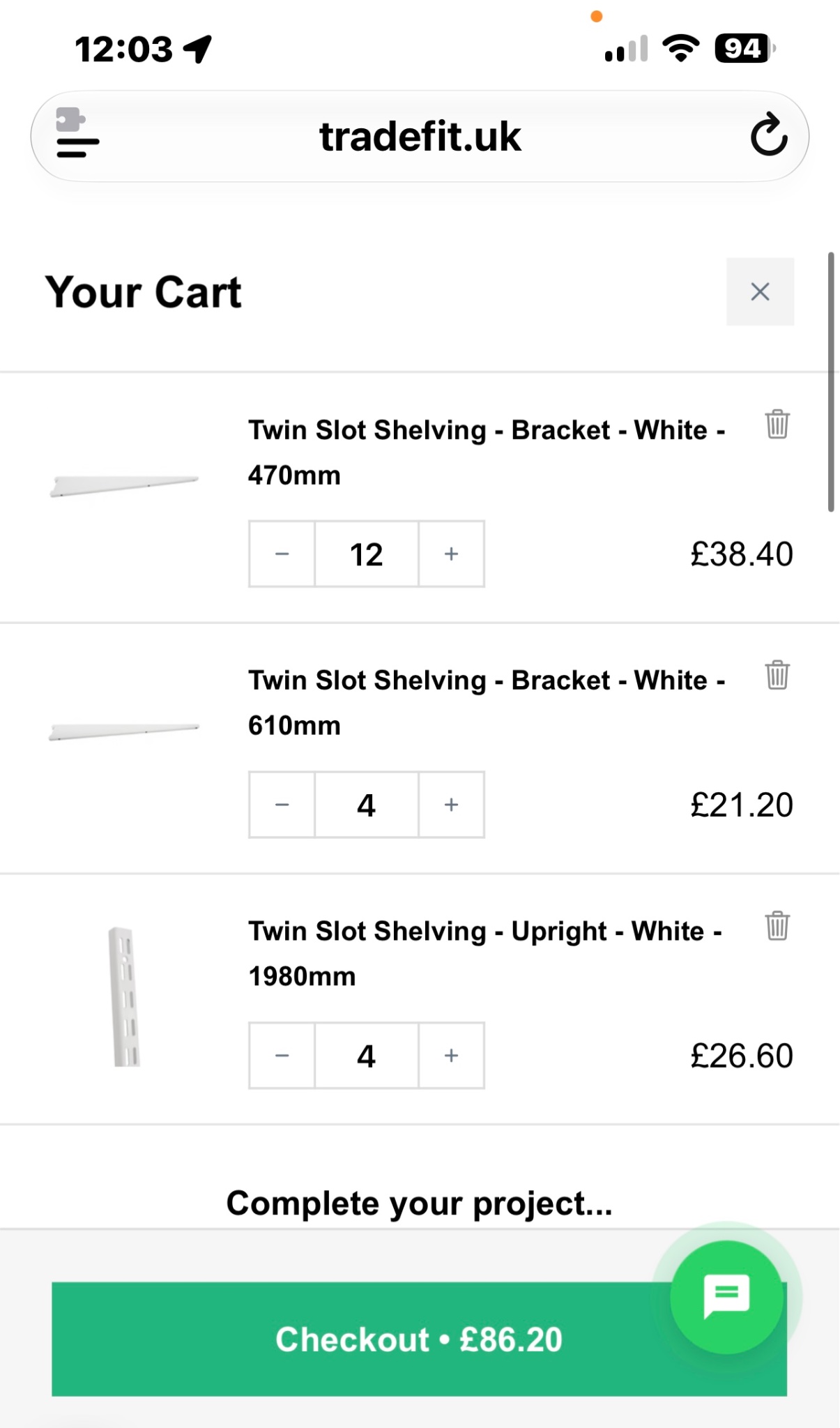

Twin slot shelving .Cheap and will hold all the timber you have and easily the same again
£86 will give floor to ceiling rack , use larger brackets above head height .

Thanks; I was skeptical about both the “cheap” and “strong” parts of your reply but have looked at some specs and the parts are both cheaper and stronger than I had guessed. The limiting factor seems to be the wall anchors and the wall itself. This wall is good brick so I should be OK - though it does hold up three flats above me, so maybe I shouldn’t pepper it with too many holes!

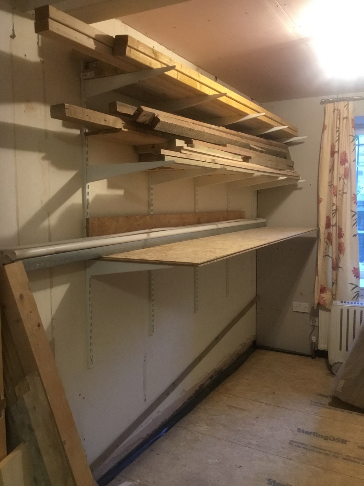

Shelving fitted!
It’s screwed to the wall with 5x100mm screws, with each hole containing 2 40mm rawlplugs. This seems pretty sturdy - how would you have done it?

With twin slot shelving, the most important fixing is the top screw. Unless that fails, the others don't do much.
The top channel fixing must be higher than the top shelf.
Run it right up to the ceiling, and don't have long brackets, or heavy loads, on the top shelf. The brackets provide leverage to pull out the screws, and it is at its greatest on the top brackets.
Put your longest brackets, and heaviest loads, on the lower half of the rack. Their vertical load on the uprights will not pull out any screws.

I overloaded this type of shelving , all screws stayed in place but the bottom bracket collapsed when the upright spread suddenly at the base .
