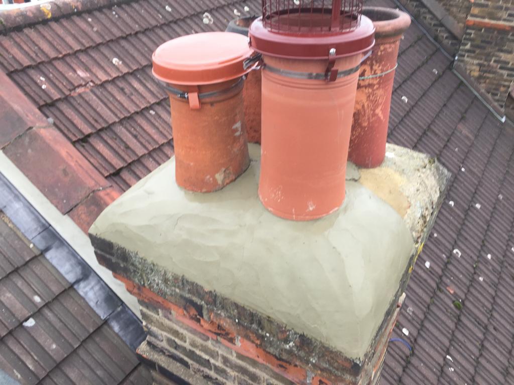

This is the current set up at the moment...IMG_5420.JPG Just want to have the new pot matching roughly with the one bottom left of this photo
Looks like the pots are held in by just the flaunching on that stack, which is quite common. You need to cut off some of the flaunching and probably use some slate to hold the new pot in place. Ideally a pot should be built into the brickwork as shown above, but in many cases tall pots are only held on by the flaunching.

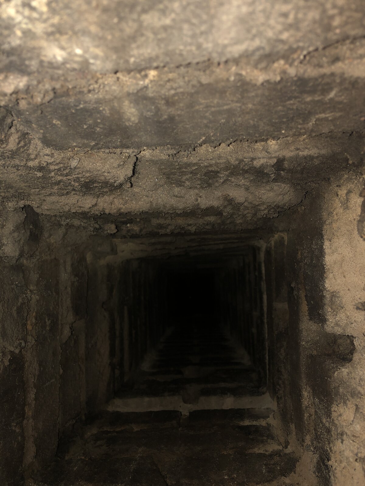

The house was built in 1910 not sure if it has a clay liner. This is the view looking into chimney

There is no liner in that flue. You need to cut back more of the flaunching. Then measure up from the top of the brickwork for the new pot. Probably need a few bits of slate bedded on top of the brickwork to catch the edge of the pot. When it's all filled back it will hold the pot in place.
