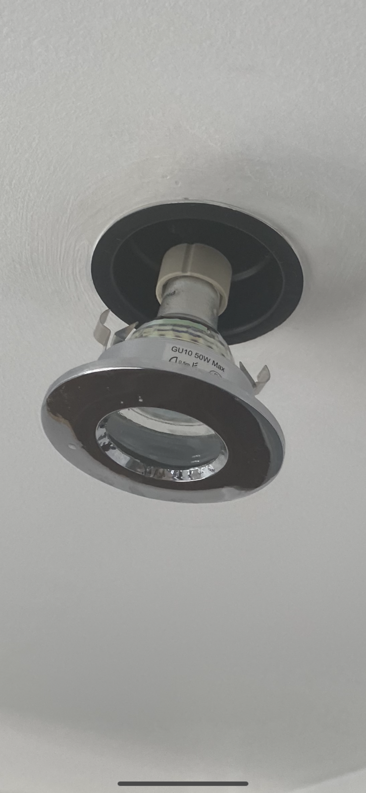

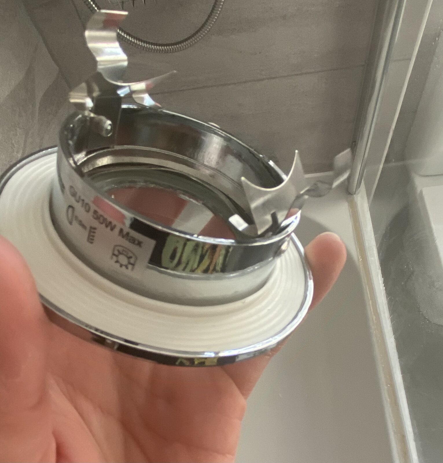

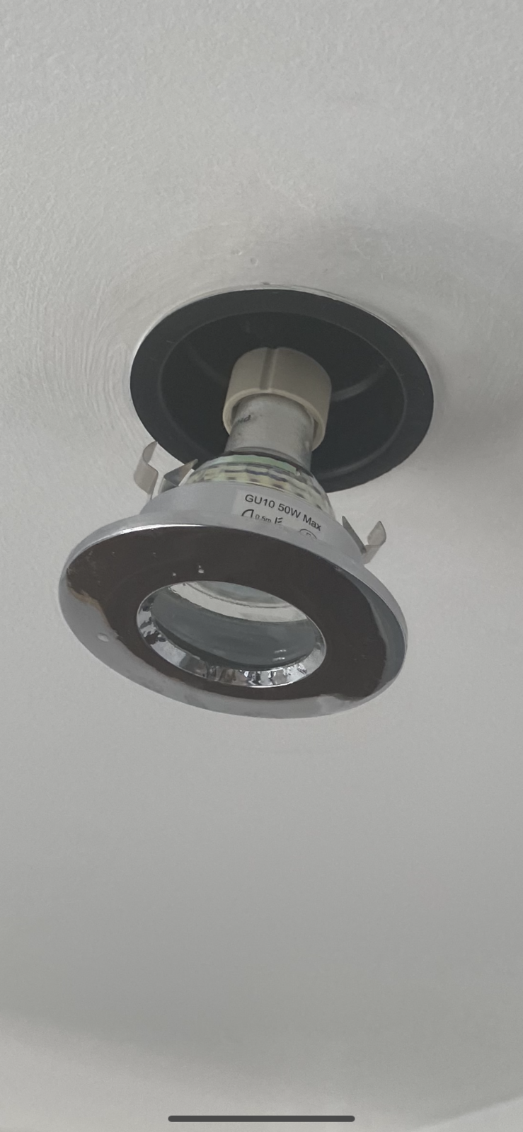

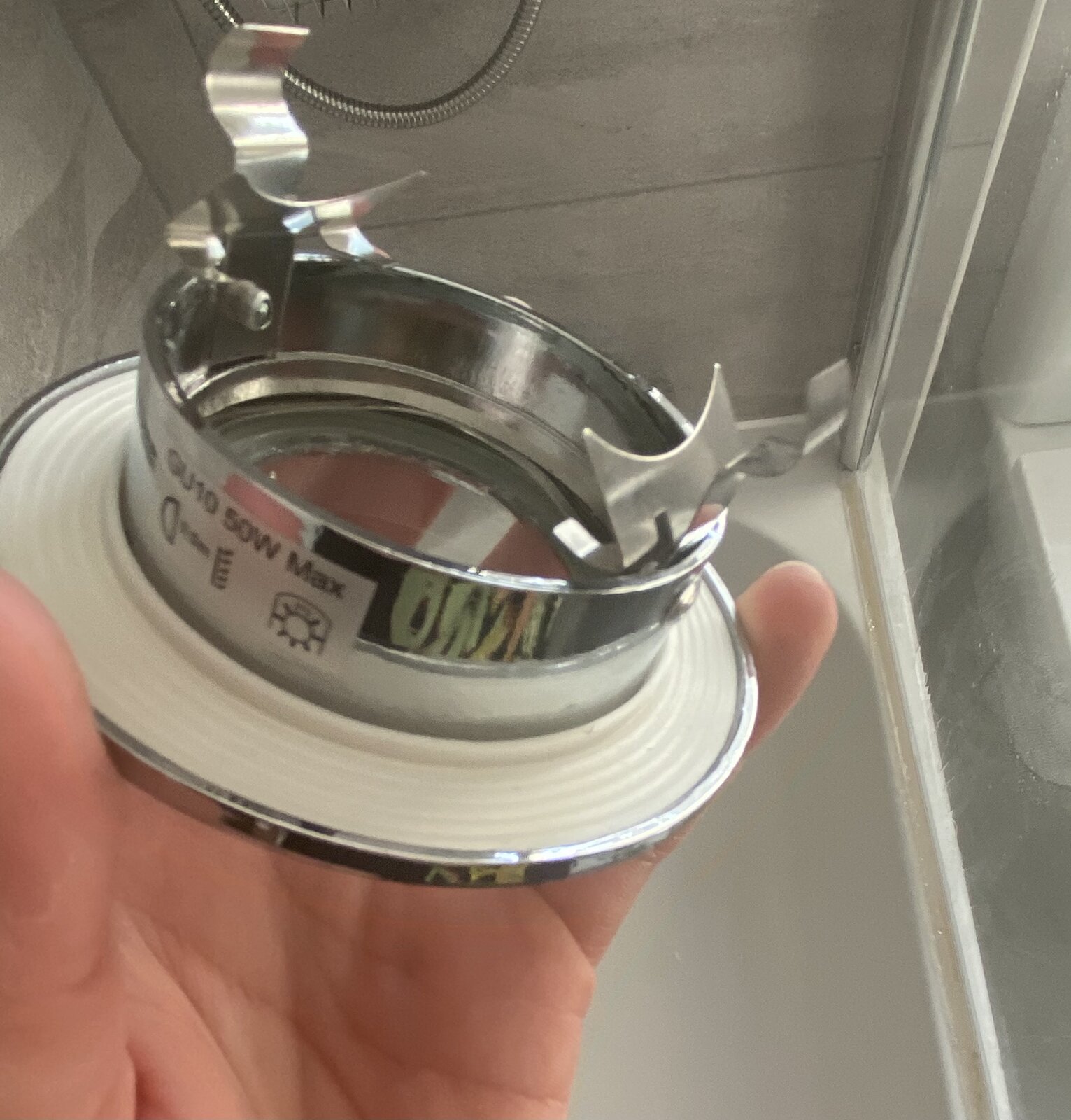

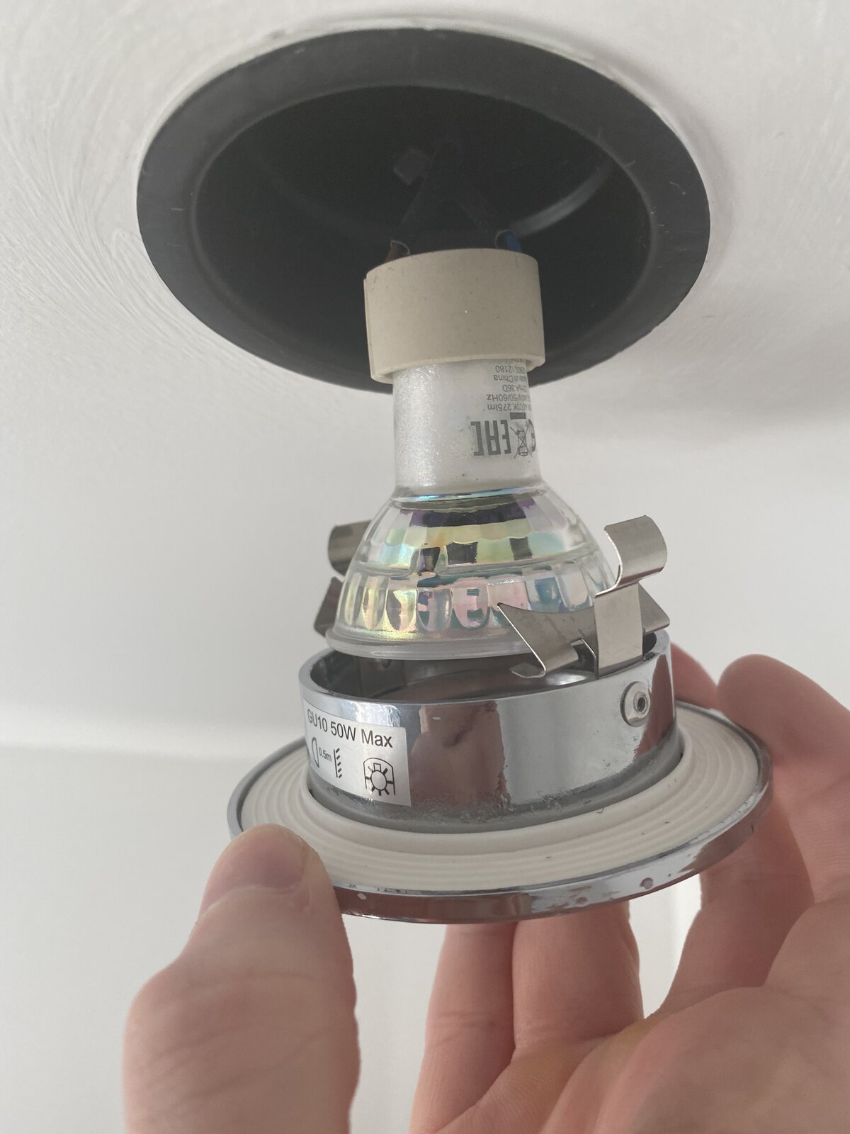

Hello,
Does anyone know where I can find one of these light fixtures / bezels?
Or something similar, I can’t seem to find anything that holds the bulb as per the photos so would just leave it dangling..
In the main GU10 the bulb is held by the bayonet connector and G5.3 by a ring on the bezel, you seem to have a mixture of the two types of MR16 fittings. I will would have guessed it started as a G5.3 and has been converted to GU10, this is done a lot when converting to LED, the problem is an earth needs to be taken to each fitting even if not used, and it was common with G5.3 which were often SELV not to run an earth. Although your bezel says GU10, which seems odd, some old cold cathode lamps were longer so maybe a method around the longer lamps, but since the cold cathode GU10 is long gone likely the bezel is no longer made, not sure if this is your bezel or some thing you want?
The bezel and the black part in the ceiling were sold as a single item, not available separately.
If you want another one, it's buying a complete light fitting.
I just wanted to swap out the bezel as it’s corroded due to the steam in the bathroom.
Looks like it will be a new fixture grrr.
Thanks for the replies.
