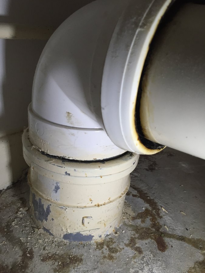

Hi. Grateful of some advice before I start on new downstairs cloakroom.
I am trying to size up the fittings (roughly) before I pull out old loo.
What I am unsure of is what exactly do I have that is set in concrete floor.
Visually, this'll looks like a slip type fitting which makes me wonder will I find a seal inside. I have been looking at fittings (say McAlpine Wc-con8e; that I think is my closest fit) that have a multi fin seal of their own - will this type be okay.
Thanks D.
You have a 4" soil pipe with a push fit socket set into the concrete.
If you're going to use a finned 90° pan connector then you should fit a short piece of 4" soil pipe into the socket first.

Finned connector fits into the pipe, so a piece of pipe is required in that socket.
Connector without fins will fit directly into the socket.
Or cut the socket off and put a finned connector into the pipe that is left.

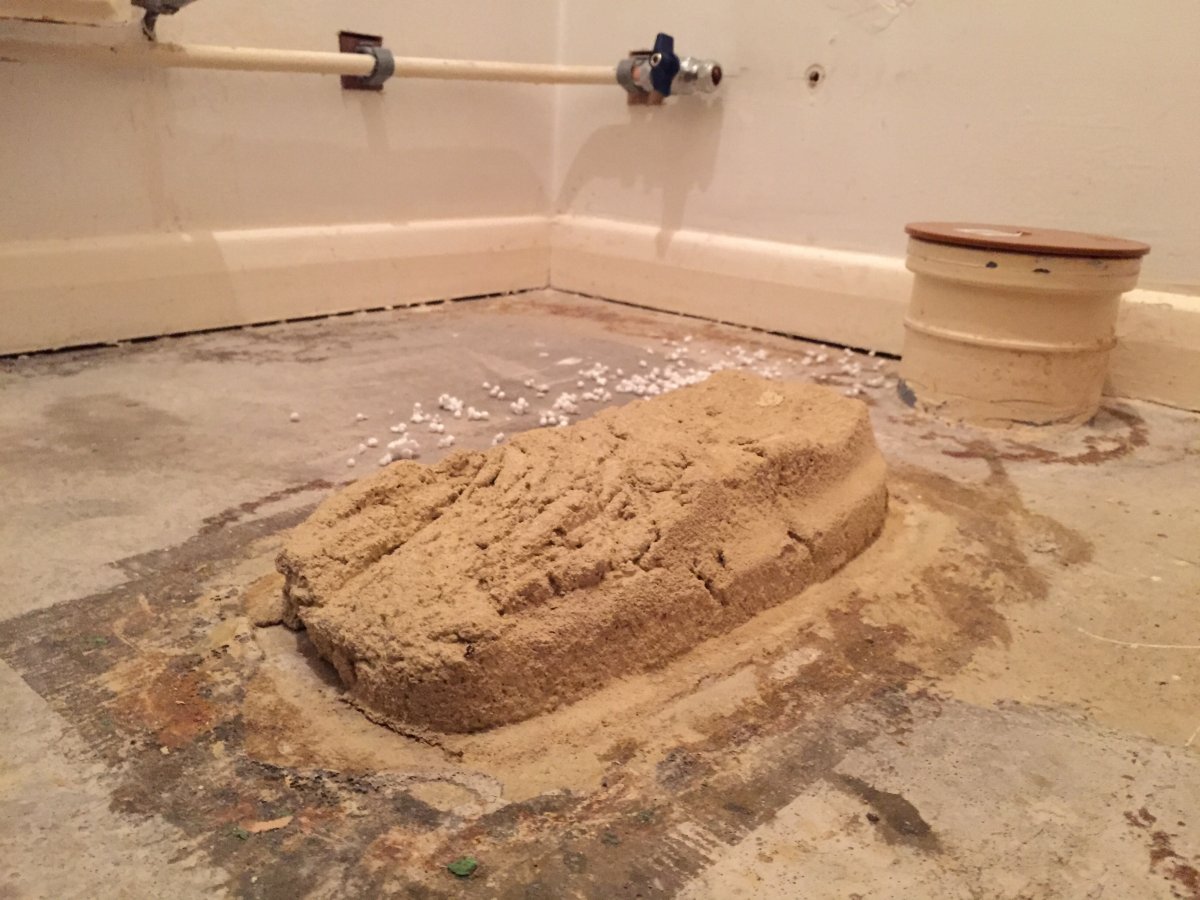

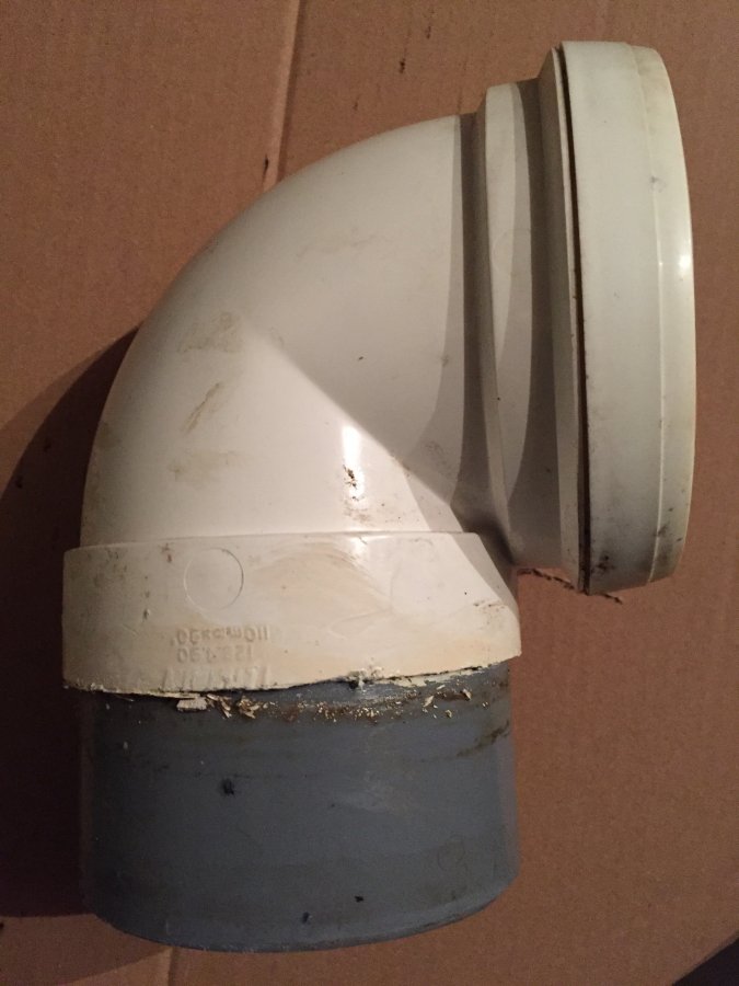

I removed my loo - advice was spot on; 110mm push fit socket in the floor. The pan connection looks improvised - a standard WC connector cut off and solvent welded to 110mm pipe. I guess previous person also had same problem finding something that fitted.
Also discovered large dollop of cement under pan.
Large bolster out tomorrow.
D

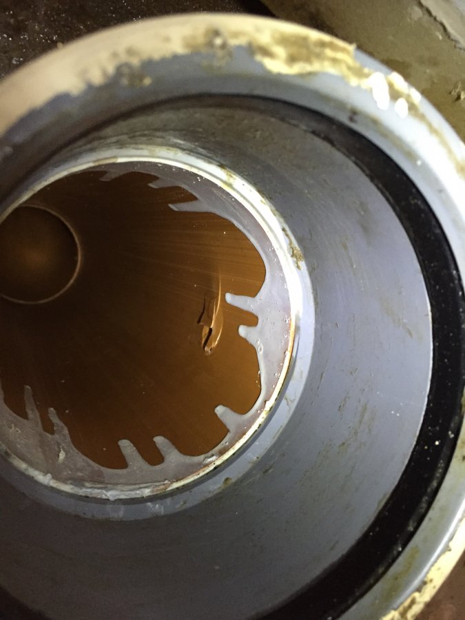

Hi. Hoping for a bit more advice.
Looking at advice of Denso13 and wondered about the long reach finned connector that reaches past the slip connector. Measuring up the depth and I noticed some damage in pipe from original fit (see pic).
Would you advice I patch this up - fill it with something and sand it. Would it solvent weld. Should I snap of the jagged bits and silicone.
Or should I just avoid that part of pipe.
If it's through the wall of the pipe then clean it up and fill with a little 2 part epoxy. If it's not through just clean it up.
That's a good idea - do you mean something like the 2part putty for leak fixing ?
I don't think there is a hole to be seen but it looks like an impact has deformed and broken the plastic. It has probably sprung back and closed up.
