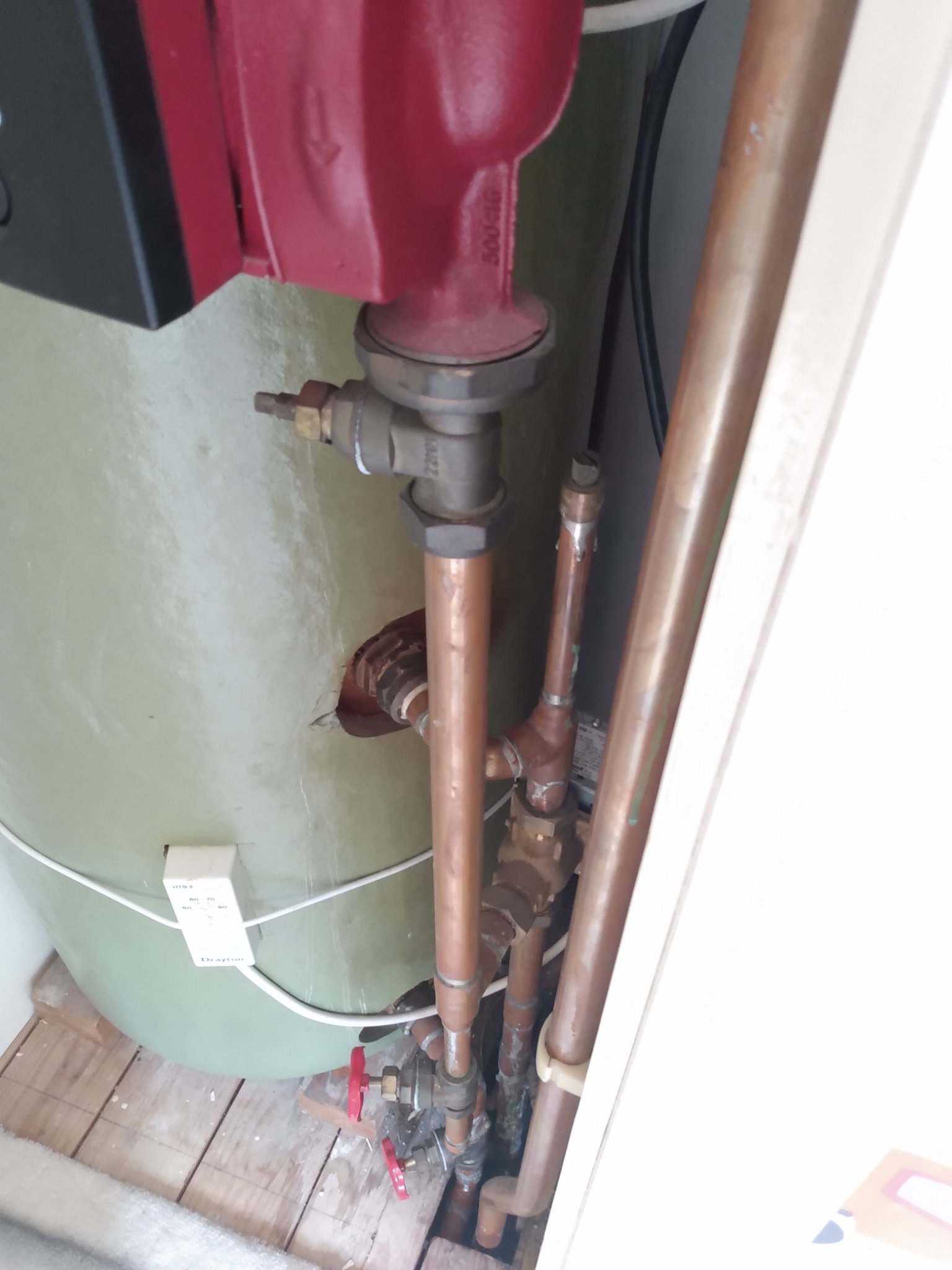

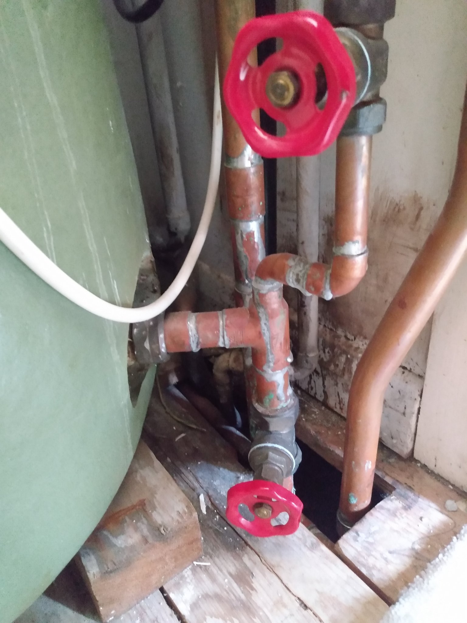

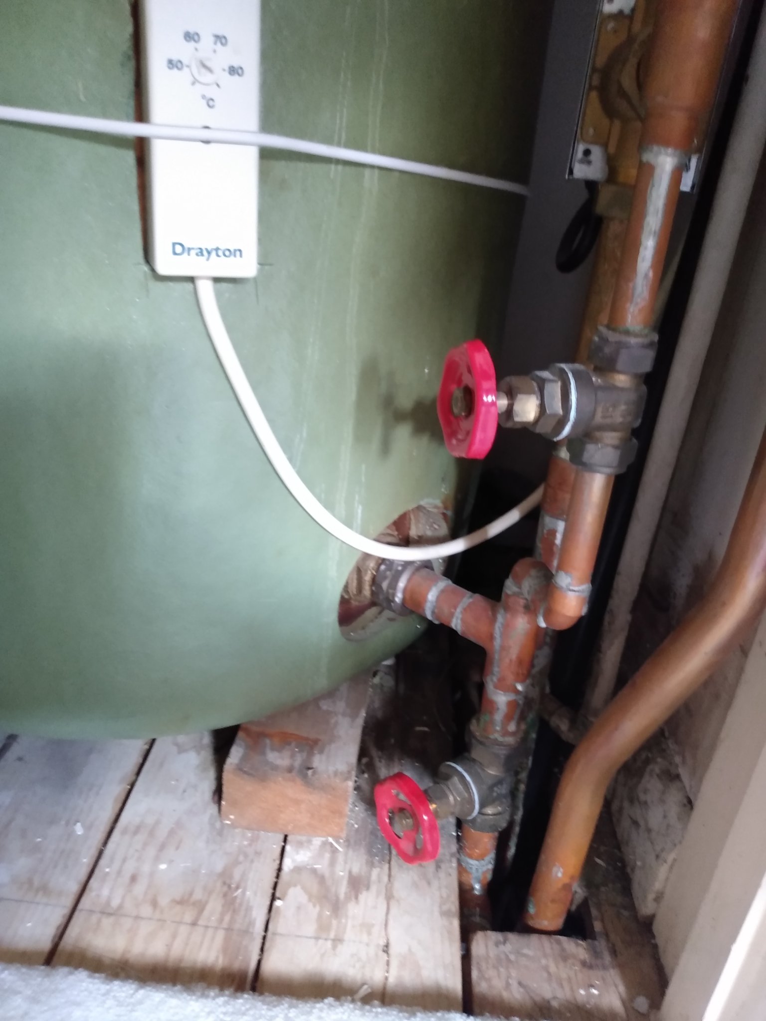

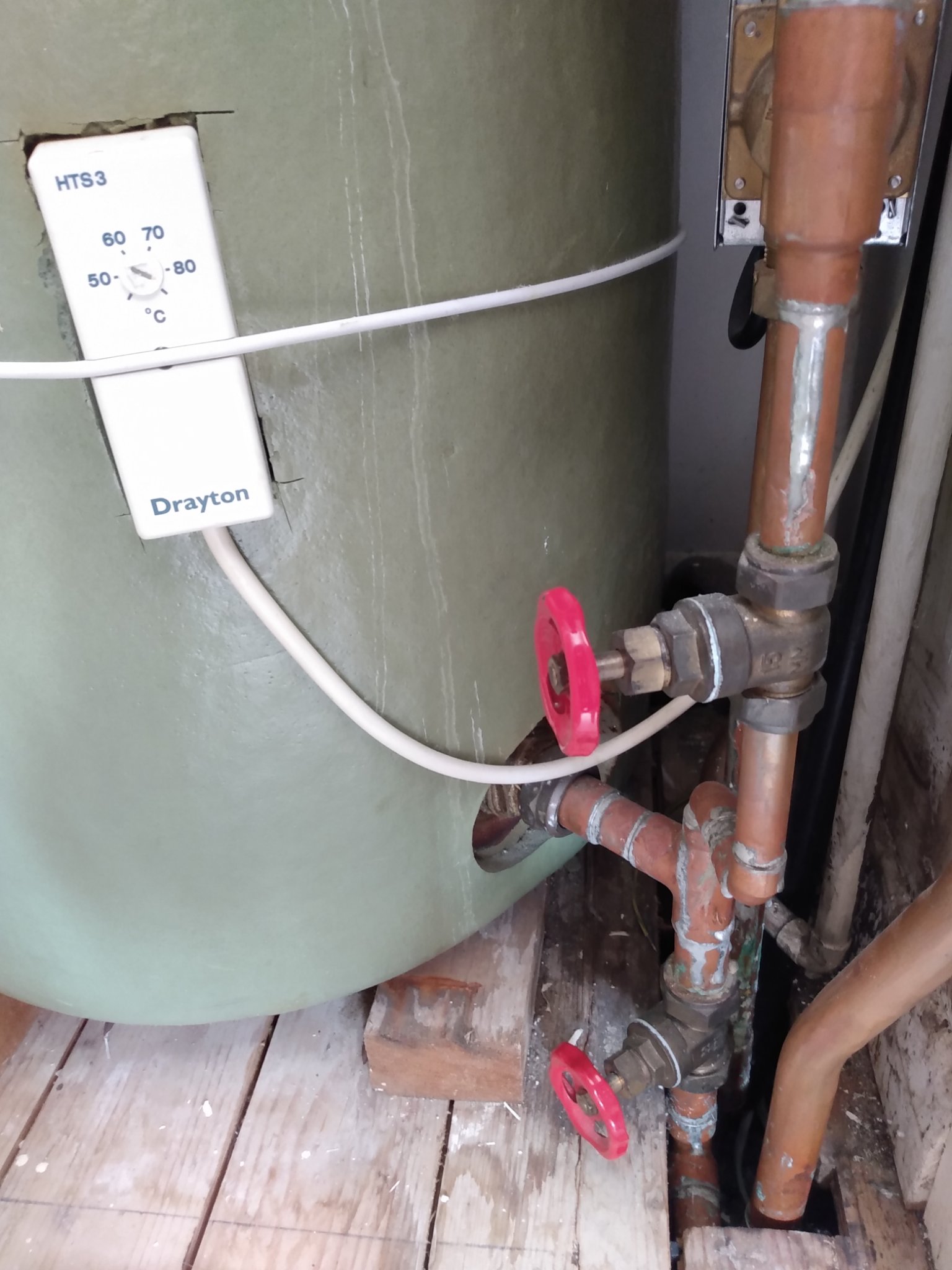

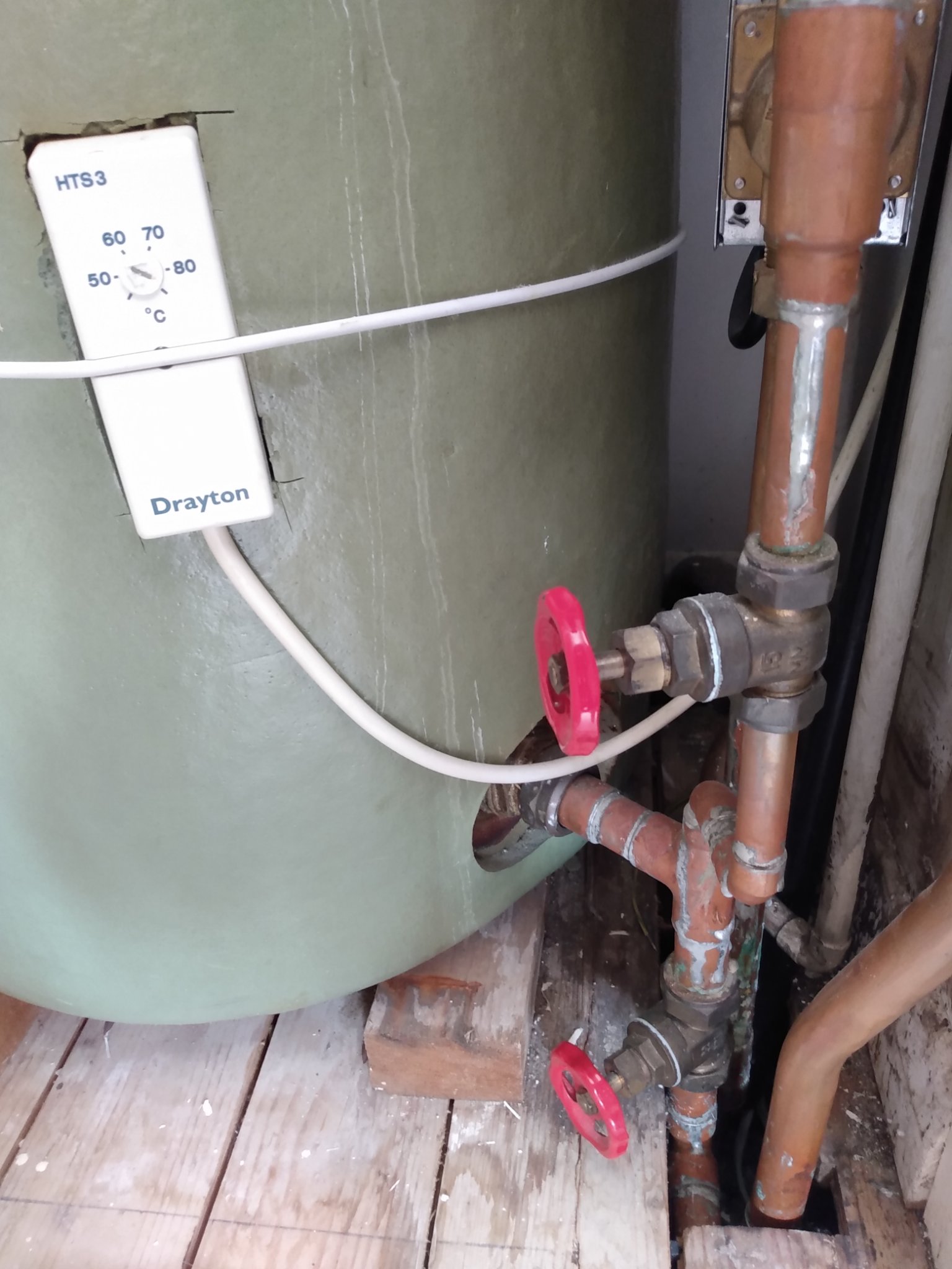

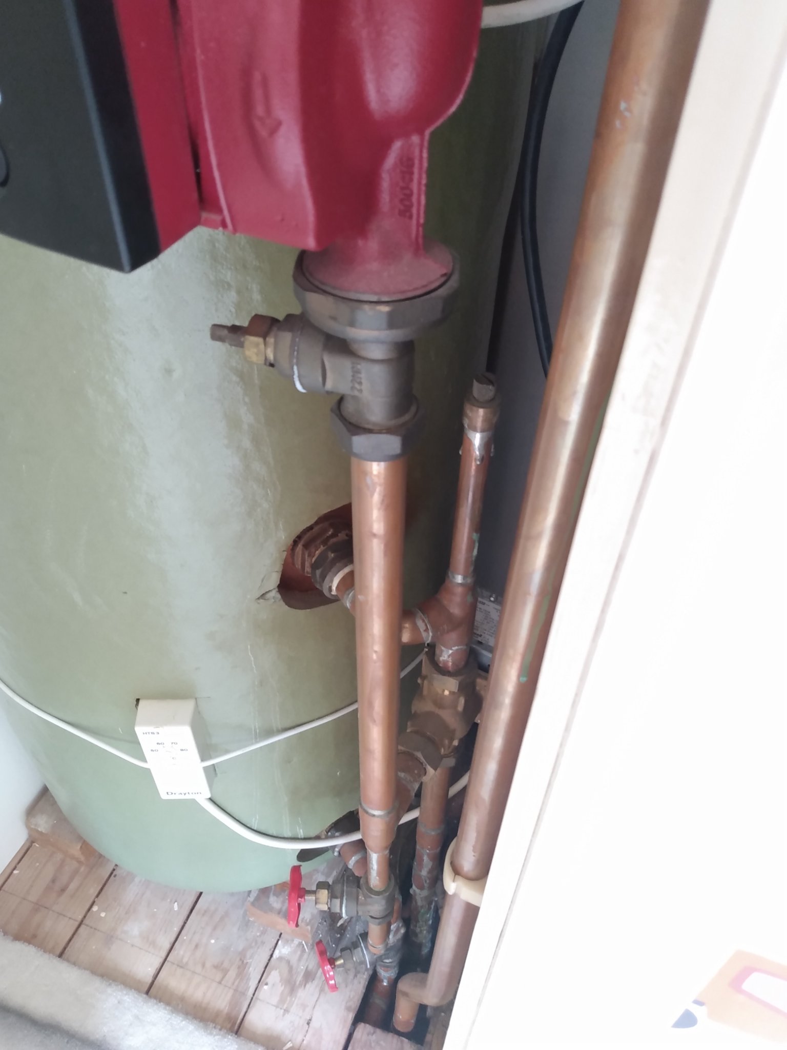

Hello and happy Easter! Would anyone be able to explain, from the photos and the video of my HW tank, what do the 2 red valves control and whether they should be closed or open? Upper one is sitting below an intersection below the CH pump. I wonder if, when opened, this contaminates the water in the HW tank with the water used in the CH system? Lower one seems to be cold supply.
Little bit of context: trying to cut off water coming into the HW tank. Gravity system (UK), got a cold water tank in the loft and the HW tank in the airing cupboard.
Thank you in advance.
Photos below, video here: https://drive.google.com/file/d/19pp5Y0LjUhGxqvuGmtVMVREkmZeTAisi/view?usp=drive_link

Look like they are a bypass and for restricting the coil return. If it is all working ok just leave them as they are, they aren't contaminating anything, the water in the cylinder is a separate thing.

But what about these 2 red valves? I fiddled and closed them (stupidly) thinking it'd prevent the tank from filling, and I'm doubting if the top one was already closed or not ... So that's why I'd like to understand their purpose.

As above, the top one is a bypass and should be cracked open, the other is to throttle the cylinder coil return, open roughly half way.
How much they are open/closed isn't usually critical.

Looking directly at the red wheel handle - clockwise to close. Gate valves may not close completely.
the top one is a manual bypass and can be left completely closed as you have a 3 port valve
The bottom one is a balancing valve for the HW which from fully closed open it about 1 and half to 2 turns
Obviously more experienced than I, but why is it not needed just because it's a 3 port?
