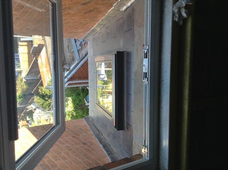

Hi there,
I've just had a new pitched roof with a Velux window installed. The quote just said something along the lines of lead flashing to be installed.
I'm not happy with how this looks. for a brand new roof I expected something a lot better. There's different gaps the whole way along. Whilst researching I've noticed that step flashing seems to be the standard. Is it unreasonable to get the roofer back to tidy this up and or do it with stepped flashing? If so at whose cost?
I'm worried now that either way a diagonal line has been chased through the brick face.
u9bjpcrzd

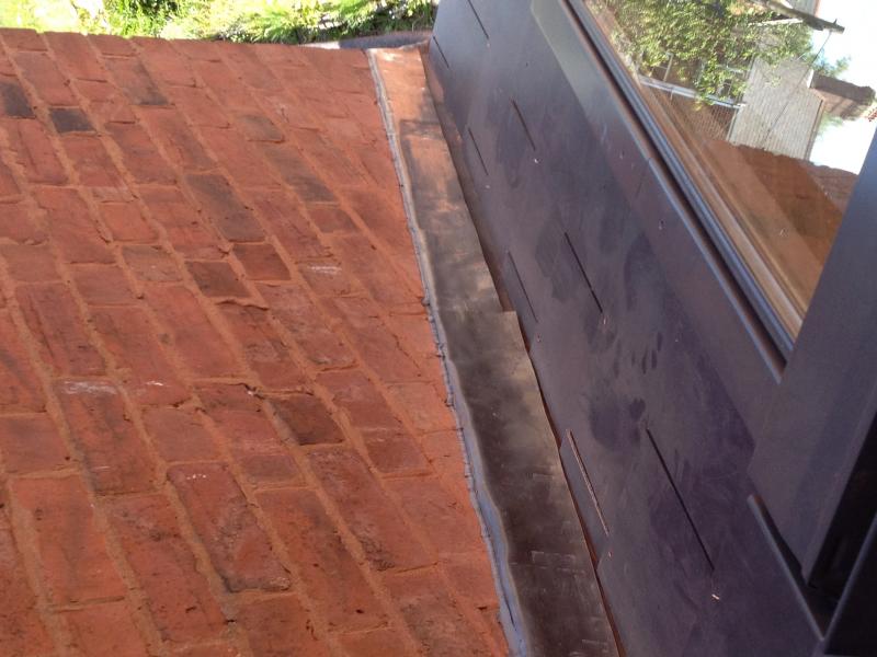

The flashing is not right. It should have been step flashing into every course of bricks.
As for cost what did he list on his estimate.
Labour and materials not including the Velux which I supplied came to £1000.
The quote just says "all lead work as required".
The roofer claims he doesn't like to do the step flashing as it creates weak points in the lead. In any case he says he didn't quote me for step flashing and if he did it would have been £250 more. Surely he should make it clear beforehand that he's not doing it the 'standard' way.
My question is what do I do now to sort it. I've taken care to spec everything highly on the house renovation and now this brand new roof looks bodged IMO. And even if I do go for stepped via him or another roofer, won't it look just as terrible to have all the chase lines which will be left behind.
Haven't paid the balance for the work only a £300 deposit.
What`s been done is the new "standard way " unfortunately . It all started when roofers took the leadwork away from us Old Skool plumbers . And you`ll be left with a gashed wall whatever . Were the walls existing ? it would be a devil of a job cutting out the pointing for a step flashing - but I would have explained and given you the options

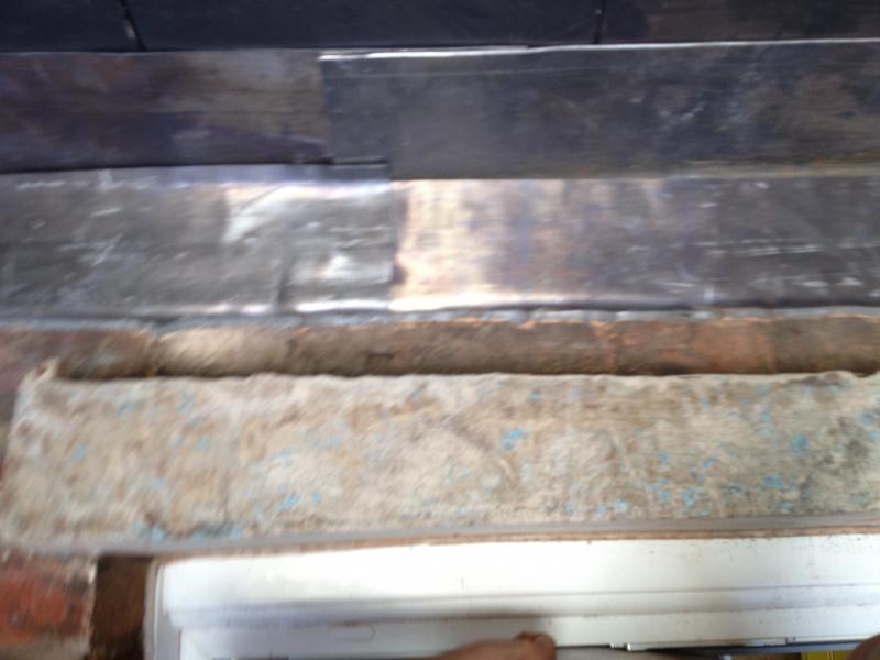

If the soakers have been cut per tile row, and they are under the cover flashing which is chased into the wall, then it will perform.
It does not look that that bad, so what is the issue?

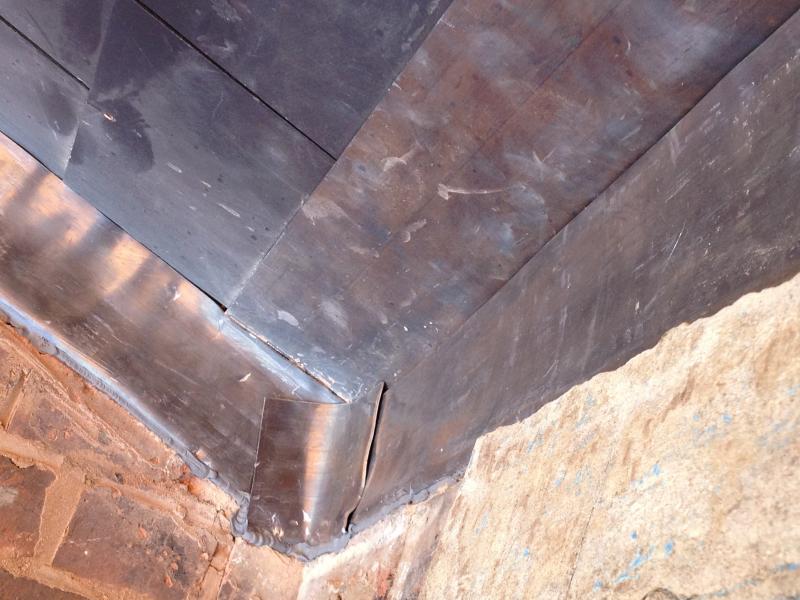

Technically, cutting scarf slots in the brickwork has weakened them so they could fail in the future. Stepped flashing does not jeopardise the brick strength since it is fitted into the brick joints.
Apart from that the start of the flashing on the tight of the window is lying on top of the slate
Straight lead on an angle like that probably means that the builder can't do stepped lead, I don't think they would have saved a whole lot of money apart from time wise, you usually see that type of lead work on render. As long as its done right it's not guna be the end of the world it should still do the job

This lead flashing is very poorly done and you should not accept it.
To do a step flashing on your roof would not have cost any more for materials.
Chasing out the joints would have taken hardly any longer than cutting that straight chase, to form the step flashing would take half a day maximum.
It should not cost an extra £250.
If you have the flasing removed the chase can be pointed in with sand and cement coloured to match the bricks as close as possible.

That is poor.
Hard to know what to advise here, if you rip it all out you are left with the straight chase gashed into the brick faces. That's gonna look awful pointed in.
Might just have to stick with the straight chase, but neater.
