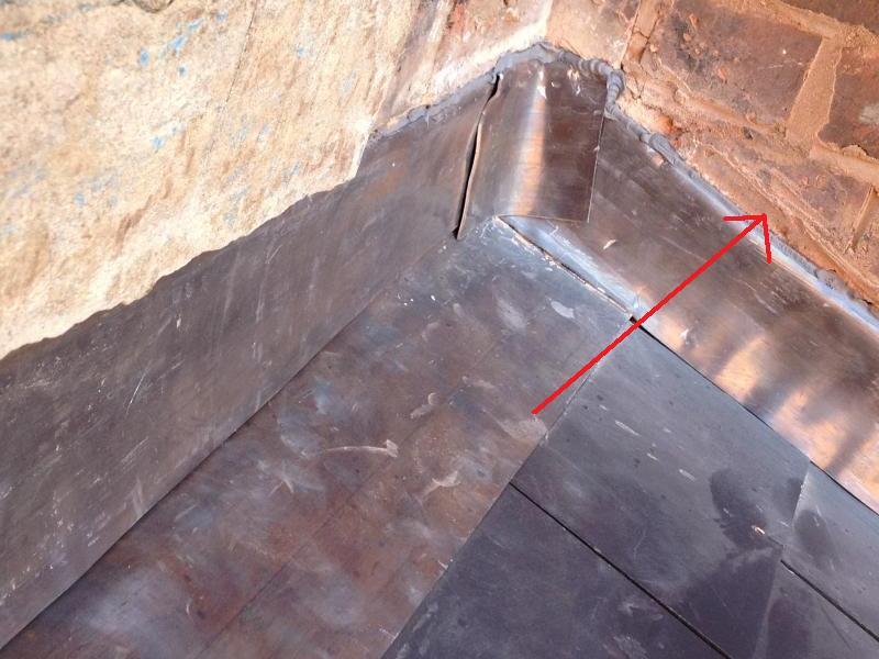

Help! Is this lead flashing up to scratch?
The internal lead corner detail is hilarious!
Very poor quality work, but i agree with Woodsy with regards to quality standards and price. The corner detail is poor and below standard whereas the straight chase cover flashing is low-end but acceptable.
It does look poor to be honest. There are many roofers who can make a very good job of flashings but as one poster mentioned, a proper lead worker would have done it very differently.
My advice to you would be to find a lead worker in the area to come and remove the offending flashing and install single step flashings. They would hide the raked out wall and you would never see what lies beneath.
It's hard to tell from your pictures if the roof is on a shallow pitch, it sort of looks like it is but that could just be the pictures.
Step flashing on a shallow pitched roof doesn't always work out or look good because you have to take the horizontal points of the lead out a long way before the next mortar course below appears. This makes the horizontal points look a bit silly as they are a lot longer than each step down, it also means you have to use wider lead.
On a shallow pitched roof you quite often see a straight chase cut, it's not always done to save time or because the roofer couldn't be bothered, it's to make it more aesthetically pleasing.

I would agree with all of that except in this case the bit about aesthetically pleasing, it looks like a complete dogs dinner. whilst it will probably perform OK the builder, if you can even call him that, should hang his head in shame.
It looks to be in a well hidden (and sheltered) position, so it's not going to be seen much
Looking at this picture, seems it already had a straight cut chase that he has gone back into ?
Mastic needs tooling properly though.
In my opinion 'standard way' is decided by the age of the house. Stepped flashing is the only acceptable way for a house that age.
Definitely no straight chase before. There is a scar line from the polycarbonate roof that was there before but certainly not chased in.
