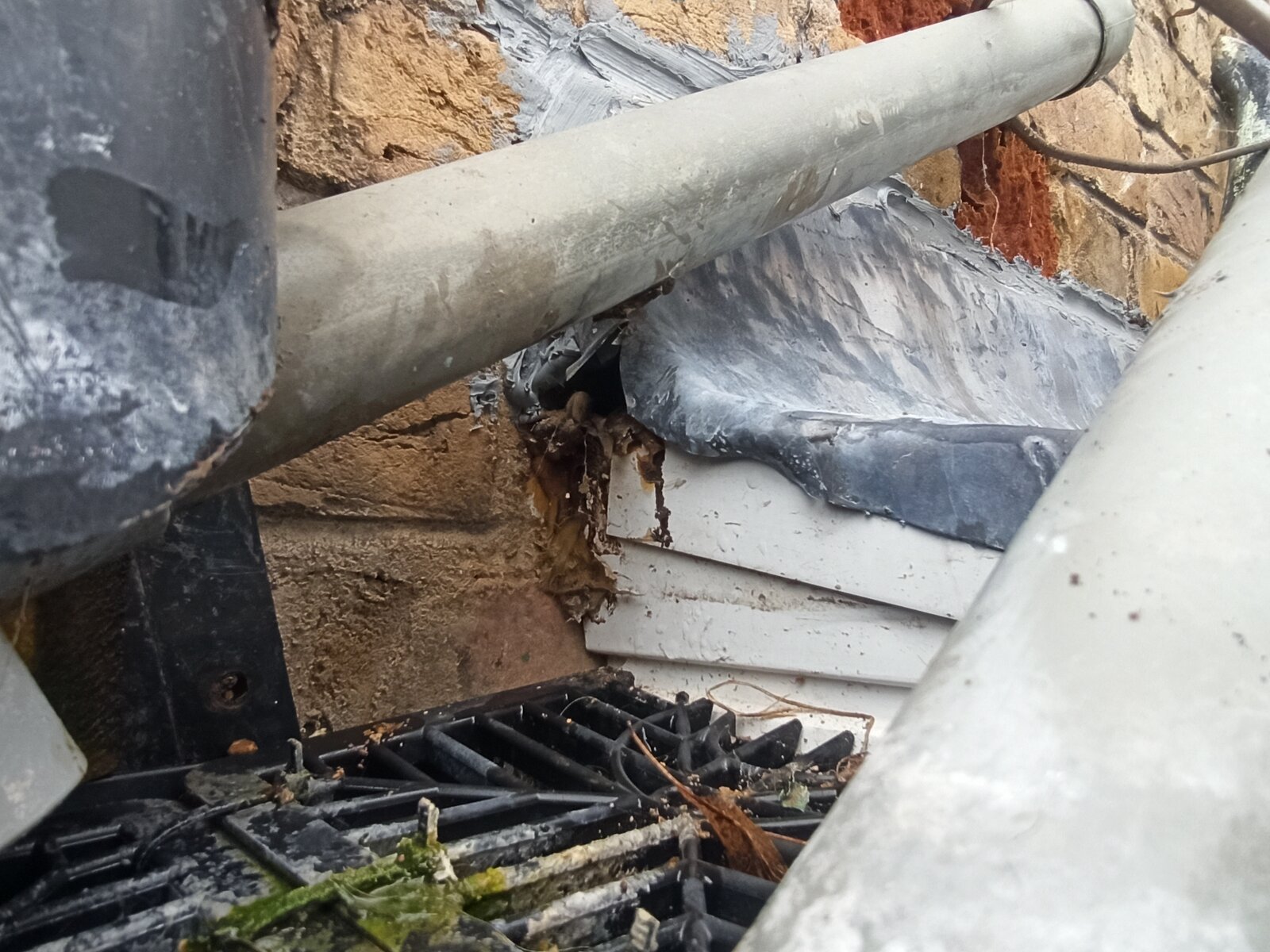

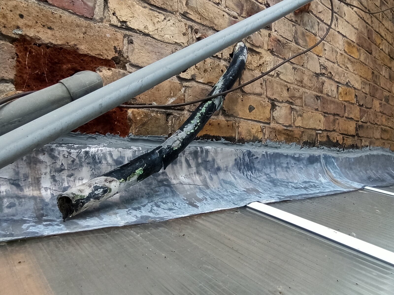

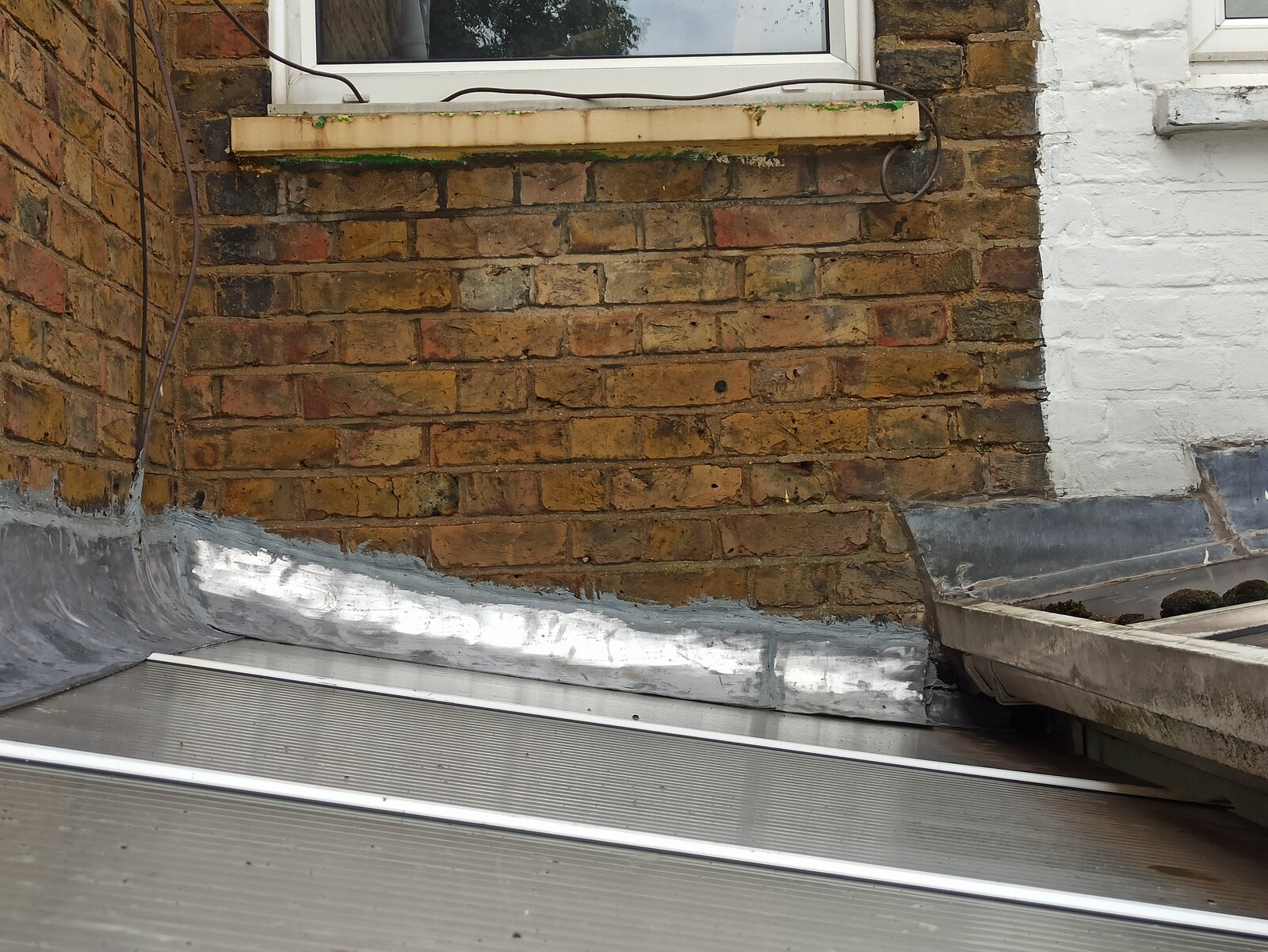

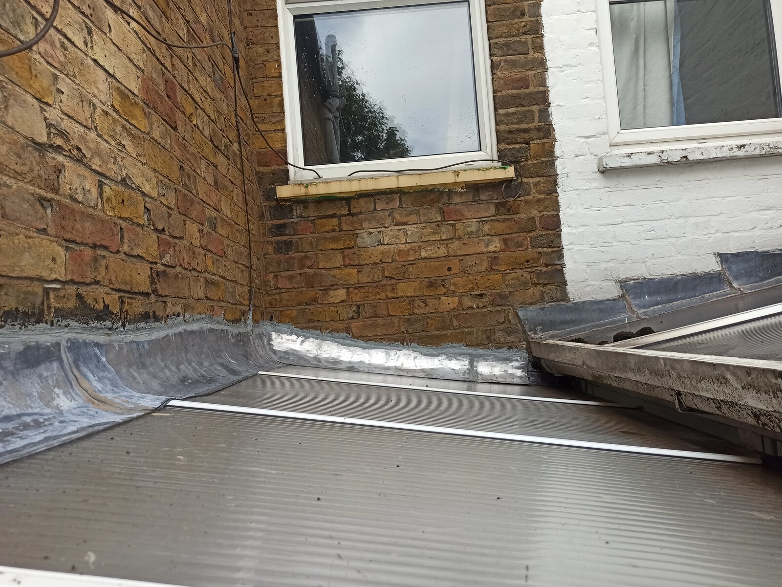

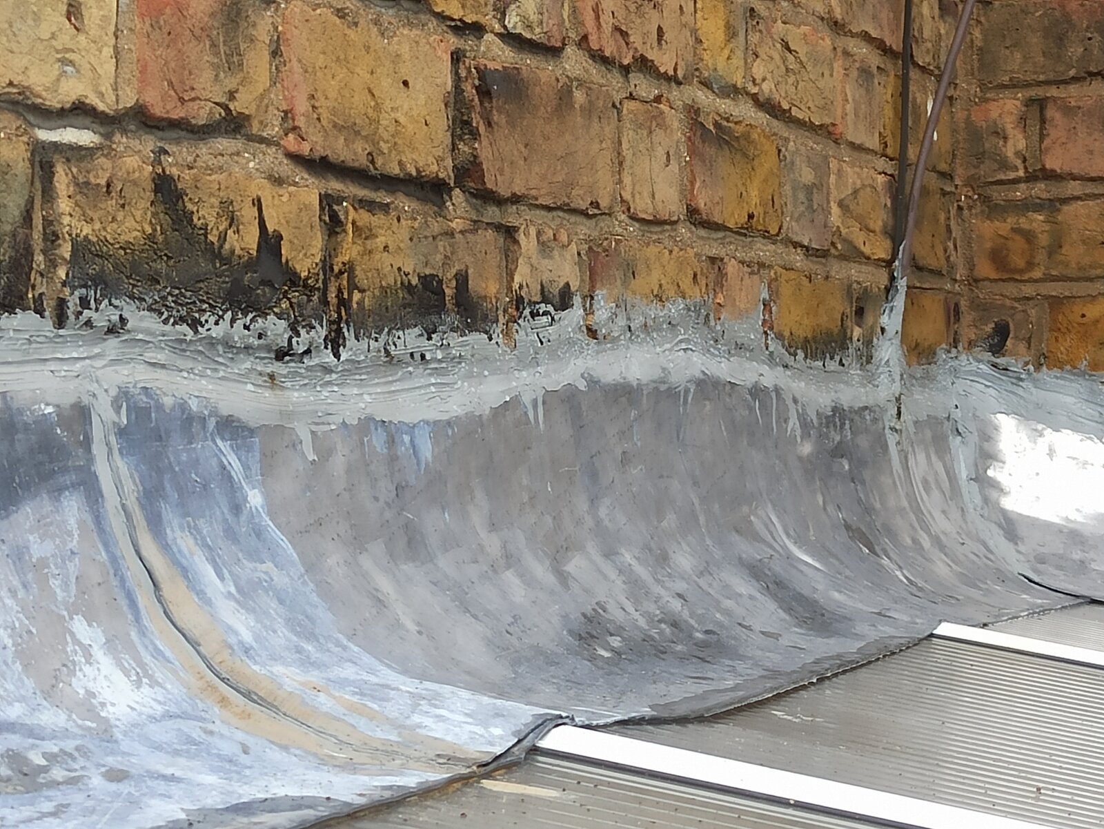

My Mums house has a little lean-to with a Poly-carbonate roof which had a Flashing Tape seal.
We hired a roofer to fit Lead flashing, this is the result, it's obviously messy, but I'm not sure it's even chased into the wall properly, the pitched part isn't stepped in, and there's a hole at one end but the guttering.
Am I being harsh ??, it looks bodged to me.

Well the law is that you have to give them the chance to rectify but anyone would sympathise with any reluctance to do so. Let's face it, it's an appalling excuse of a job.

Goodness, embarrassingly bad.
The neighbours conservatory looks like it is over the boundary?
