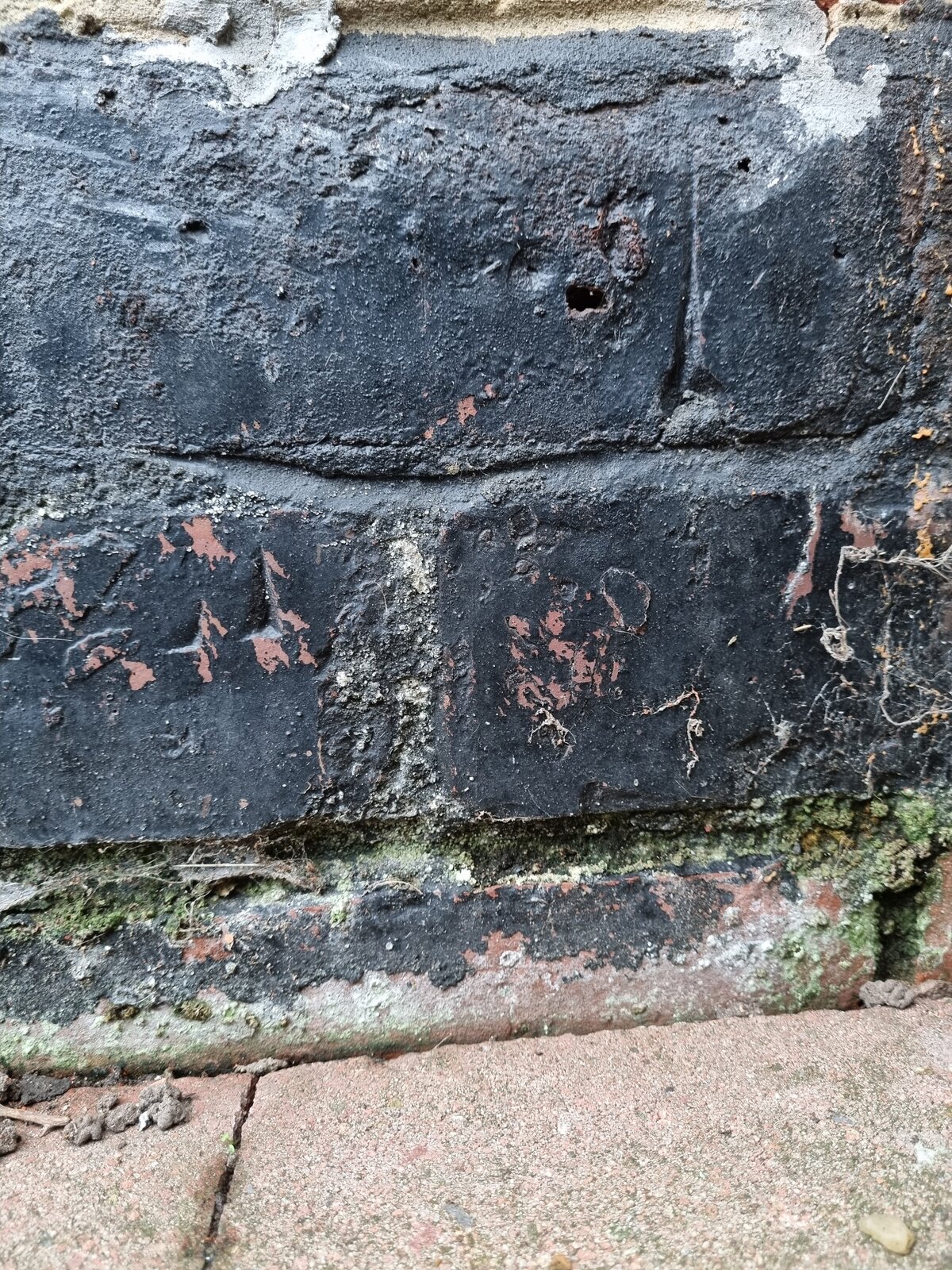

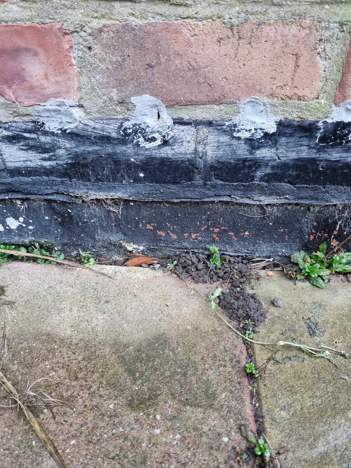

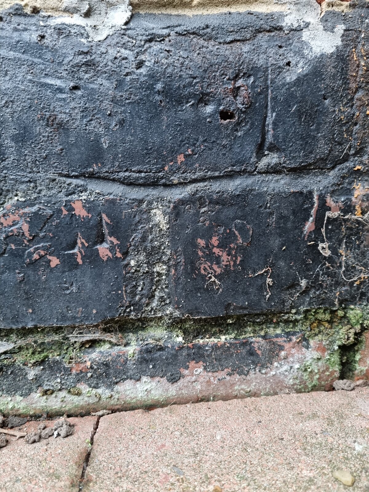

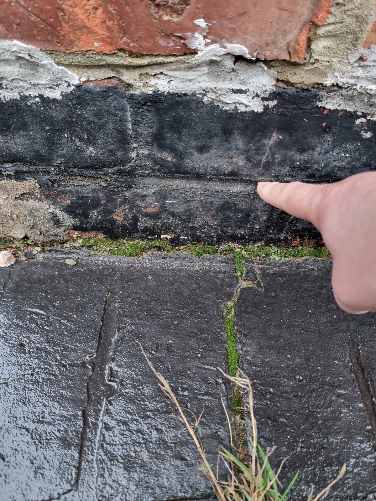

I think i found the DPCView attachment 327096View attachment 327097View attachment 327098
Looks to be really close to the floor as you mentioned.
how far were these previous sink leaks from your damp patch?
can you mark your pics to highlight where the dpc is

On the images of the brick work, the DPC is 1 course lower then the grey injection circles.

how far above paving level is the dpc?

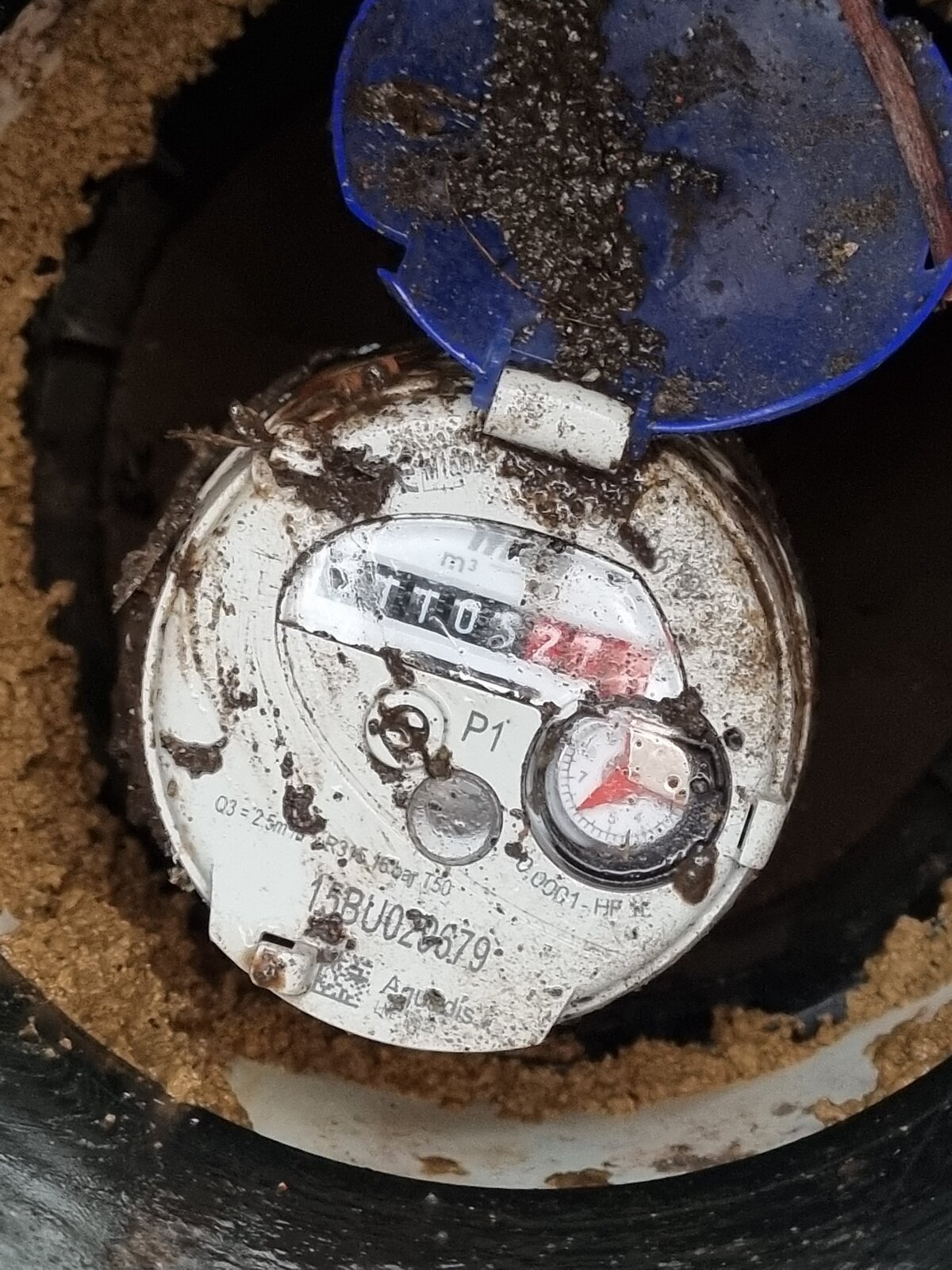

you mentioned a water meter. Is there a bubble under the glass, and does it ever stop moving?
The paving in that area is 1/2 a brick to a full brick below the DPC.

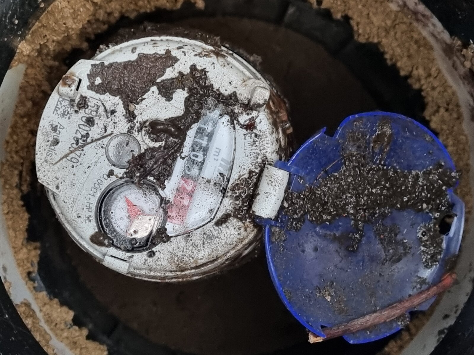

I think the water meter is out the front of the house. Its not something i have access to.
You can pry the lid of the meter open and look at it.
A teaspoon handle often works, or a very large screwdriver. You will also need a torch
These are the best images i could get.
Not too sure what im looking for
Rub the glass clean and see if there is an air bubble under it. If so, it turns all the time water is passing through, which helps confirm (or not) a leak.
Hi John.
I watched the meter for 10 mins and it didnt move.

Printed concrete path/drive looks high from what I can see and will trap water against wall, not to mention any damage that may have been caused when installed.
