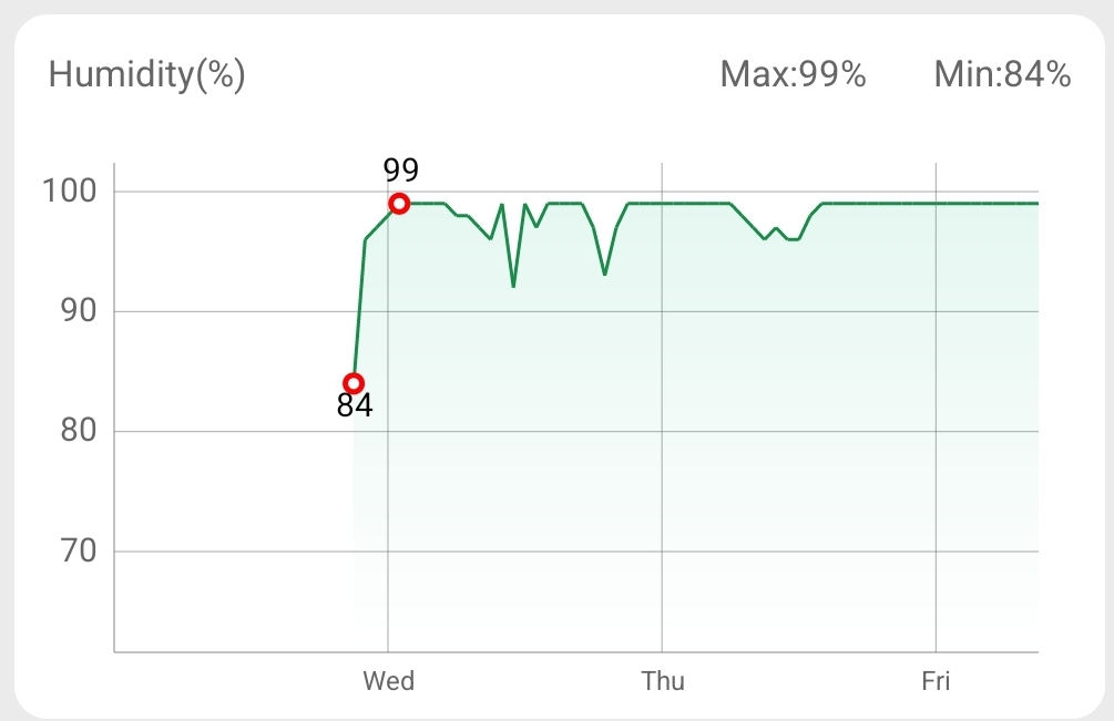

I think the PIV in the loft space is been hindered by clogged filters.
I had some work done up there that produced an insane amount of dust about a year back.
Id intended to leave the dust to settle and then change the filter, but never got roound to changing it. (My bad)
Ill get some ordered and crank it up so its working double time and see if this reduces the humidity behind the unit which is currently at 92%.
We do open windows and use the fan when cooking, and we stopped drying clothes on the radiator a few years back.
When i bought the house, the old owner was obsessed with insulating the property and basically sealed up any points of ventilation.
The kitchen is quite an isolated case as other then the window been open there isnt any place for the moisture to escape without running the fan.
This been said, the battle for 'normal' RH levels will be long.
My plan is to take the current kitchen unit out and sit a dehumidifier in front of the wall for a time to help dry out the walls.
If sorting the PIV unit reduces the humidity levels behind there then great.
Ill start to address the external issues (if these are a compouding factor to the mould)
Would it be an idea to install an extractor fan behind there that is triggered by high humidity?
Or is this over kill
installed this sensor behind the unit mid week.
My plan is to install the new filters on the PIV in the loft, and crank it up a bit.
See if the affects the humidity behind there.
Failing that it looks like a vent or an extraction unit to the outside.
Both of the last two people who came to look at the brickwork suggested also a vent brick into the cavity on the corner too.
What effect would this have?
