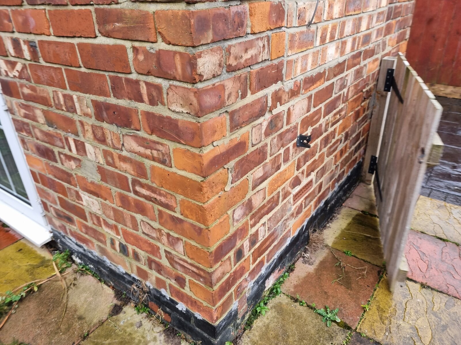

I can see moss growing at the base of the wall outside. That isn't caused by condensation.
There has clearly been long term damp because some idiot appears to have injected chemical into the joints directly above what appear to be impervious blue bricks, and let his child mortar them up with a teaspoon. That won't be for condensation.

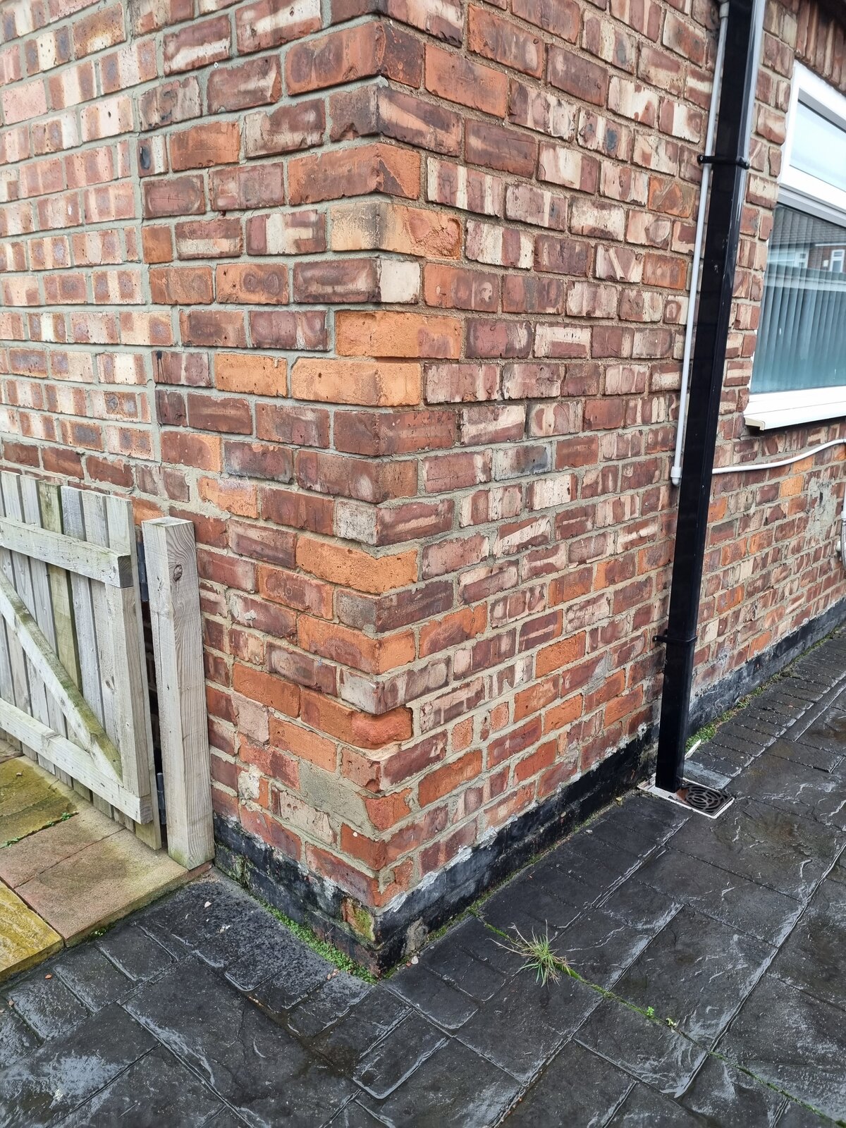

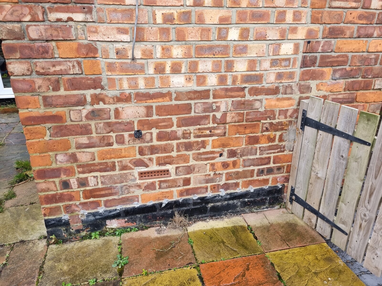

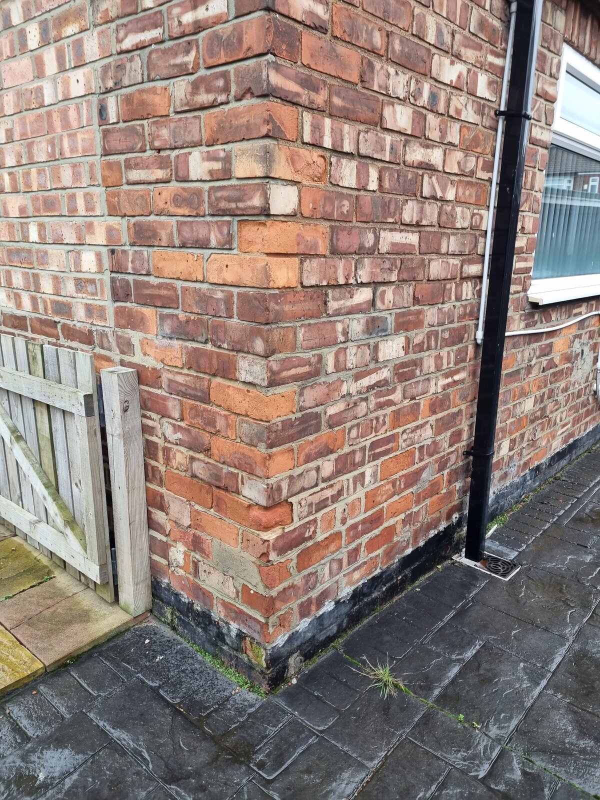

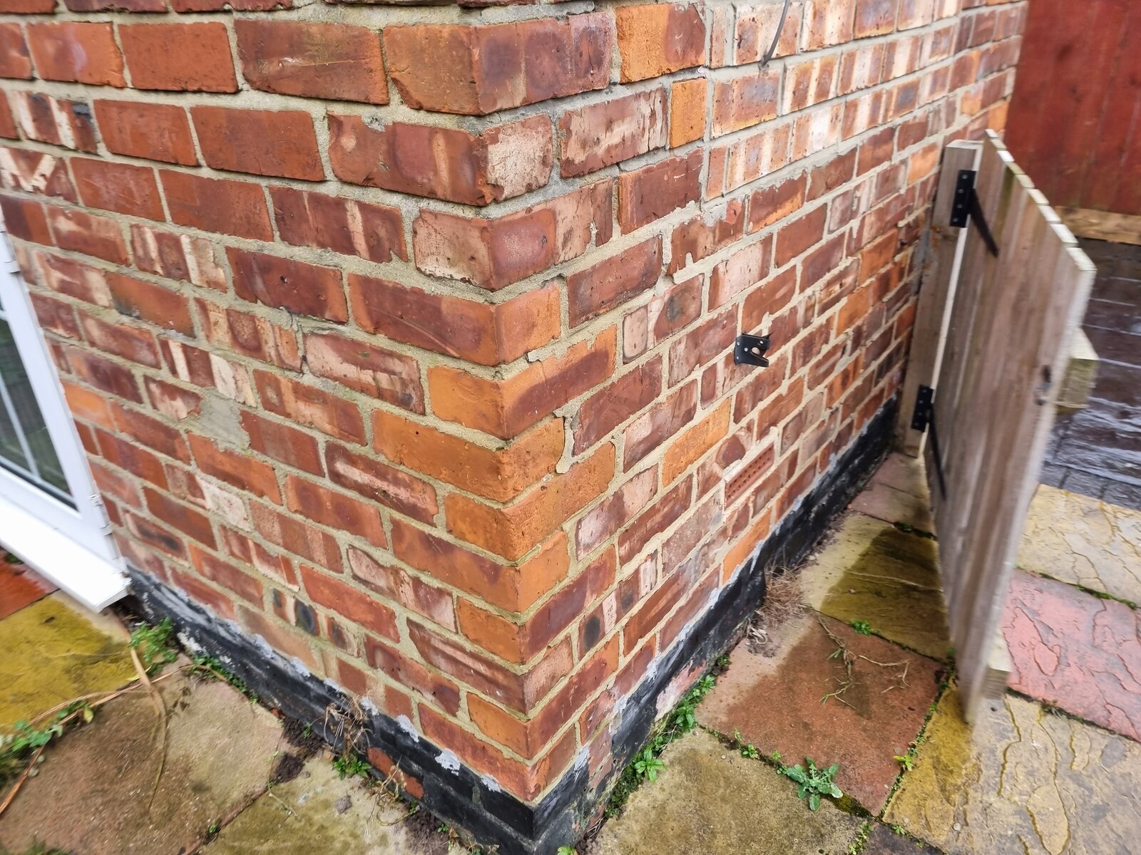

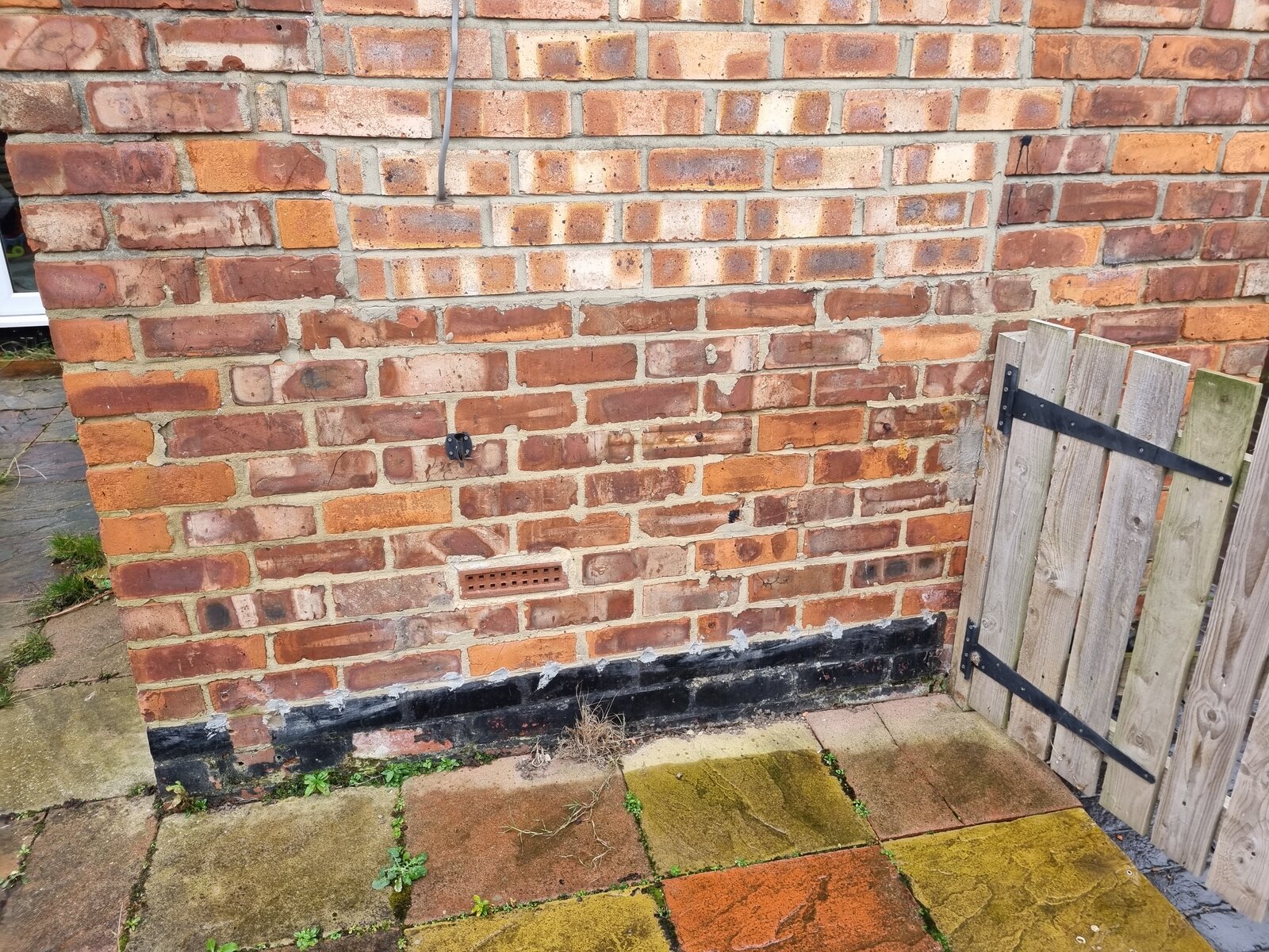

Right im back with images from outside, unfortunately it was raining.
In the image you can see the drainpipe, but ive looked in and it flows away from this corner.
I wouldnt know how to look for leaks in pipes or drainage that is under the driveway.
Any tips?
