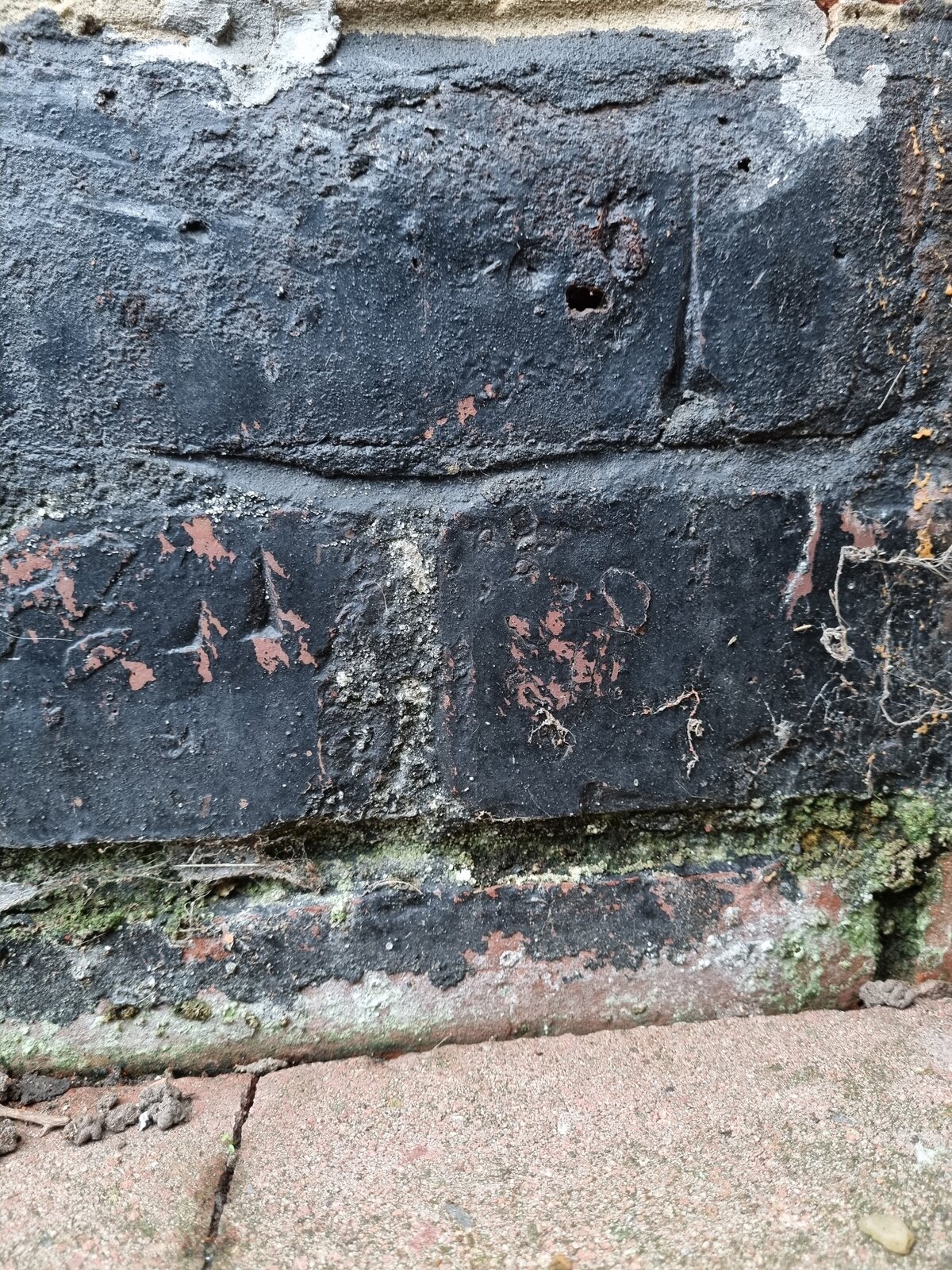

From the pictures, I now see that you do not have blue bricks, you have red bricks that have been painted black, probably with a bituminous paint, in a futile attempt to keep water out. In fact, because this prevents water evaporating off the bricks, it makes damp worse.

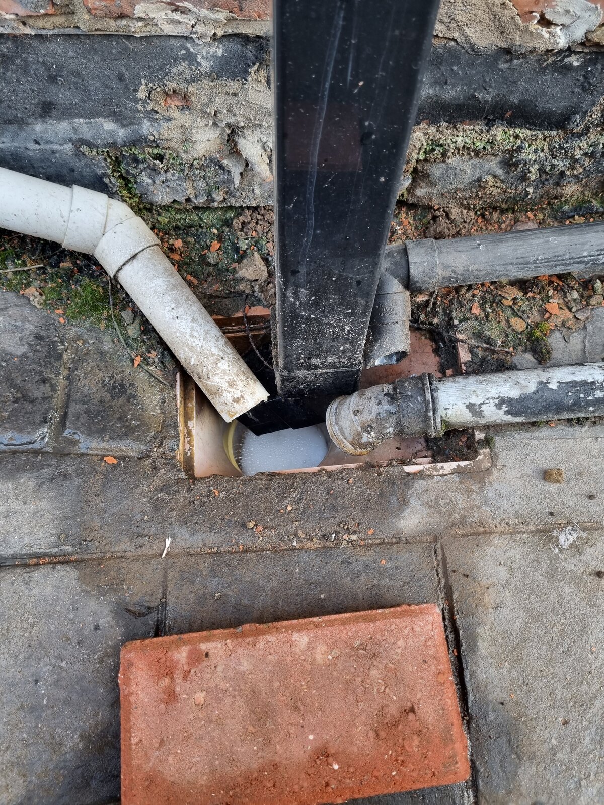

Please photograph the gullies and drains around the house, especially any signs that they have sunk or cracked, or are below the current paving level, and of lush plant growth around them. Photograph patches of moss or algae around the house.
Added to the evident futile attempts to reduce damp by injecting a chemical, which I see all along the wall, the house clearly has a long term damp problem. I do not agree that condensation is indicated, though it may be a secondary problem since you have damp.

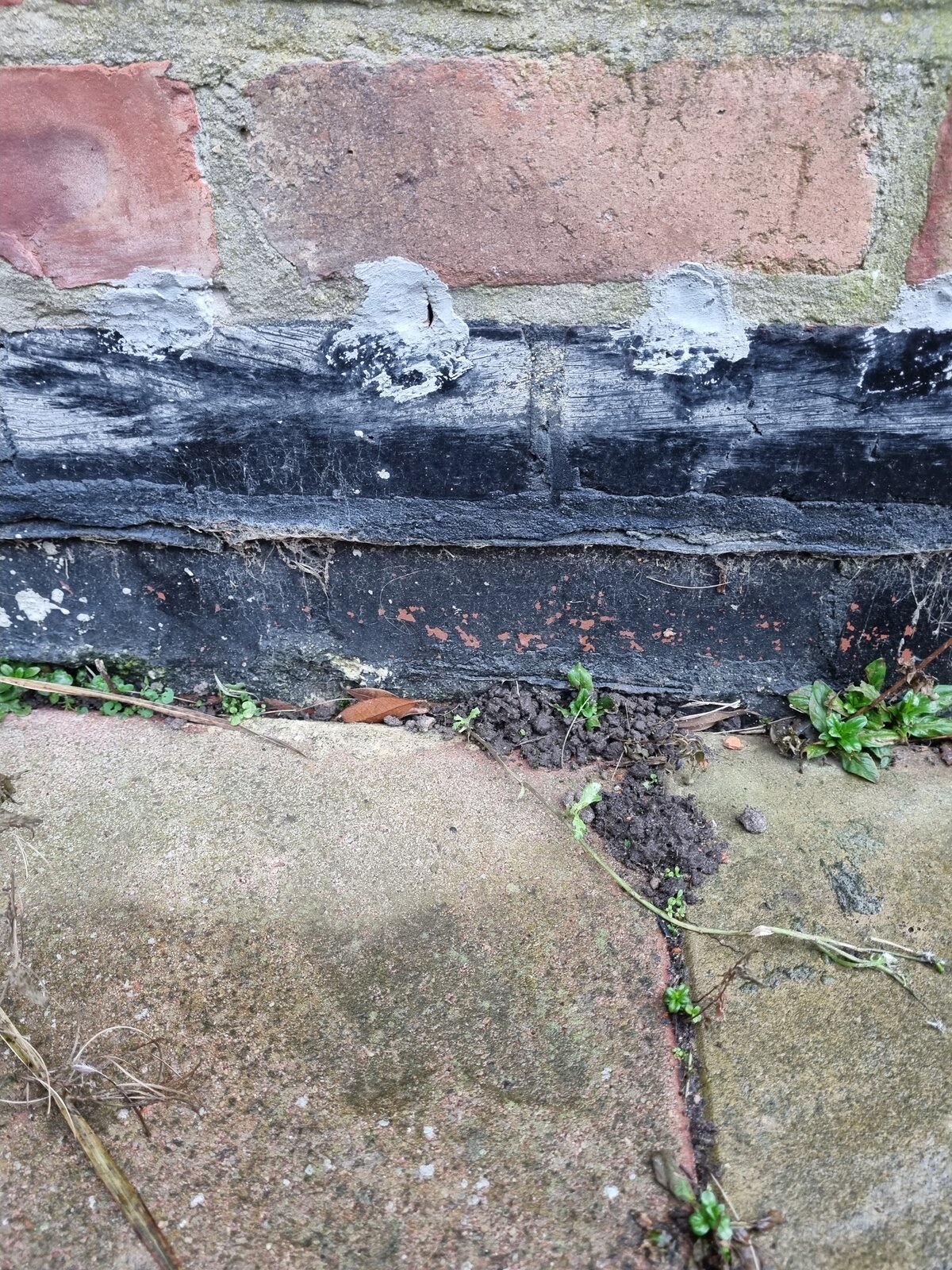

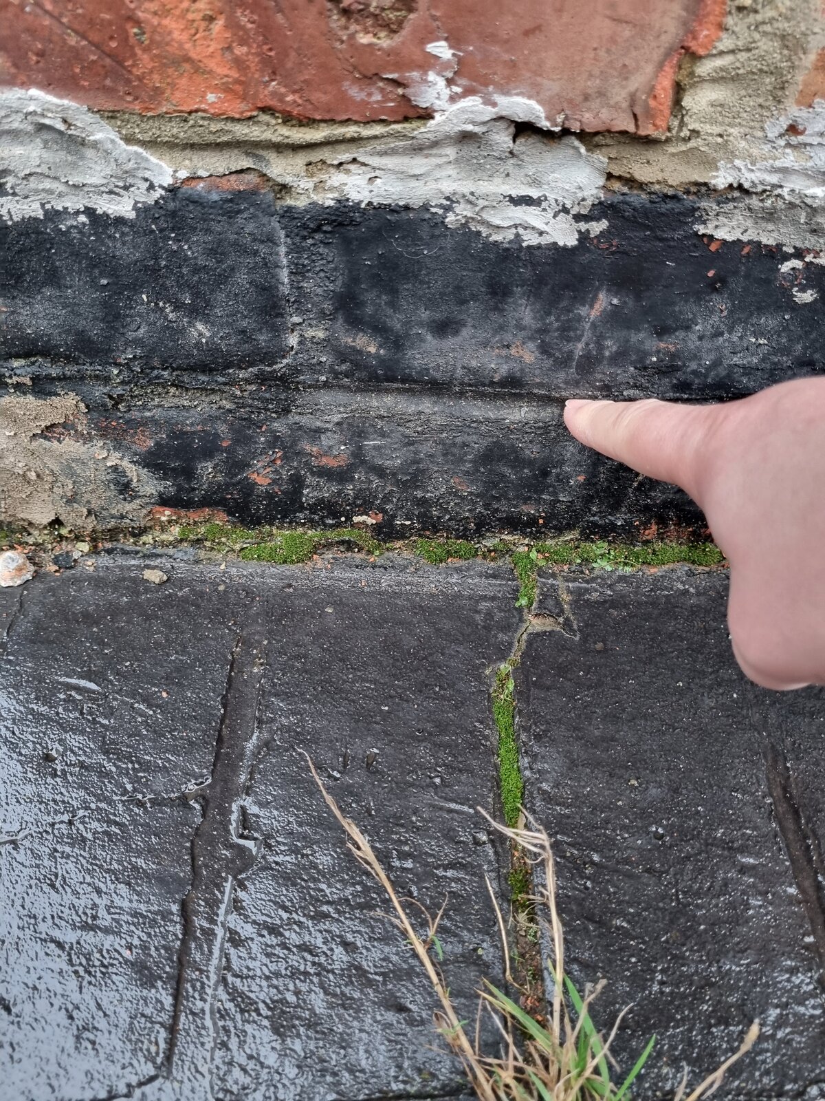

I think i found the DPC 20231230_151925.jpg20231230_151850.jpg20231230_151712.jpg
Looks to be really close to the floor as you mentioned.

I agree with this Its looking more like a leaking drain/gully to me rising up the bricks, someone may of attempted to stop it with injection.

Is there a test for leaking drains or gullys that doesnt involve digging up the driveway?
Show us the photos. It may be easy to spot.
You can also pay someone to poke a camera down it if you prefer.
There might also be a nearby manhole.

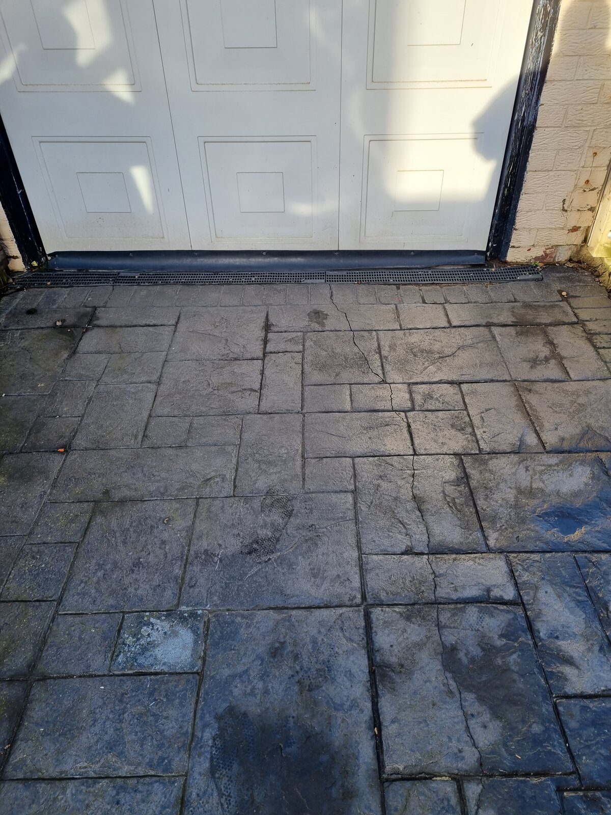

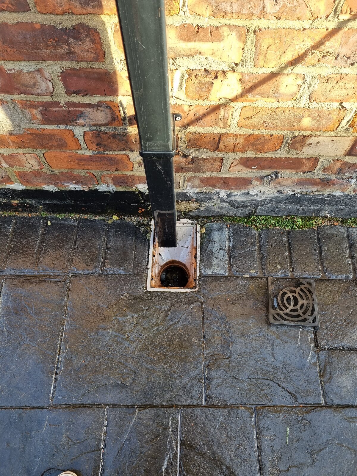

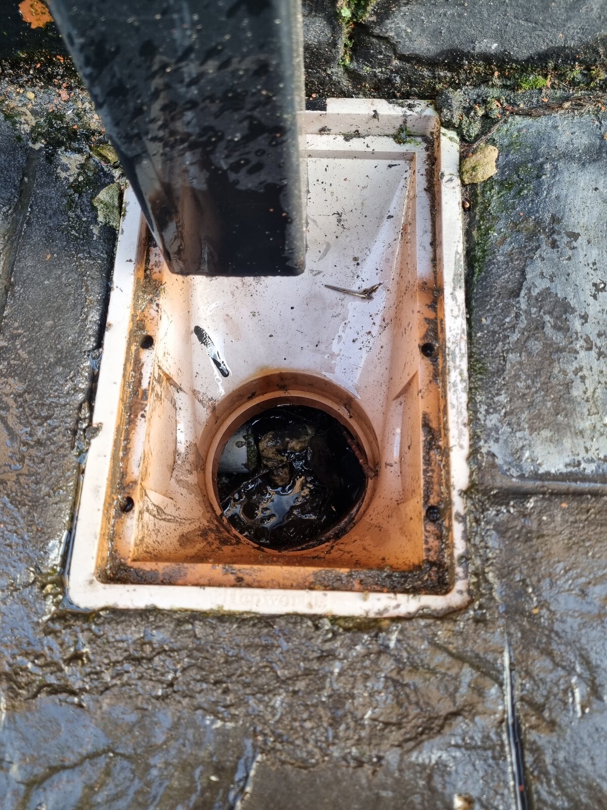

Ive been out and taken some images of the drain.
So it looks like the drain which is closest to the issue area has a pipe coming from a drainage area in front of the garage.
Ive taken the lids off for a better look.
The last image is the middle drain and is nowhere near the issue but i took the image anyways.
Garage
Drain nearest to issue
Drain at middle of house
That is pressed concrete faux slabs with a new plastic gully as they would of put that in at the time of the pressed slabs.
Hmmm thinking the fact that the drive is cracked would imply to me that they did a crap job of it which would get me thinking did they also do a crap job of connecting the new plastic setion they put in to the old origional pipe.
I had an idea of blocking the drain in the gully and then pouring a bucket of water into the garage bit, if it drains then its leaking right?
But would it have enough water to cause the damp since its just rain water?
