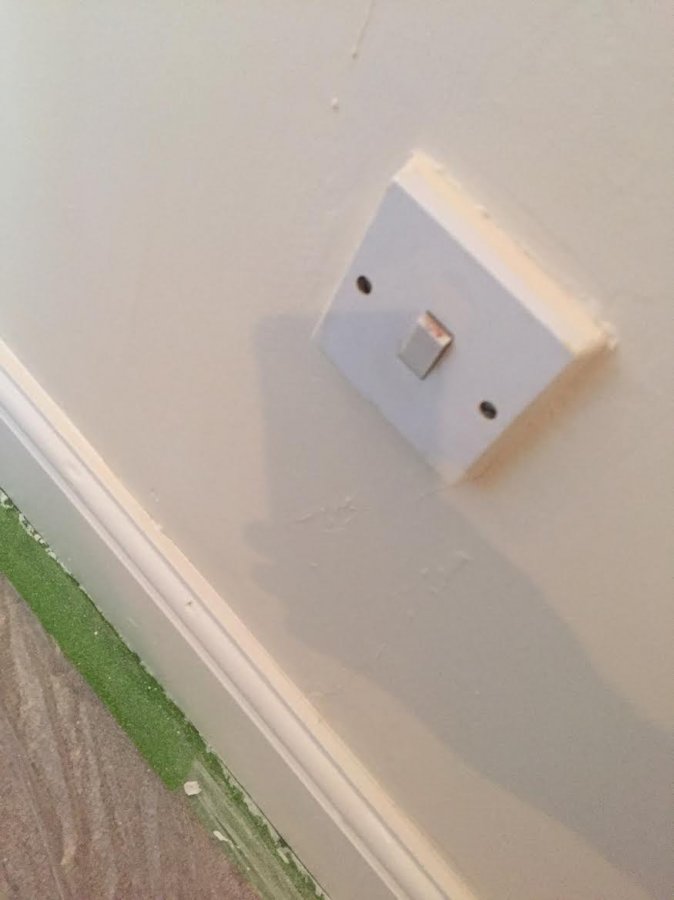

Hi there,
I'm in the process of replacing a load of mismatched light and electrical switches in our flat, but I'm a bit confused what one of them is. I have attached a photo - it looks like a lightswitch, but has 'on' printed on it, which makes me think it is some other type.
Usually I've seen these with fuses on, but this one doesn't.
I'm guessing it's some sort of isolator switch, but any help would be appreciated.
A picture of the wiring of switch/isolator would be helpful.
As this could be a standard light switch or a two pole isolator. Likely the latter (edited).
Is the top of the switch marked by colour or on?

Top is marked by 'on' in red text - not colour. I thought a lightswitch, but the text on it makes me think it's something else.

I think far more likely the latter - it has "ON" engraved on the rocker, and it's quite chunky.
Steve - did the flat used to have storage heaters?
Is there a hole for a flex on the bottom edge?
A quick look at the wiring should tell you if anything is connected to it...
It's almost certainly a double pole switch. Probably for a storage heater or other electric heater at one time.

Almost certainly a 20A isolator then. It could be redundant, as already pointed out and used for wall heaters. But could quite possibly be serving some other electrical equipment! A look inside would be helpful and advise you do turn the electric off at the mains before you proceed in the investigation.
Thanks everyone. The flat does have storage heaters - there are a couple of other 20A isolators in the room too (not sure if that's a good or a bad thing!), but they're marked as 'isolator switch' - so were pretty obvious. This one looked different/odd, so I wasn't sure.
