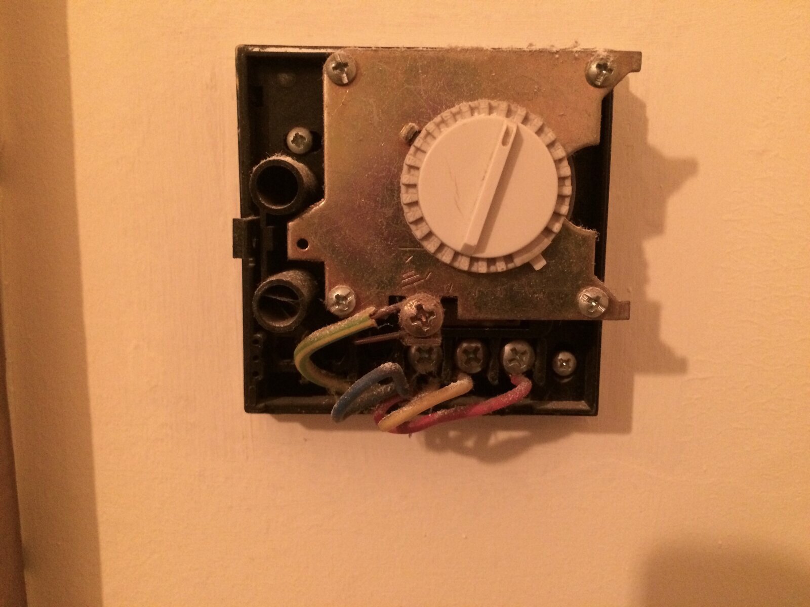

The front was on properly. I'm pretty sure because it took me 5 mins to take it apart so that I could remove the whole stat from the wall.
Do I have to program the new stat in any way? I'm asking because I didn't do anything like that. Just popped it on the wall and turned it on.

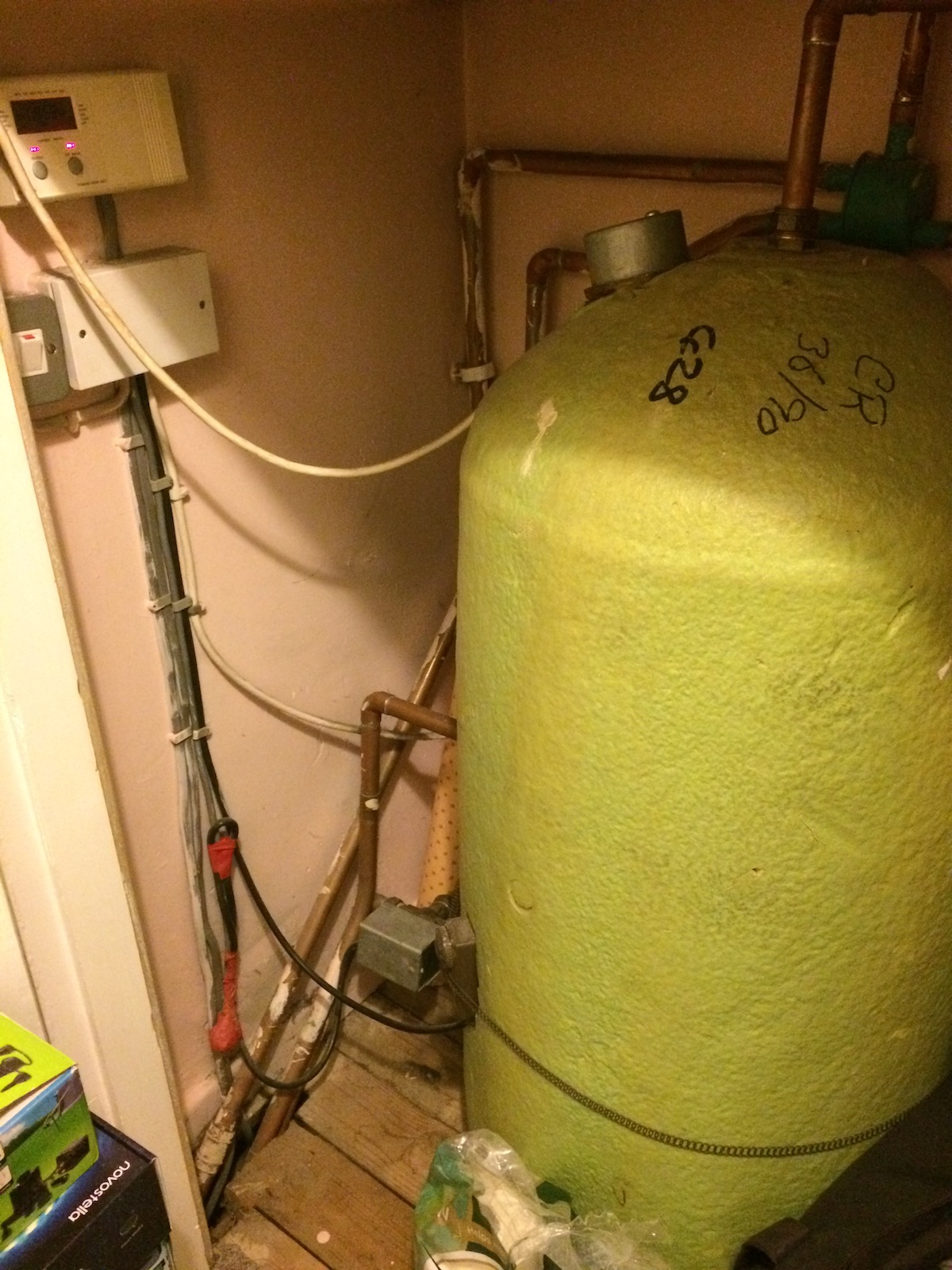

I forgot to mention that I don't have a combi boiler. I have a really old boiler. Is it possible that it uses the mains voltage switching? This is the tank in the airing cupboard.
Do you have any test equipment? A multimeter or 2 pole voltage tester?

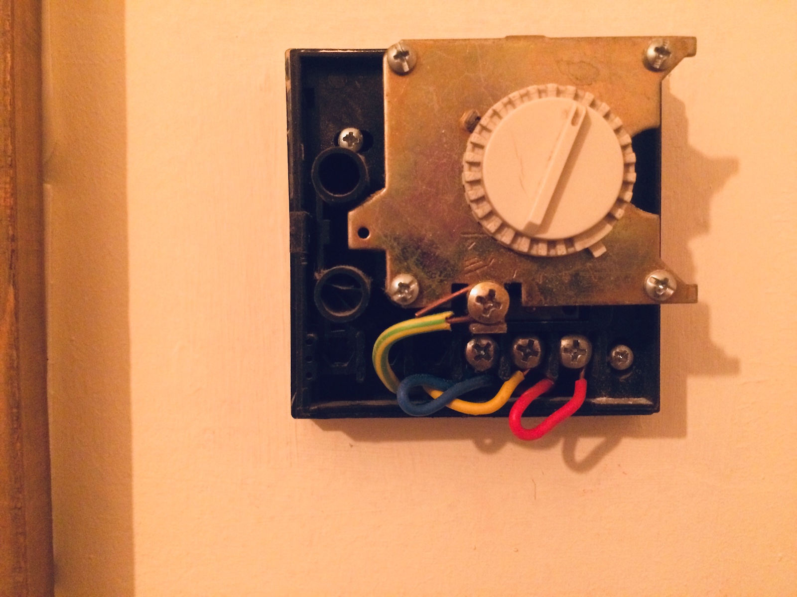

really ? the blue is not connected to anything ?

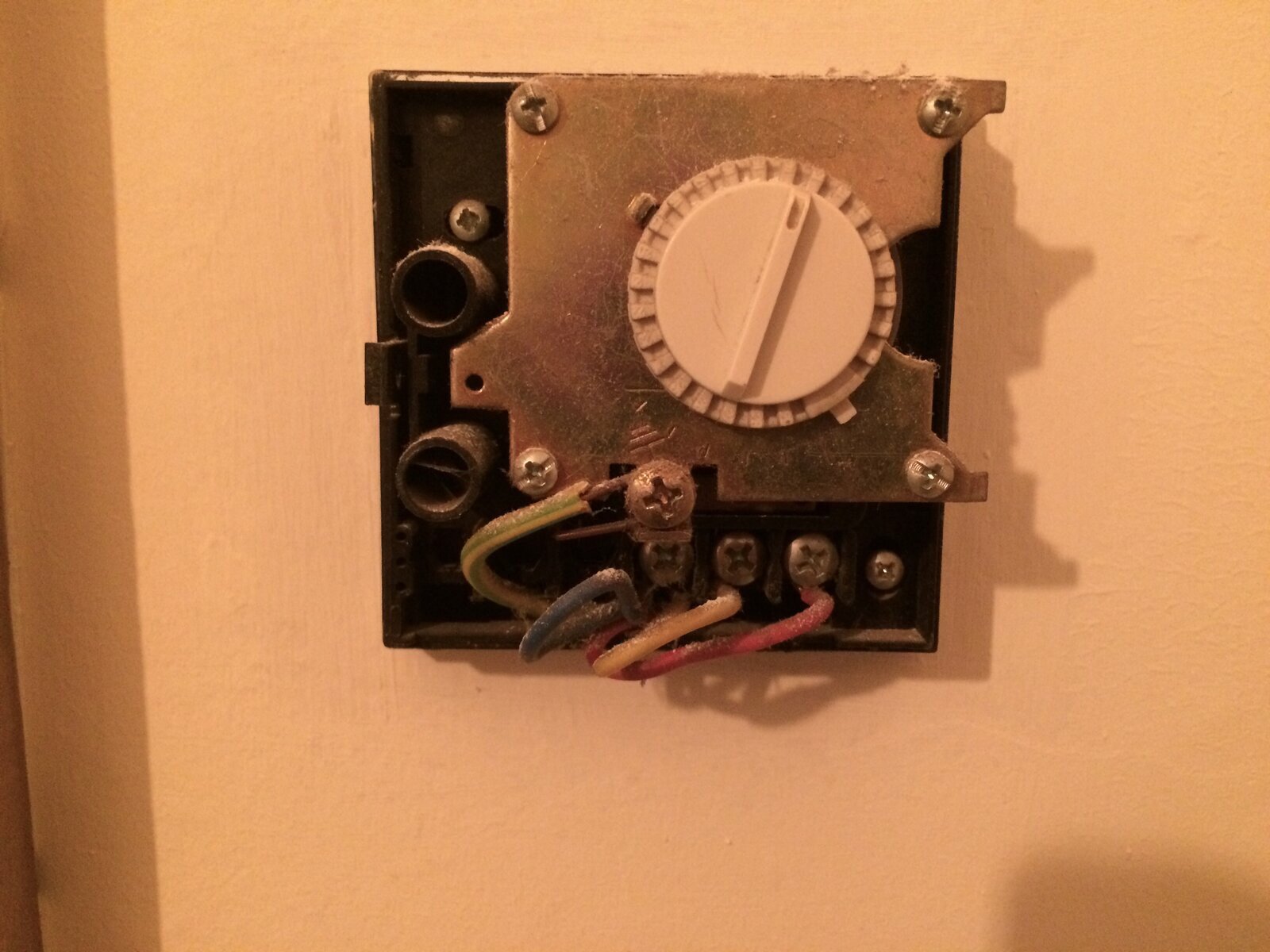

It wasn’t the best photo (very 1st post) where there’s 3 wires poking through. So could it be that the blue wire is the switch?
So, the way I connect the wires to the new stat is: red to A, blue to B and if boiler still doesn't fire up try yellow to C?
