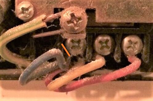

Well yes that is much clearer. In the old picture it looked like yellow was going to 2 and blue wasn't connected.
So red A and blue to B and yellow to C.
As D_Hailsham suggested.
really ? the blue is not connected to anything ?
Oh yes it is! Follow the orange line down. In any case, the label says that T2 breaks on rise, so it must be the switched live
