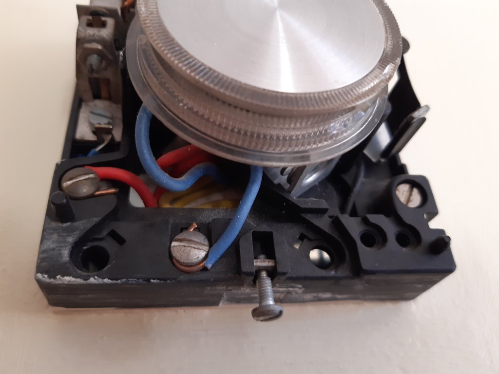

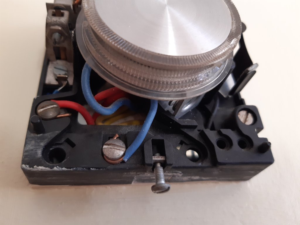

Is there anyone out there who could help solving a problem with my central heating system ?
The system consists of a boiler which produces hot water and warm air. The hot water is working fine but no air (warm or otherwise) is coming out of the vents and it seems that the fan is not working.
The Satchwell 2251 room thermostat is a possible cause and I am wondering if there is a simple wiring test which will show whether it is at fault.
I attach a photo of the thermostat wiring.
Any help appreciated.

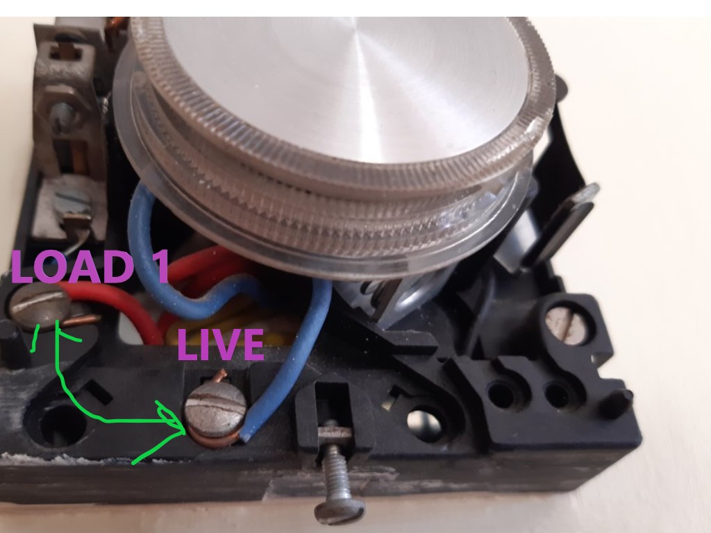

If those wires are in terminals 1 & 3, I'm pretty sure they are, but check first by consulting the diagram that is printed on the terminal cover you have removed. If that is the case, and you can do it safely, then you can simply join the two wires together. If the heating comes on then, the thermostat is faulty, if it doesn't you are barking up the wrong tree.
If it does work, don't leave it like that as there will not be any thermostatic control of your heating and it will just get hotter and hotter,

Wired the red and blue cables together as advised. Still nothing from the fan. So I assume this puts the thermostat in the clear.
Anyone know of any other simple tests I can try to identify the fault ? If not I will call in an expert.
