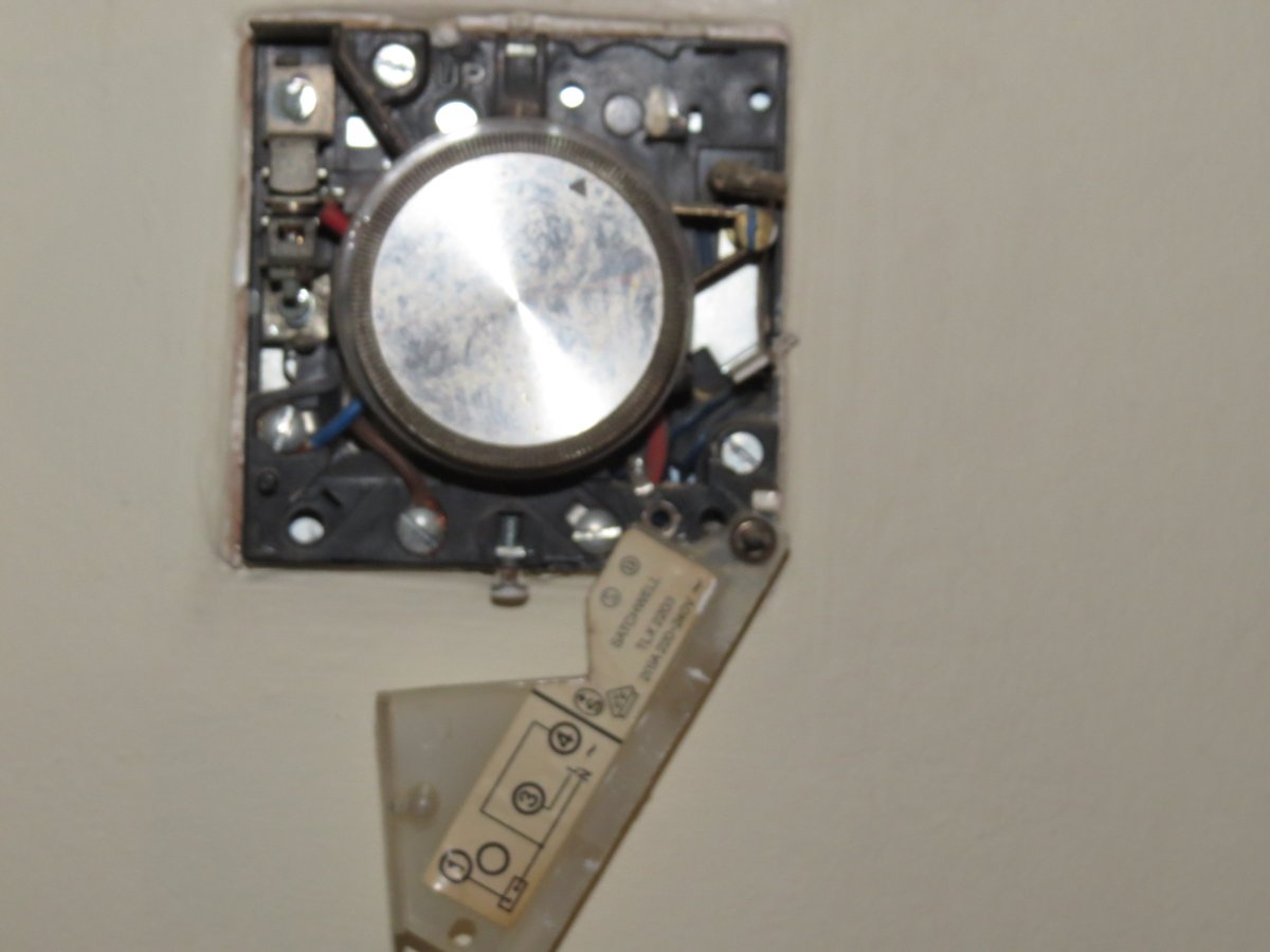

Hi,
I need some advice please.

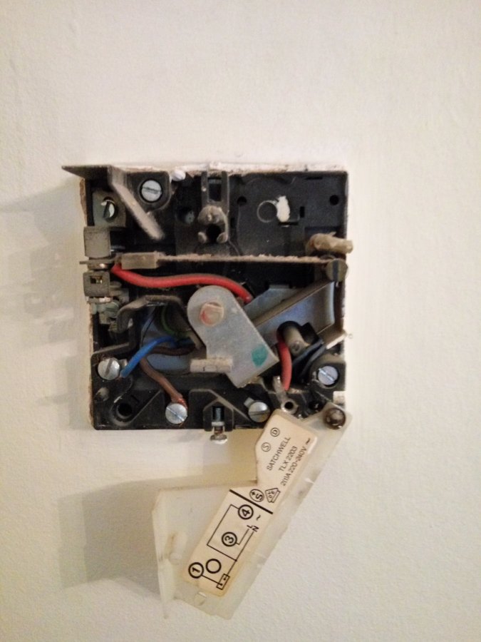

I am currently redecorating the lounge and have decided that our old Satchwell TLX 2203 thermostat looks a bit old and tired for the room. I just want to get a nice white, more modern looking one. I have never changed a thermostat before and the wiring of the Satchwell confused me. I gather from looking at it that 1=N / 3=L . Is the red wire on the right part of the stat or the wiring in? Is this therefore a 2 wire thermostat?
I was looking at the Honeywell T6360B http://www.screwfix.com/p/honeywell-t6360b-room-thermostat/26159?_requestid=321586 as a replacement - (This says 3 wire installation though so not sure if suitable..)
http://www.honeywelluk.com/Documents/Installation-Guide/pdf/1151.pdf
I dont want to spend a fortune but want a nice, white modern looking one that isnt as big and 'dated' as the Satchwell.
If it makes a difference, my boiler is an oil fired Worcester Danesmoor 20/25 and the heating programmer is a Potterton EP3001. The boiler only provides heating - not hot water.
If not suitable, can you please suggest an alternative that will work.
Sorry if these are daft questions but i like to know what im doing and what will work before i start.
Any help would be much appreciated,
Thanks in advance....
Need to see under that knob on the front. The knob will just pull off.
There may be a third wire/terminal there.
Turn the power off to the boiler before putting your fingers in there.
