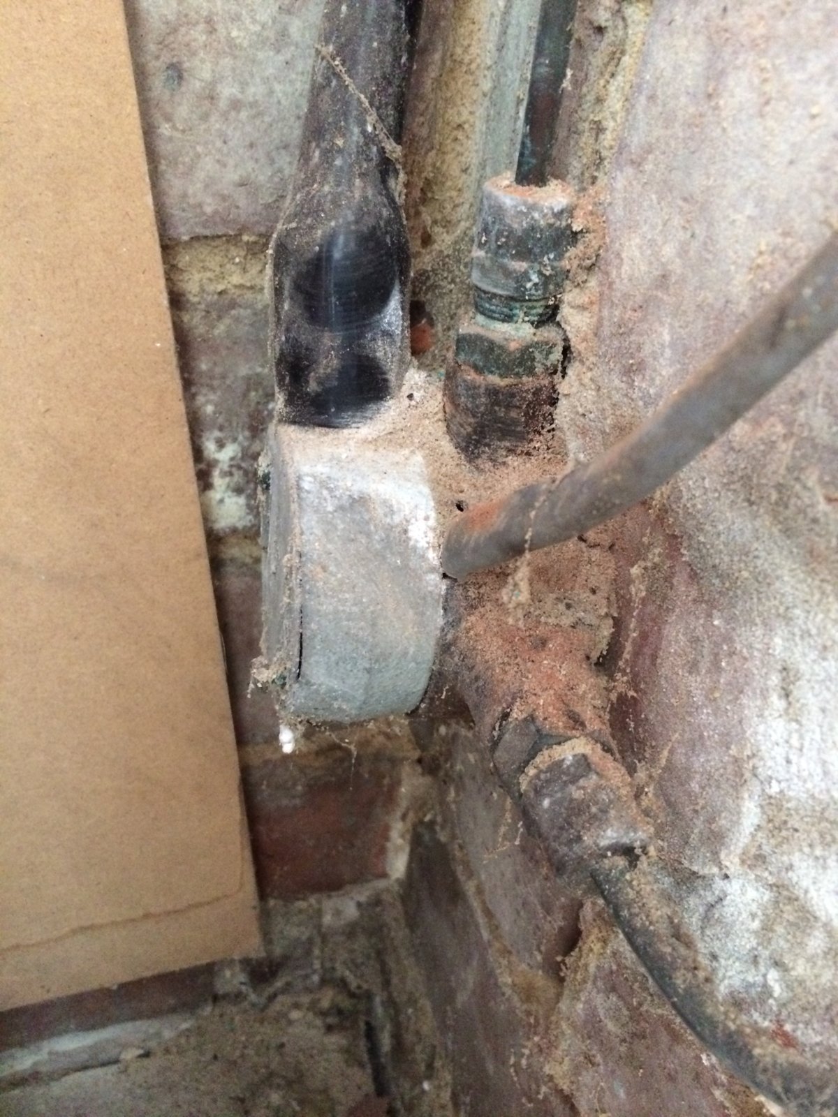

Hi,
I have a strange hybrid fitting which I can’t identify. It’s on the inside of my garage and there’s an SWA cable entering it from outside the building. There’s a 2.5mm cable (or a bit heavier) exiting the fitting and feeds a power and lighting circuit. Lastly, and here’s where it gets strange, there’s what looks like metal brake pipe running from it to what looks like an old light fitting and another running out and down into the driveway. There are two old driveway lights but they don’t work.
Here’s a picture - does anyone have an idea? The metal pipes look too thin to contain cables...
Thanks :)
They are MICC cable by the looks of it, might still be live, the whole shebang looks a bodge
Thanks for the quick replies - I’ve never heard of MICC before. I’ll check it out to see if it’s live but I take it that it’s best to have it removed/replaces then?
Well, not just for the sake of it - but if you want to alter anything, you may as well as it'll be a job to find anyone to do it these days.
it's a type of cable that is not suitable for amateur work (nor for inexperienced professionals), it needs extra tools and skills. Once opened to the air, the insulating material absorbs moisture and crumbles.
MICC, or Pyro, is great cable if you know how to work with it. If you do not know how to work with don't try. If it is in place and properly installed it should still be fine.
Yup, certainly looks like MICC (aka Pyro, being short for Pyrotenax which is one established brand). The fitting itself looks like two stacked conduit boxes.
If it's where you want it, and it's intact (see comments about how it needs to be terminated properly or it gets moisture in it and fails), then leave it - it's one of the best cables around. Smaller than other cable types for a given capacity, and apart from physical damage (holes in the sheath let moisture in) is as near to indestructible as you'll get - there's a reason it used to be "the" cable used for fire alarm systems.
