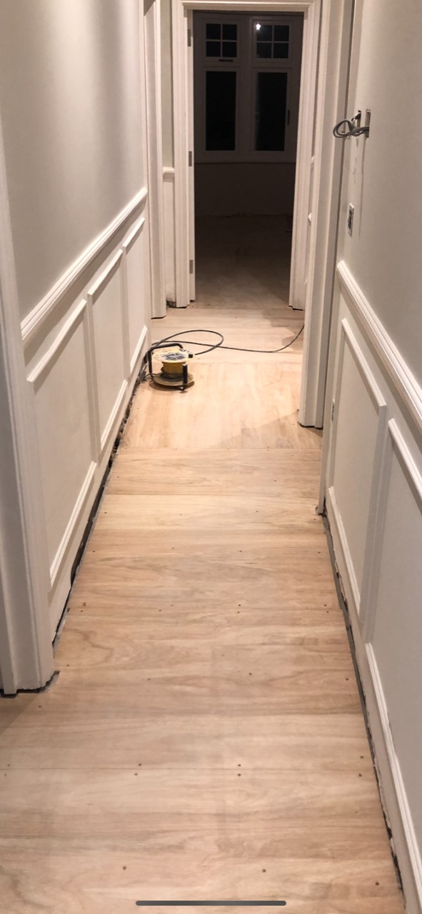

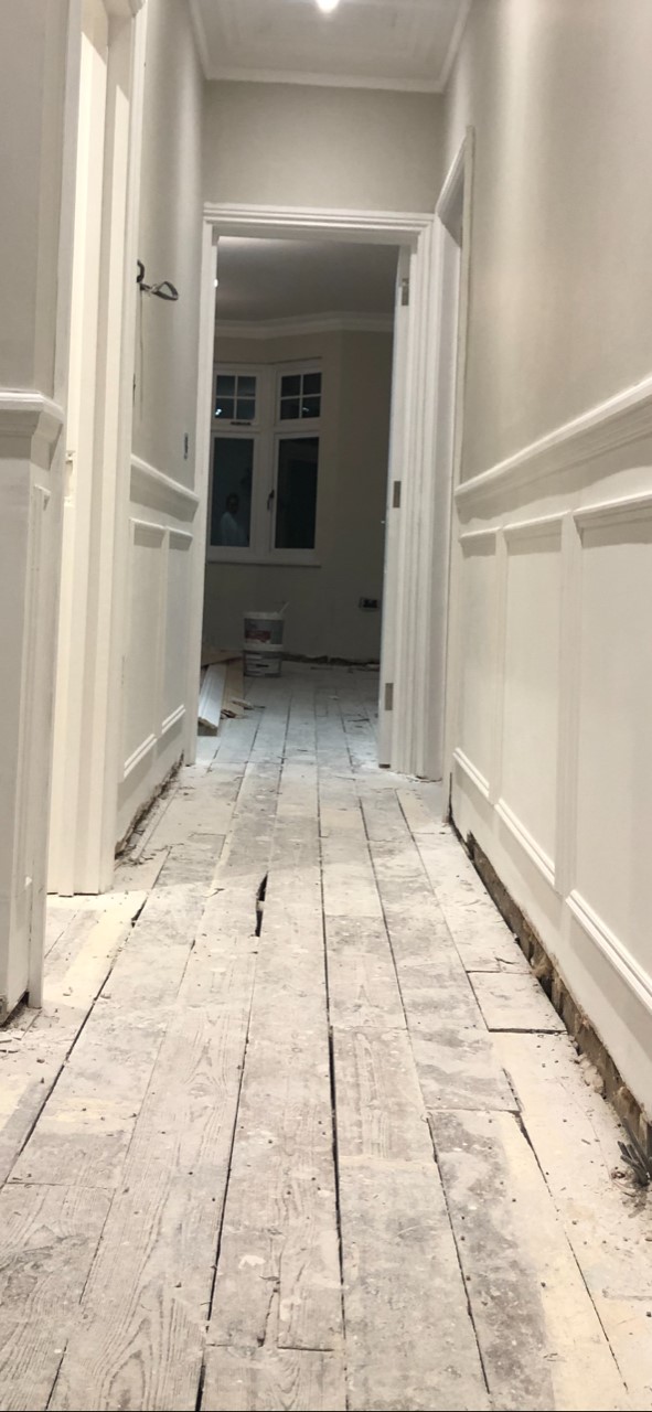

Hi everyone, hoping you can give me some advice on my issue. I have recently refurbished my first floor flat and replaced the flooring from carpets to engineered flooring throughout. Since the floor has been laid and i have walked on it without shoes, i have noticed that the floor isnt level/flat in some areas as in it is noticable to me when walking on it that there are slight slopes. This was not something i noticed when everything was stripped back to the bare floorboards or even before anything was taken up. I had some plumbing pipes ran under the floorboards, these were nailed back down, i had 12mm ply laid and nailed over the floorboards and then the 14mm engineered floor glued down.
You can see from the attached pictures the process and the final finish shows that there are gaps below the skirting which are likely due to the eneven floor.
My question is, what options do I have to try and resolve this section of the hall that has a slope that goes down and up over a distance of 1.5/2 metres.

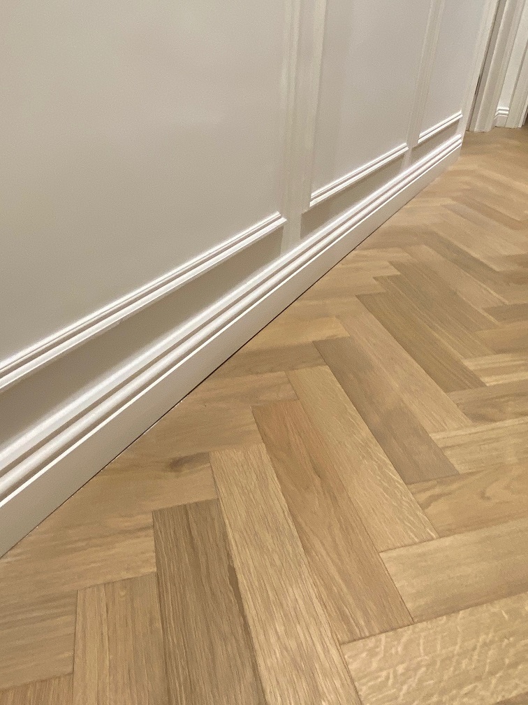

Thanks again. Would you have any suggestions relating to the gap between the skirting and flooring? I have read that caulk maybe an option?
have you put a level on the floor and seen how much it is out
Looks good, i would not want to take it up, just because of a small gap in the skirting, noone will notice i'm sure. And you will get used to it over time.
the gap looks very small under the skirting , and a good fit front and back over the length
or are we missing something in the photo
How much of a gap are we talking about, only looks a few mm

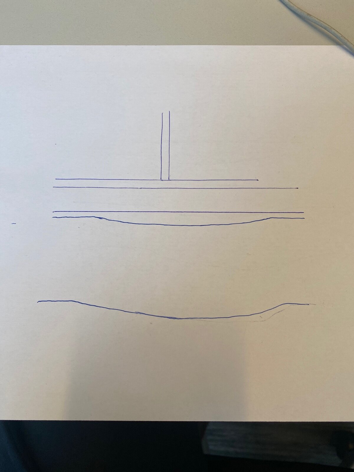

I am happy with the look however not happy with how the floor and dips feel on the feet. I've attached a picture to give an idea the slops that exist.
I've read that maybe self levelling compound can be used?

i'm just a DIYer so i'm sure the pros will answer, but i would not think screeding floorboards would be a good idea, but searching appears you can get self leveling screed for floorboards
https://ardex.co.uk/product/ardex-fa-20/
not sure what thickness that would go to, states 3mm , so would expect 3mm to 6mm + 6mm ply = your 12mm may be OK - as it can be used on wood, maybe replace the 12mm ply with thinner stuff and screed perhaps 6mm ply primed and then approx 6mm of screen which will be thinner in some areas to level out you slopes- BUT NO IDEA of the best method of doing that.
BUT NO EXPERT - So i would suggest you need to wait for a pro reply
