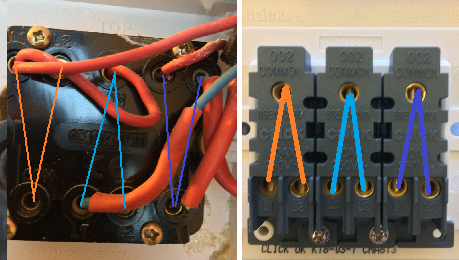

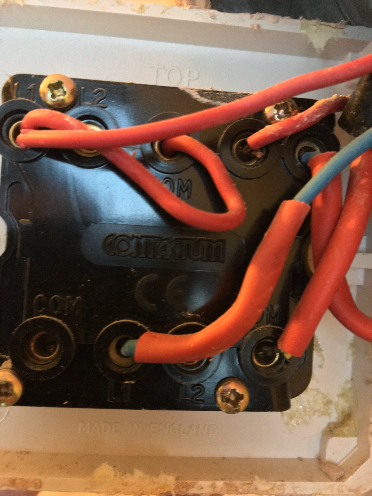

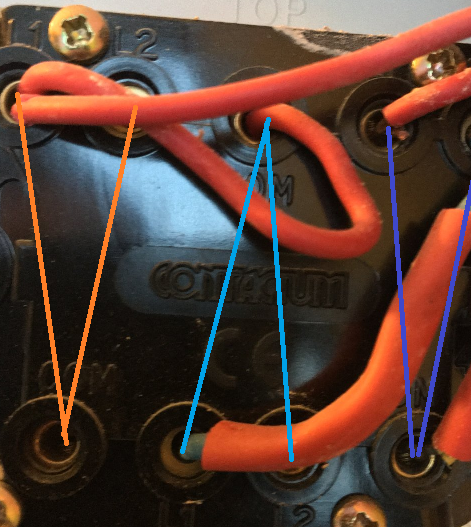

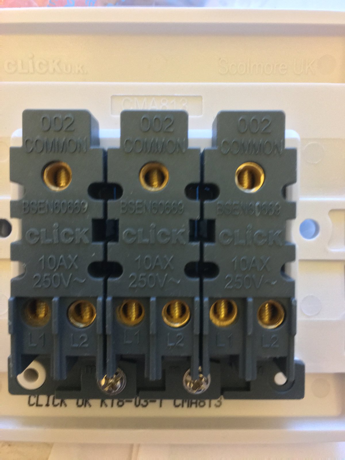

So I’m trying to change a triple light switch and the old one’s connections are not like the new one. Can anyone help by letting me know what to put where? (See pics) Thanks, Andy.

Thanks for the reply and the diagram. It does turn on the outside light, the other two turn on 2 lights in the hall. I’ll have a crack at it tomorrow

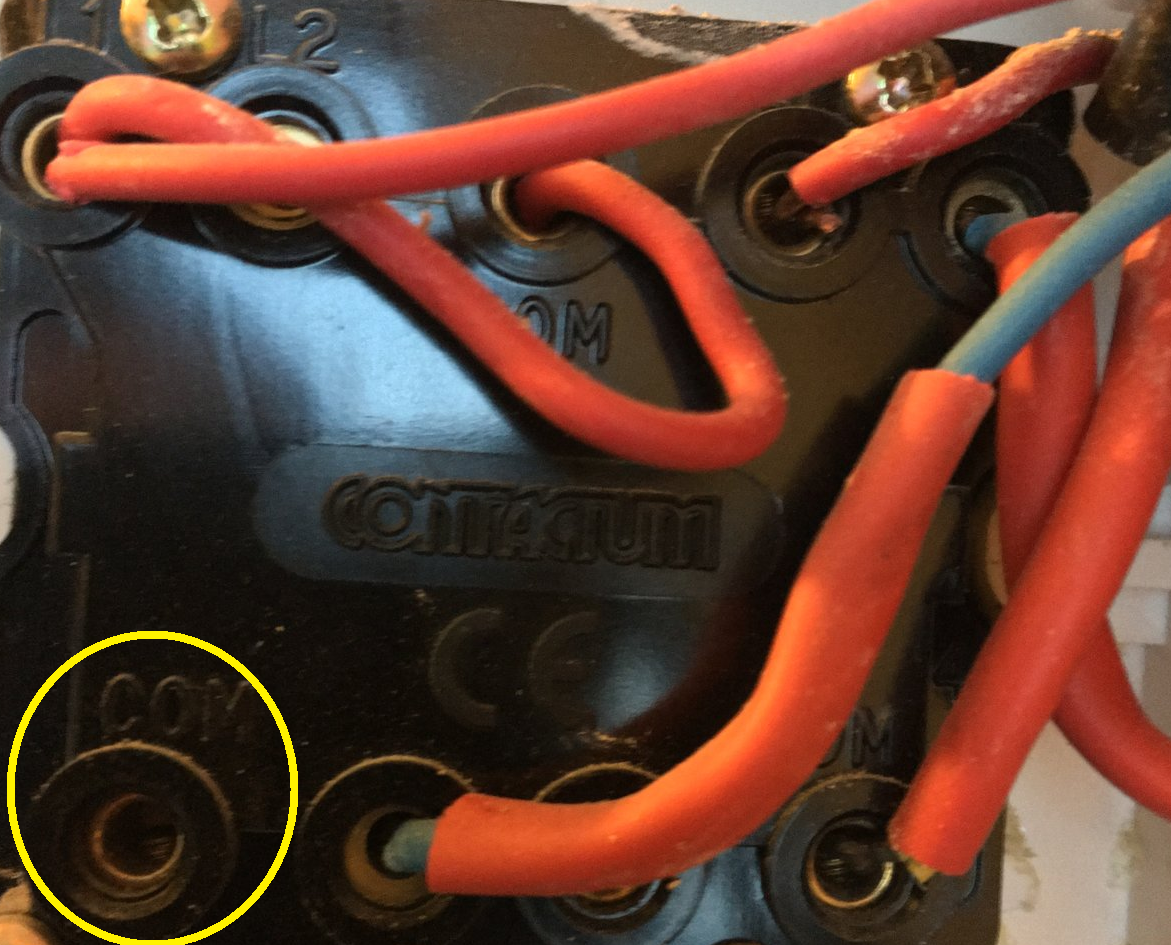

With the lack of anything in the terminal circled in yellow that switch cannot do anything. I'll guess the wire came out when you disturbed it, I'll also guess it's yellow.
