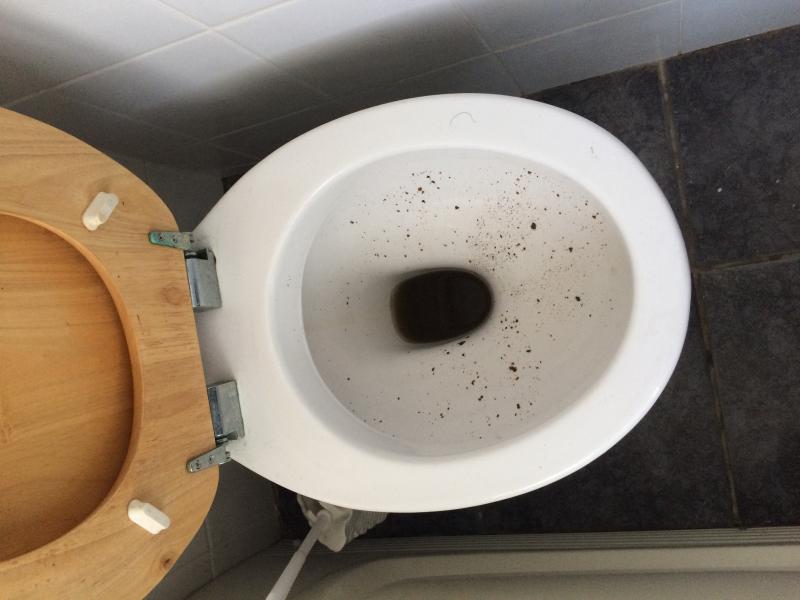

Cut the cold feed, bailed out water from f&e tank and washed the inside and vac'd it up with my wet&dry. Here's a pic of the crap that came out

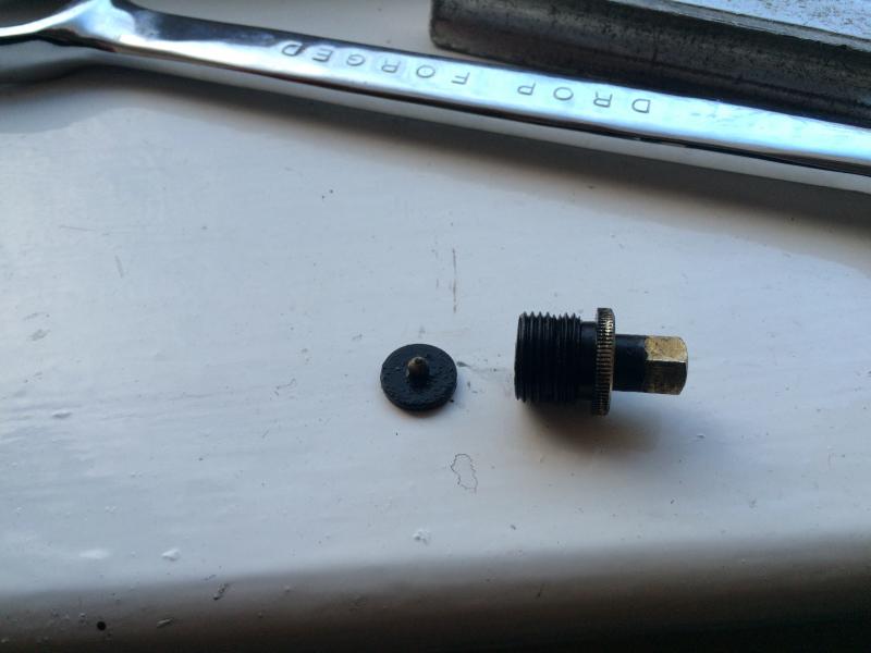

Found a drain valve passing water, this is why
