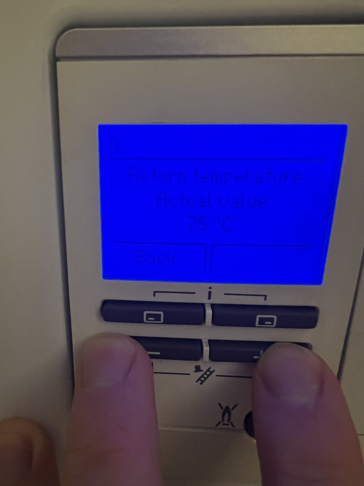

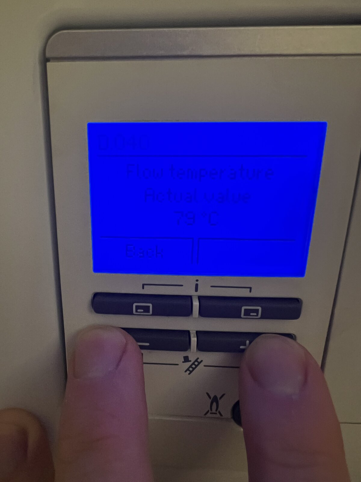

I'm still not sure about this return temp d41 as its always 5 degree lower then flow temp, I have jump through d40 and d41 on the video to show, the sensor position explain why it shows higher reading and most likely it working correctly but I don't know why the return water is hot inside the boiler but is not coming back from radiators, is this the bypass and if yes what could be causing it and should it be behaving like this?

if I increase the stat on the tank and put both CH and hot water tank the difference between d40 and d41 is still 5 degrees and the flow temp still goes above the set temp and cut off.
and that one radiator is still cold, that radiator is on the zone 2 which is heating 1st floor and loft but that particular radiator in in the ground floor next to entry door so the flow pipe comes down from the first floor and the return pipe goes back up to first floor so not sure if this is related to the pump head ? the boiler is on the ground floor and the main pipe goes to the first floor through the extension roof and I think it splits there, only 2 radiators on the ground floor next to the boiler are supplier directly via pipes on the ground floor, the rest goes up and comes down.
if I run just hot water tank alone it behave exactly the same it use the heating flow temp, goes 5 degree above and cut off and the difference between d40 and d41 is just 5 degrees

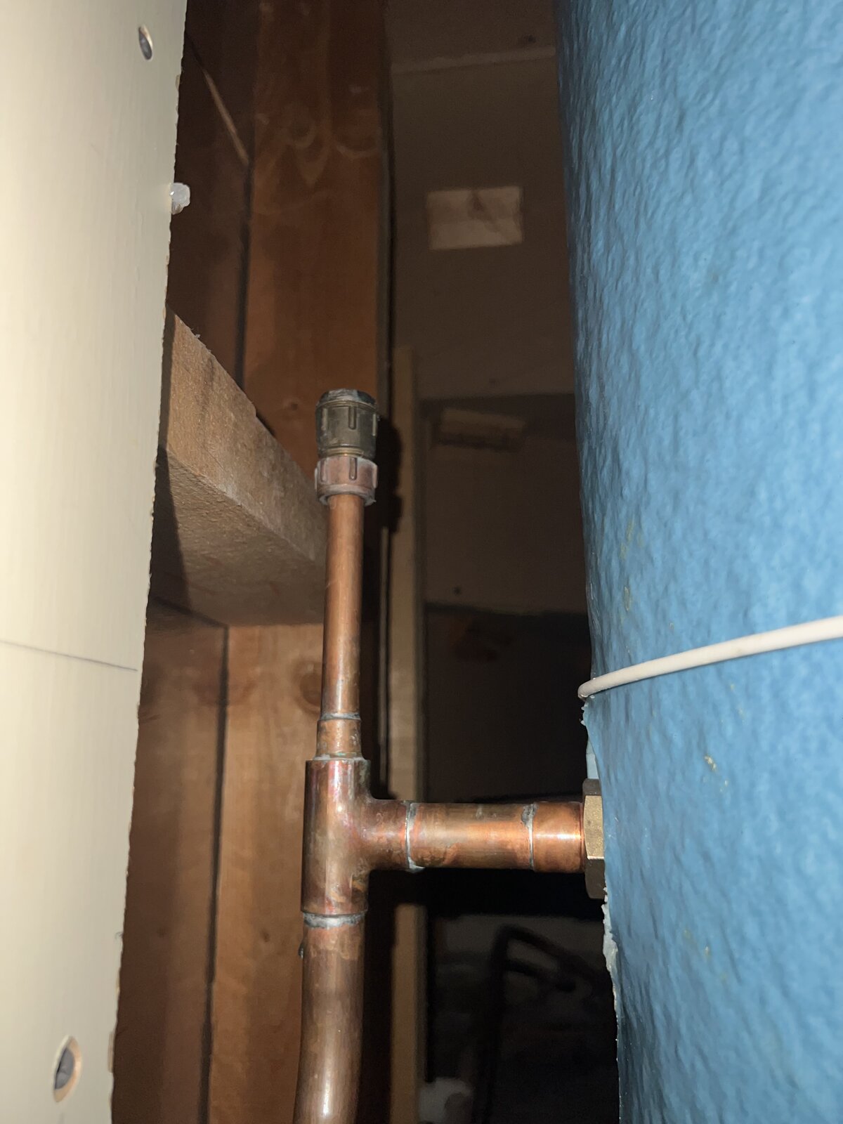

That just looks like a blank, you wouldny want to remoe that with a pressurized system but sonetime when next depressirized you could just have a manual lever valve ready to install after removing the blank.

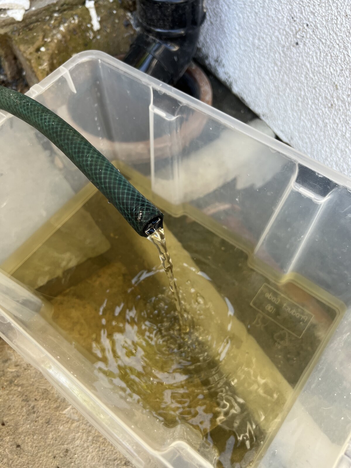

So I have drain water from the magnetic filter and dirty water came out so I’m draining the system again and will do it few times this is the water is coming out from the hose not sure if it’s dirt or it’s colour from inhibitor I have uploaded the video to one drive as I can’t post videos here
I have bought x800 as well so after I flush it few times I will run this for a day or 2 and drain few times again before adding inhibitor just to make sure it cleans the system again

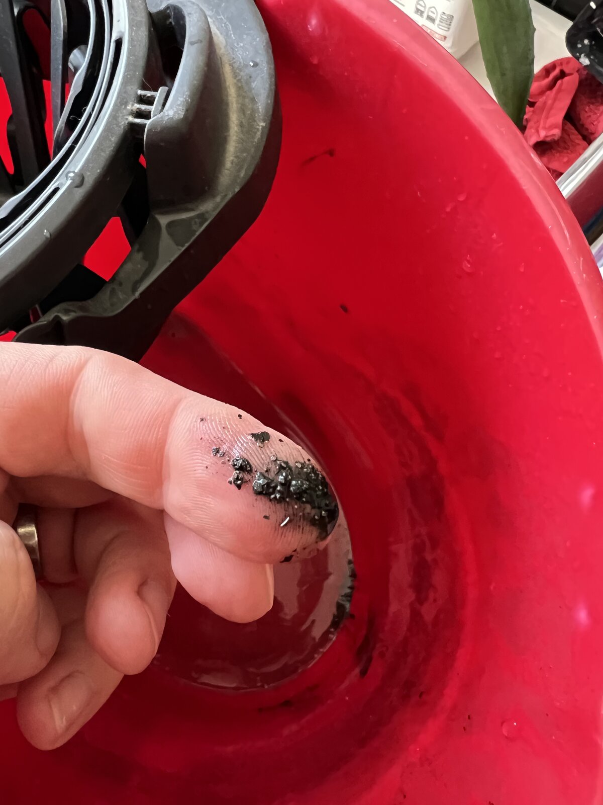

I have a bit of dirt from magnetic filter at the bottom and made picture as well if the water from the drain

Are you flushing through the boiler as well as through the rads or are you just flushing via the flow/return with boiler isolated?.
