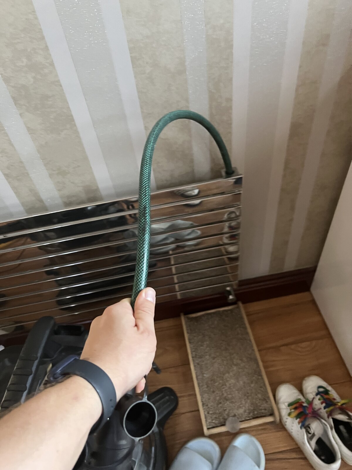

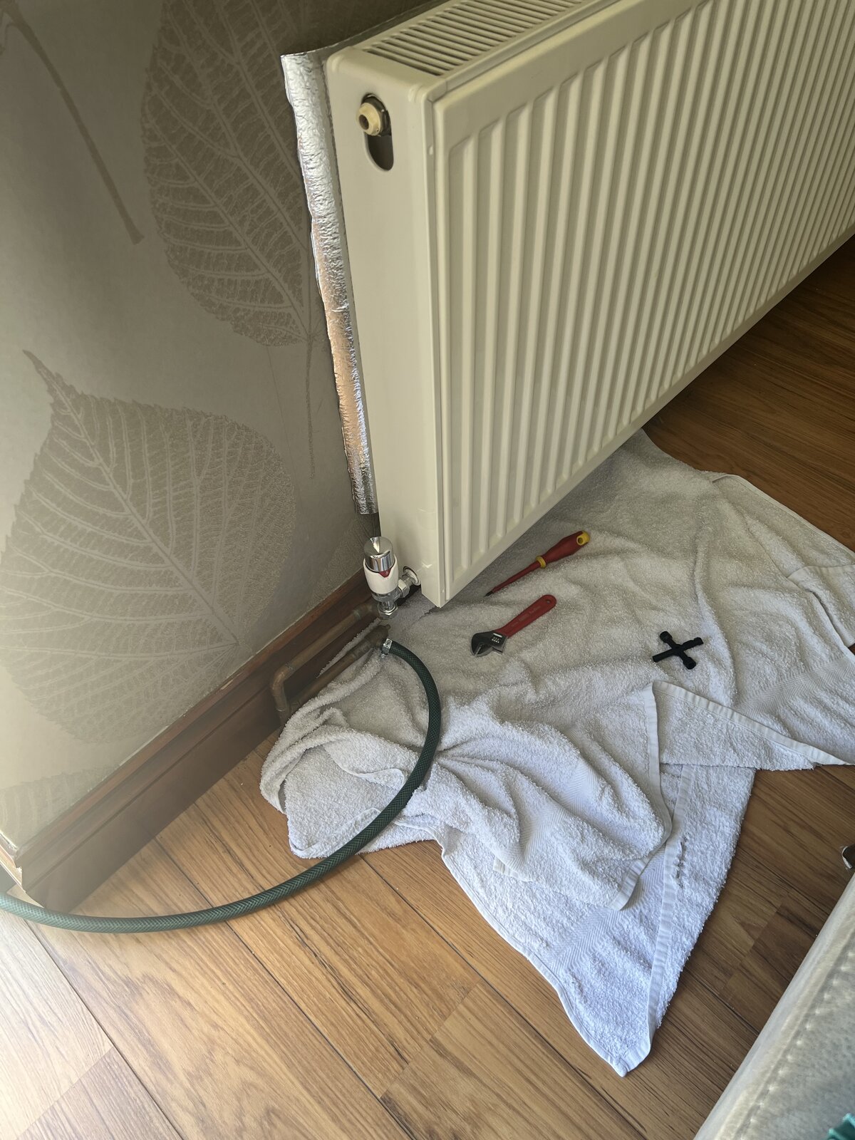

I put boiler to no heat, and connect hose to the drain pipe on the lowest point and open air vents and let the water go down.

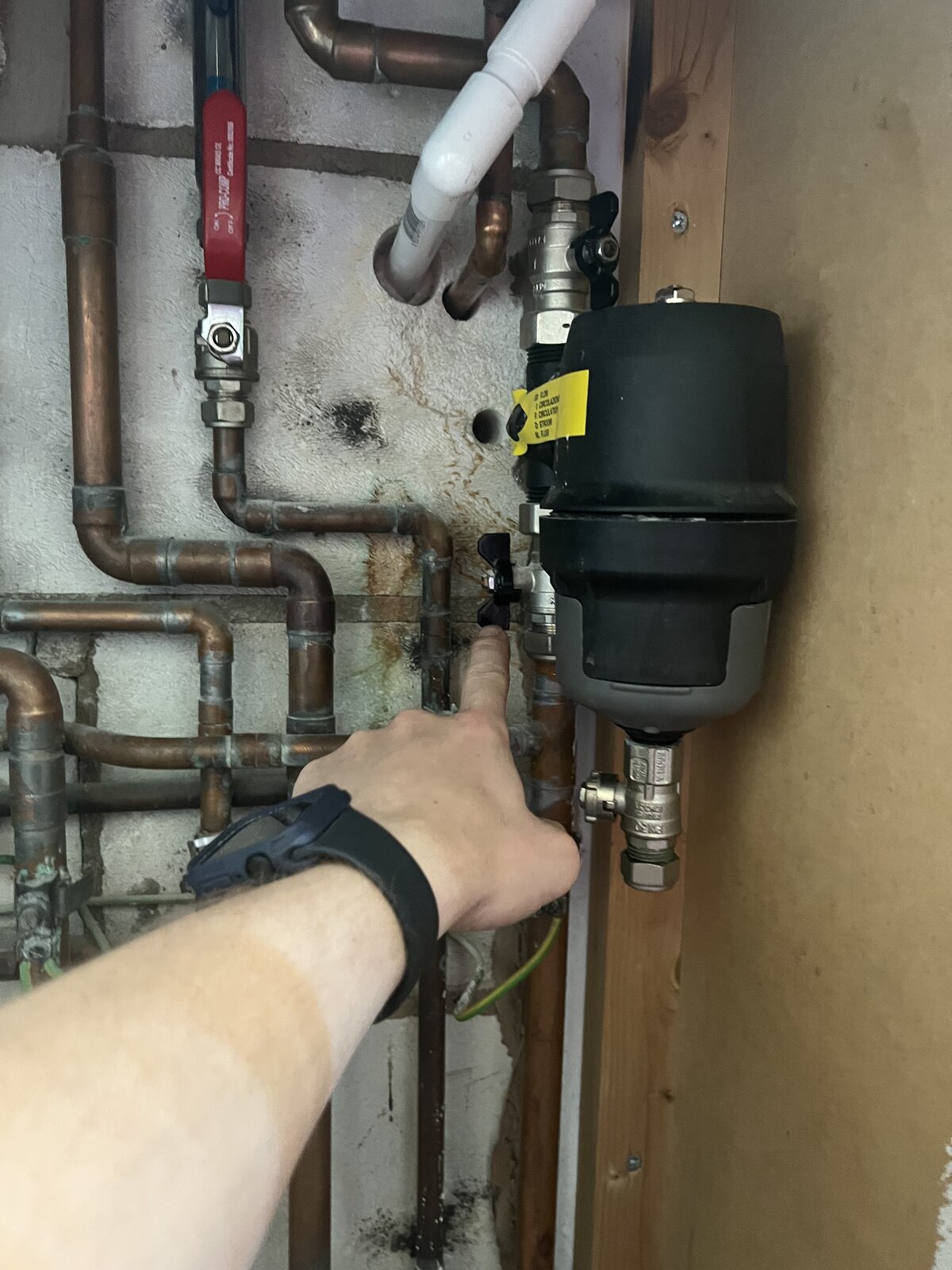

For the filet I isolate the 2 taps on the filter open the bottom screw yet the water drain and then I open the bottom valve (the one on the pic) and let the return water come through it and then I close it. I don’t open whole filter as apparently the o ring can go wrong on those and they can leak once open.
Should I do anything else?
This is the problematic radiator in the end I have open both caps and put hose and this is what come out in therms of the colour, don’t mind the fluffs (they are not from radiator) as the vaccun was used around the house.

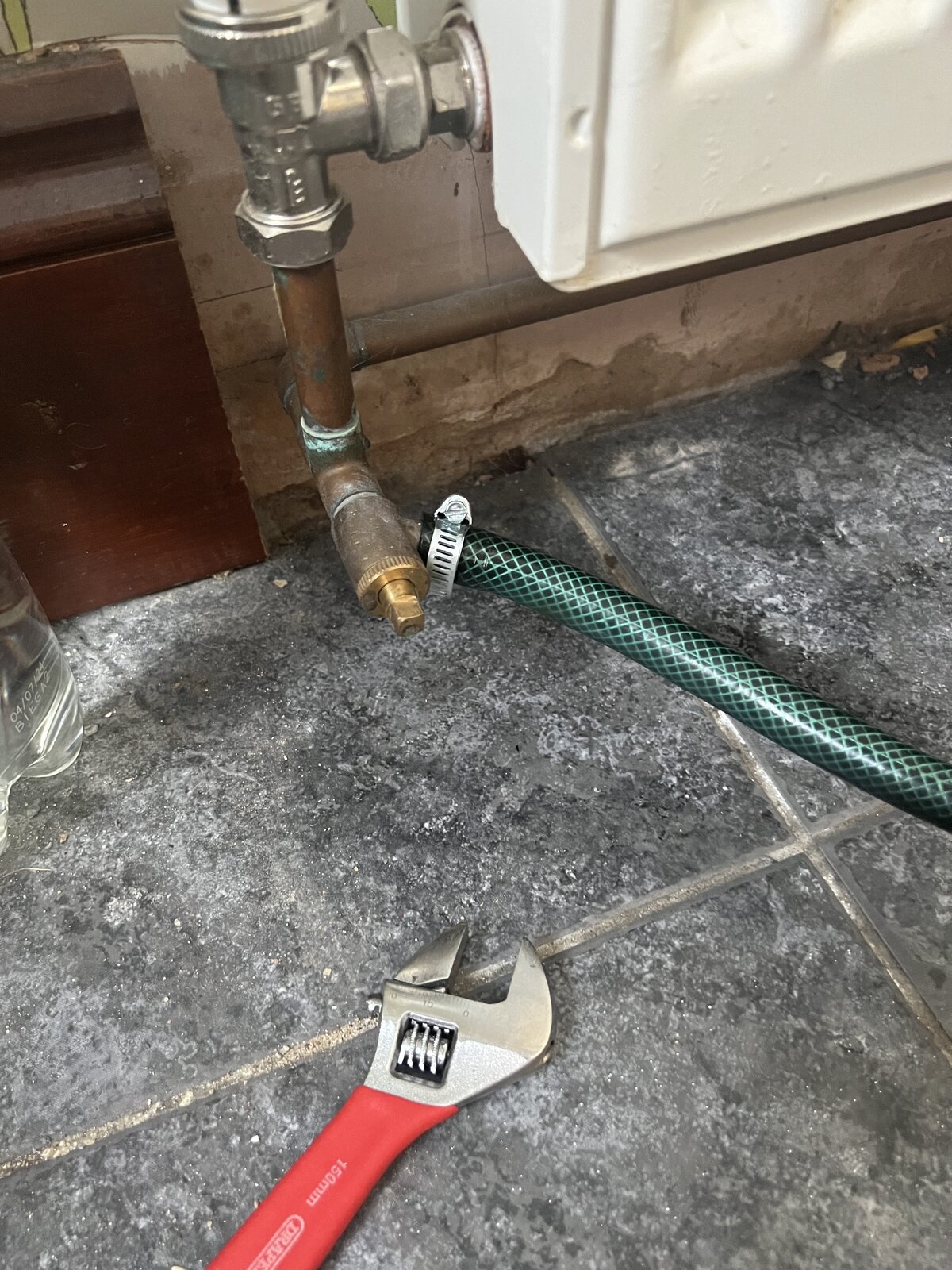

This is how I drain, I have 3 of those drains on the bottom floor.

Where are you flushing from?.
Unrelated query, what make/model of TRVs are installed?.

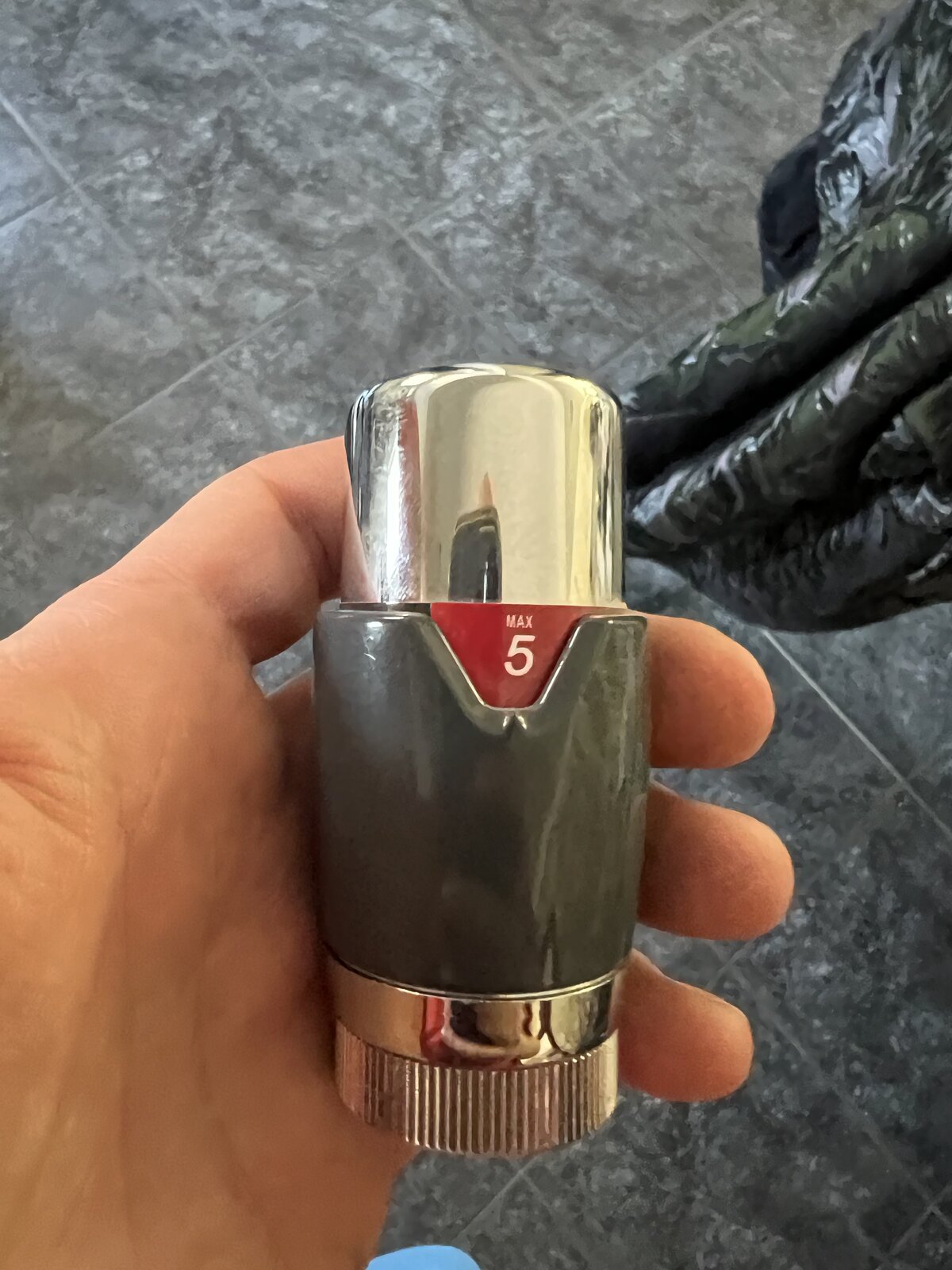

From all of those 3 drains on the ground floor and attached is the trv but does not say what it is I think trv4 ? Or newer model they were put in 2019

They do look like Drayton TRV4s, if you can use a (supplied?) key to do the balancing, they use a index 1 to 6 or something like that and are probably far easier to achive balancing with than trying to balance with the LS valve where even a 1/8th of a turn can make a big difference to the flowrate.
I presume the TRVs come set to the maximun index, otherwise maybe better to remove the heads before flushing.
not sure how they came as they were installed by Plummer so probably default setting, didn’t know you can balance on trv.

The TRV on setting 6 should definitely give you the max flow available, as long as the pin is fully extending, there is a flow chart, will have a look at it later.
