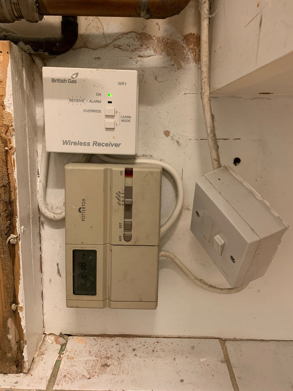

I have the following: Its in its untethered state as I am trying to replace it so forgive the mess:
I would be replacing both the old potterton timer and the WR1 / Drayton.
As I said what threw me was the extra wires in there that I wasnt expecting. So:
Instead of the timer to the WR1 there will be a direct mains feed to the Hive receiver, and then the link to the boiler.
The connection to the boiler still has 4 wires in it. I am not 100% sure of their function:

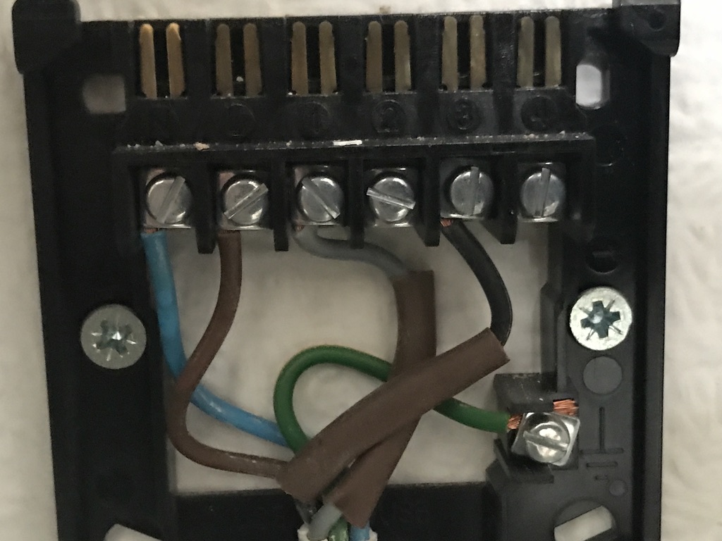

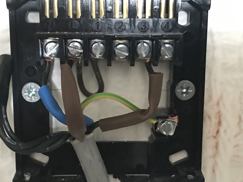

I want to install a HIVE Dual Channel Receiver on the back plate where the WR1 is located. I am ok with the live, neutral and earth cables. I am ok with isolating the system when working on it...it has the necessary fuses and is easy to isolate.
On the WR1 I have a Grey cable (Brown sleaving) connected to terminal 1 (COM) and a Black cable (Brown sleaving) connected to terminal 3 (HTG On). This appears to wired in single channel configuration. The new Dual Channel HIVE has HTG On (4) and HTG Off (2). Photo attached.
My question is what do I do with the Grey cable (COM) and is it needed? The Grey cable (COM) is terminated at the wiring centre, in this case terminal 3. There is a cable link in the wiring centre from terminal 3 to terminal 7 (HTG & HW Grey). Photo attached. As for the other WR1 I presume I simply move the Black cable on the backplate from the current terminal 3 in WR1 configuration to the HIVE configuration terminal 4 (HTG On)?
On the UT2 I have a Black wire with a Brown sleaving connected to terminal 3 (HW On). There appears to be a cable link between the live and terminal 1 (COM). Similar question is which cable(s) to connect to which terminal(s)? I presume I move the Black cable from terminal 3 in UT2 configuration to HIVE configuration terminal 3 (HW On). Photo attached.
