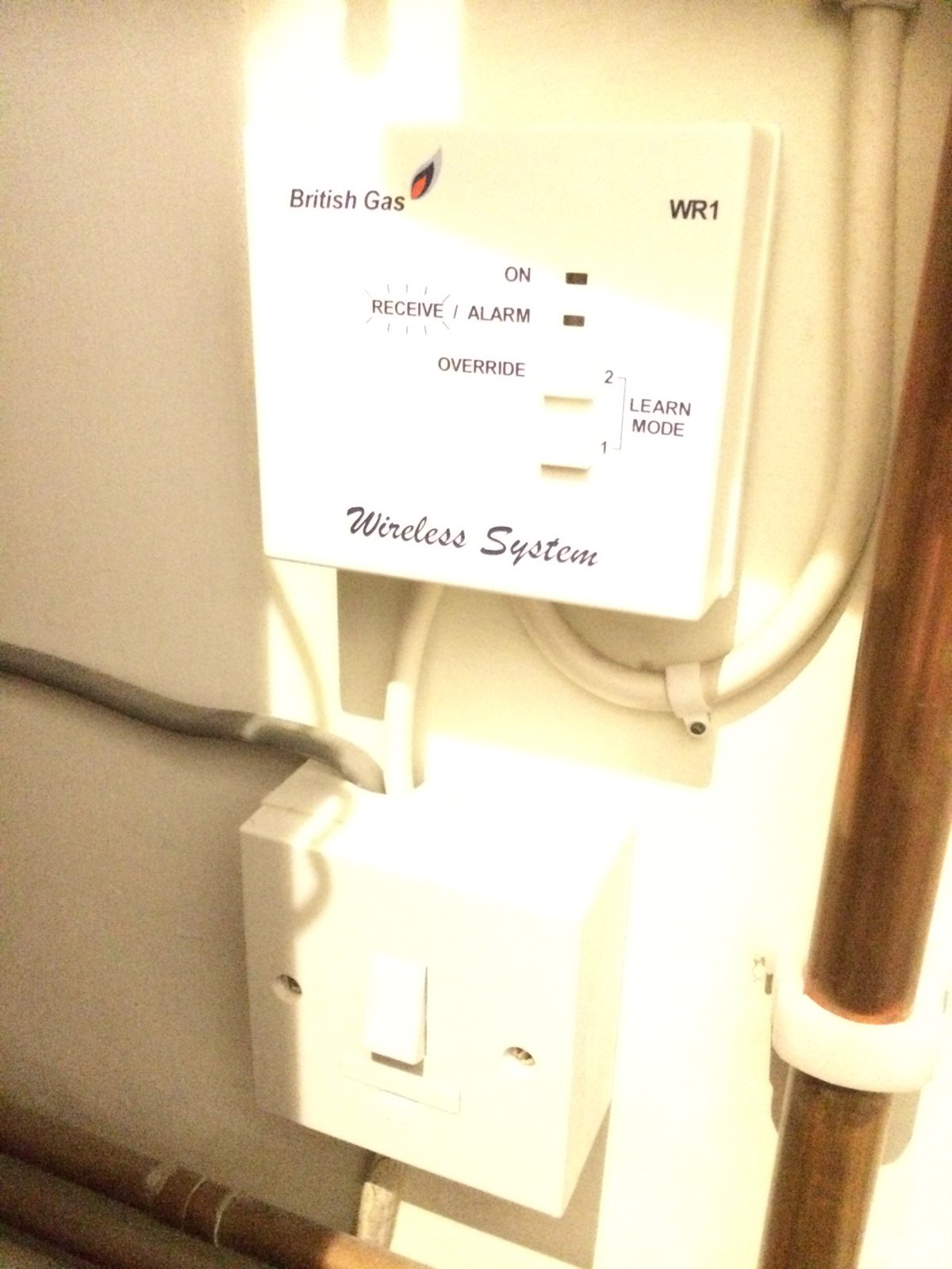

I am also on the same boat. after reading this forum, i think mine is also a direct swap. Can anyone confirm as i do not want to break my boiler. Thanks guys!
Yep that’s exactly the same as mine. Easy swap over - you just swap the outer casing that you’ve taken off. Honestly really that easy.
Thanks ravsaidha,
Have just received HIVE. Will do it now. Wish me luck! will keep you informed.
As you said, i have just replaced the top part of the receiver, not even need to install the new plate. Got everything working in 15 mins. Also got my Alexa links to Hive, now i can control heater by talking to Alexa.
Thanks everyone.

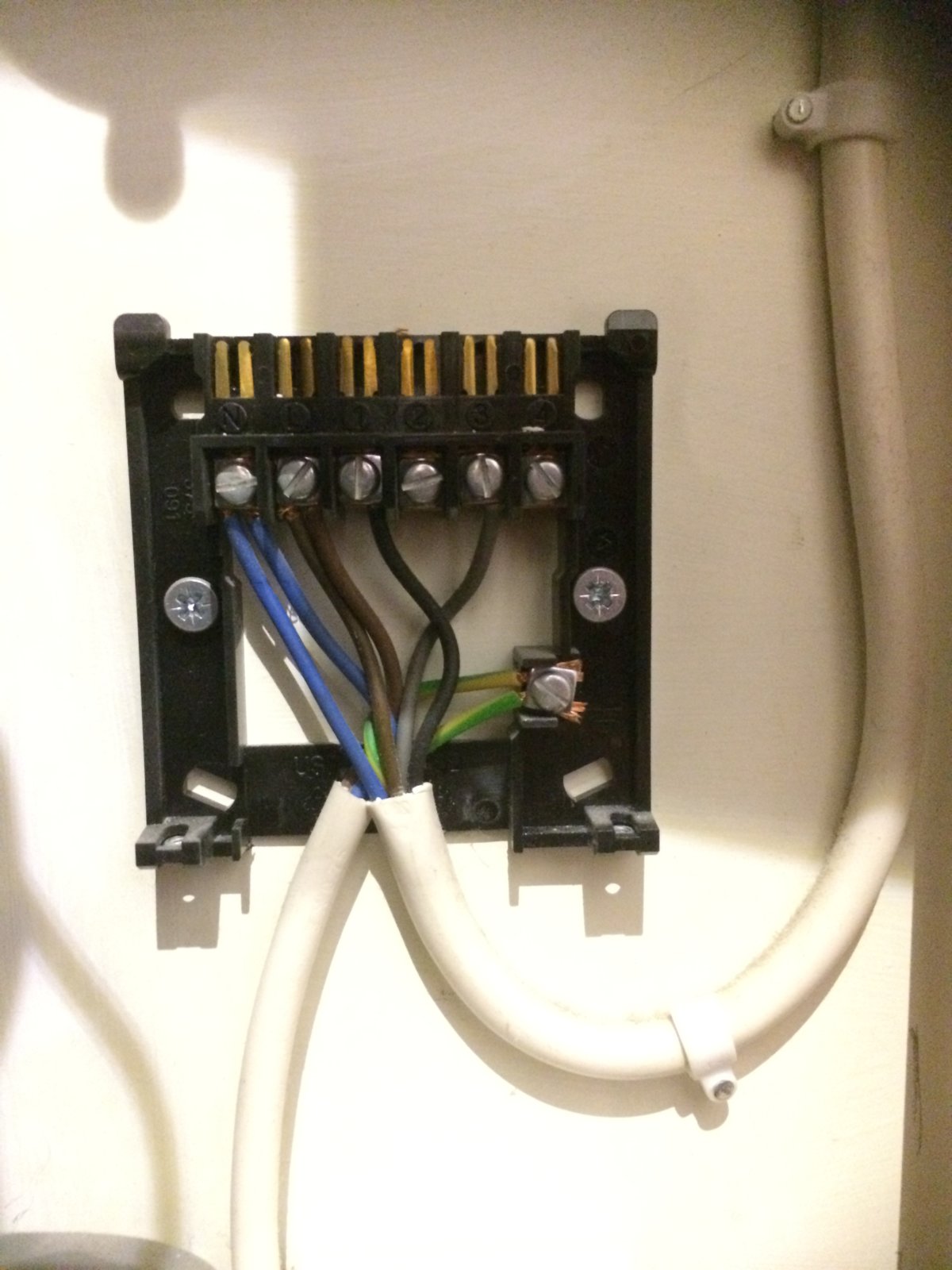

Hi, I have the same setup as above. I’m looking to replace the wr1 with the hive single channel receiver, silly question but does the power need to be off when swapping the units over as ideally I don’t want to power down the boiler as I’ve had problems restarting it in the past.
Am I missing something? In both cases your wiring is connected to the hot water ON and hot water OFF terminals of the backplate. Surely the outputs should be from terminals 3 (HW) and 4(CH)?
And you're saying it was a straightforward clip off, clip on installation?
no the hive single unit switches between 1 +3 as does the existing receiver
Thanks Dean - I have a Greenstar Combi Boiler but I'm confused where the hot water part is coming from? I would have thought we'd have the same model...never is that easy is it!
On this link (WR1 = Drayton) (http://www.draytoncontrols.co.uk/sites/default/files/Digistat1RFUIGuide.pdf) it appears to say:
N = Neutral (same as Hive)
L = Live (same as Hive)
1 = Common (same as Hive)
2 = Heating satisfied or call for cooling (is this Heating off?)
3 = Call for heat (same as Hive for Heating on?)
i'm looking at the Hive Single channel by the way
am i missing something really obvious?

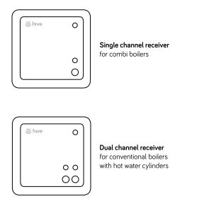

yes the hive only controls the heating a combi boiler the HW is controlled when a hot tap is run, the hive dual channel is not for a combi boiler
