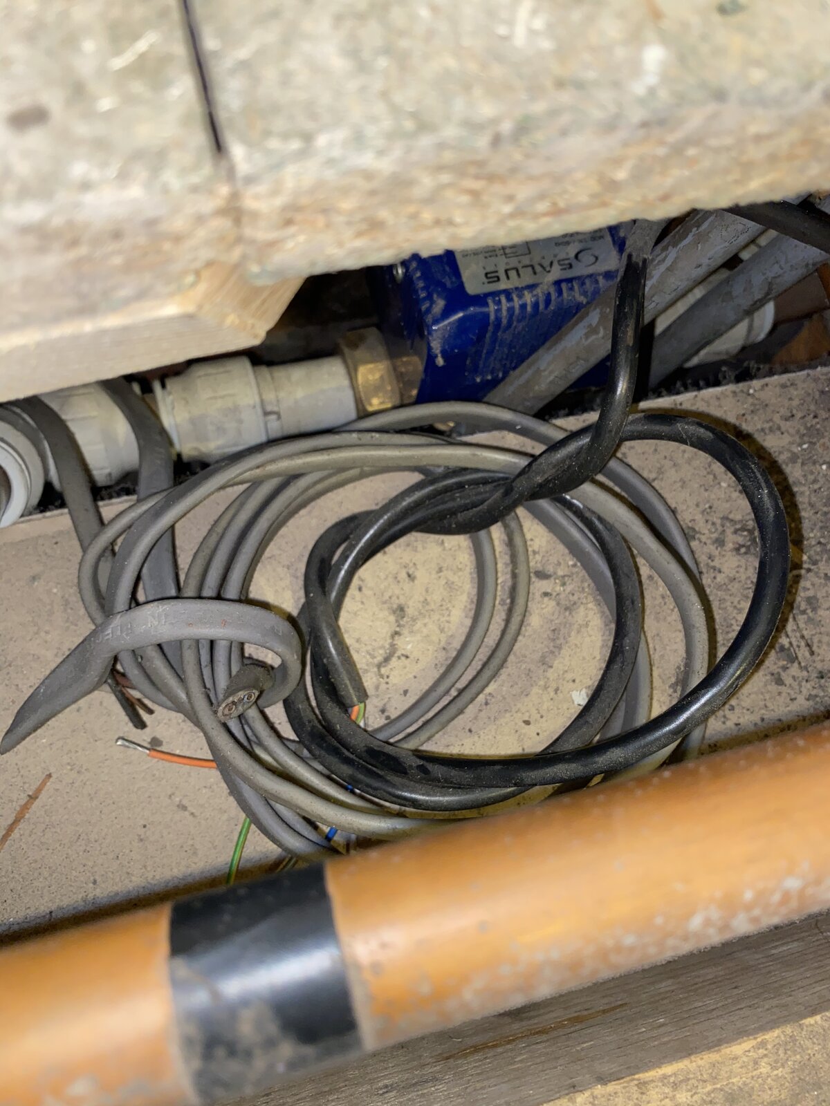

yes there’s a salus two port valve on the second floor beneath the floor boards. Only reason I know this is because it started ticking yesterday after my boiler was serviced. Blue box thing, I had no clue what it was

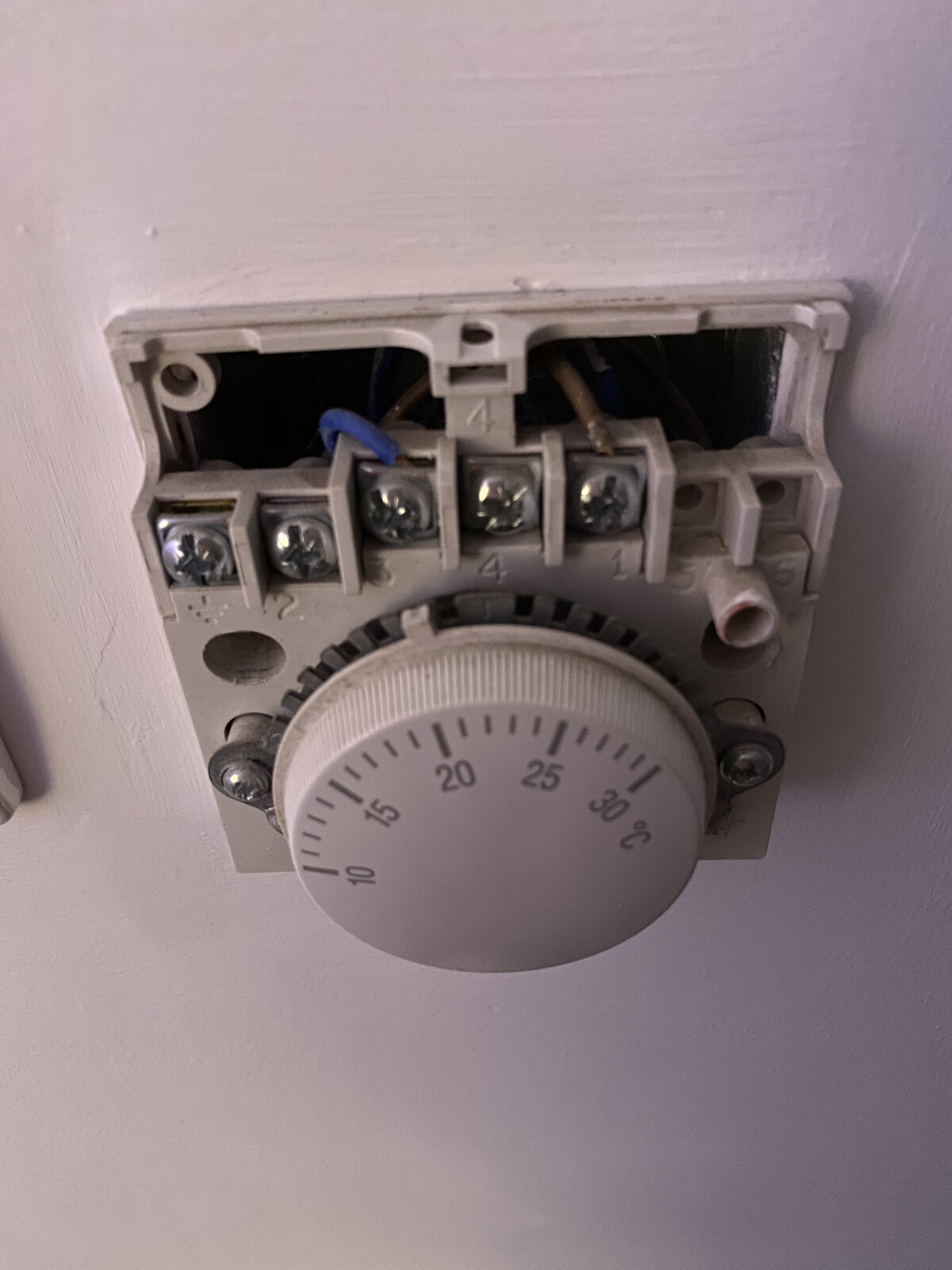

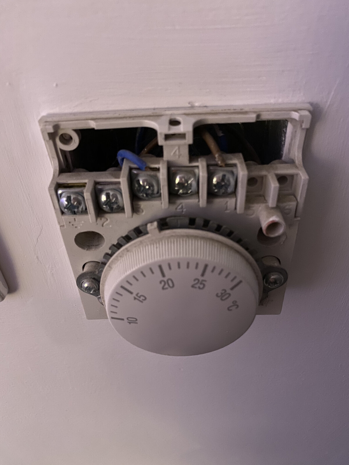

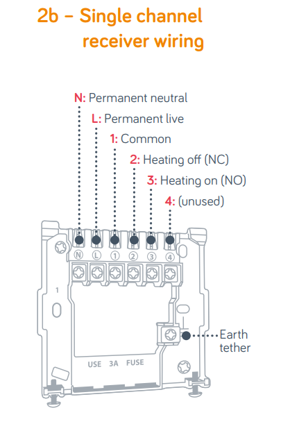

The white wire in terminal 3 is the HW on wire, that is wired up as a system/heat only boiler not a combi

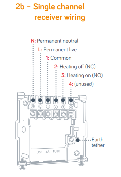

So which colours would you suggest where on the hive?

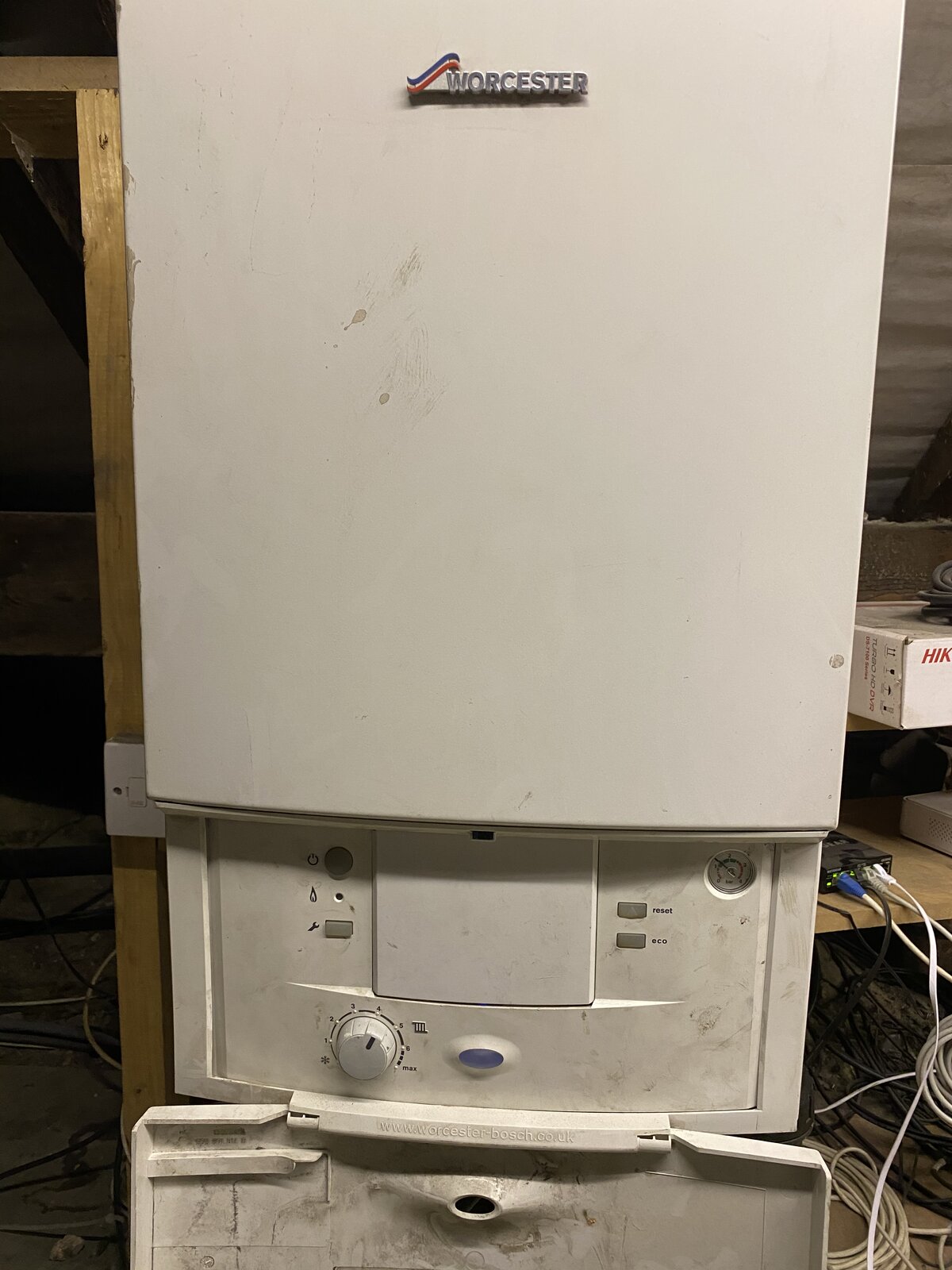

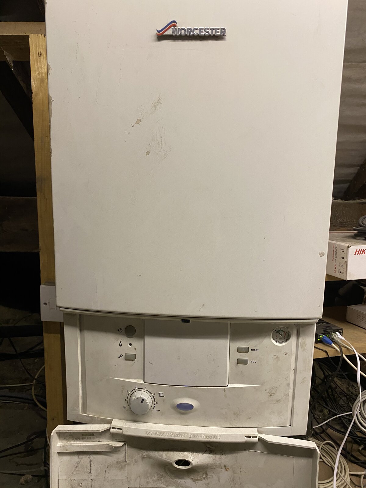

Not as straight forward as that as you have said you have a zone valve and your wiring is set for a system and not a combi , post a pic of your boiler, it could be that someone has wired the HW on to power the thermostat that you refer to that heats the bedroom, but I am only guessing because I havent seen it
okay thanks for the input mate, I’ll get some more pictures when I’m back home from work. Anything pictures in particular which would be more helpful?
Just the boiler, one of the zone valve would be helpfull, but realise it may not be accessable, if you do indeed have a combi boiler the wiring of the single channel hive is straight forward but how you are going to wire in that zone valve and individual thermostat is not so straight forward as we dont know how it is wired in
I can get a picture of the valve the floorboard comes up easy enough in the spare room. I’ll also get a picture of the boiler cheers.
Just an update on the picture front.
so looking more closely at the zone valve the wires don’t seem to be connected but like I said previously I only found this due to it making a ticking noise after my boiler had been in service mode, this stopped after the heating come back on.

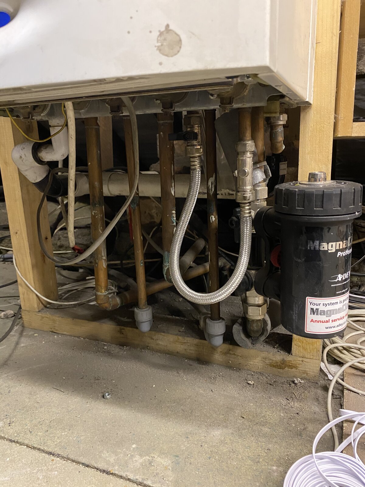

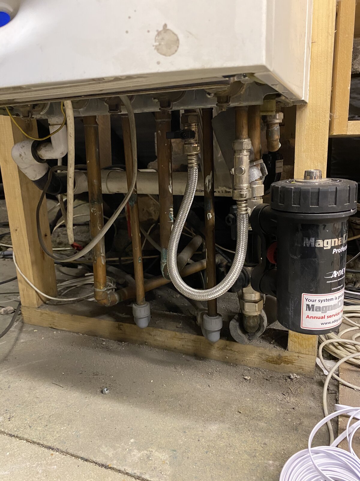

Post a pic of the pipes on the underneath of your boiler please
Sorry I did take that photo just forgot to upload it.
Sounds like it is a Heath Robinson set up for a two zone system, you wont be able to use a hive single channel to operate this, you could use two single channel hives , do you really need the lounge on a seperate circuit ?
Thanks for the update.
I’m not bothered about having the lounge on a separate circuit, so what would you suggest?
Two things, one no reason why a programmer designed for CH and DHW can't be used to work two zones, but second is this picture.
2c3d8f42-0445-4d45-a2bf-c12cc3af9a24-jpeg.211855
That black coiled up cable seems to have an orange core, so looks like the wires for the motorised valve, you said you heard it ticking, was that simply expansion of the pipes, or the valve moving, as to if when combi fitted pipe work left behind, or if it does some thing don't know, when my dad had new central heating fitted they left loads of the old pipe work in place, not connected to anything.
You clearly want better control, that boiler looks like the one my dad had, the electric control was simply, on or off, no opentherm or any other cleaver controls, however it was a modulating boiler and worked well with the radiator thermostatic valves (TRV) so all I did was fit electronic heads the the TRV's and controlled the heating that way. eQ-3 are cheap enough found them at £10 each, OK I used an expensive one the MiHome Energenie, I had intended to fit Nest, but when mother died we sold the house, so never fitted.
