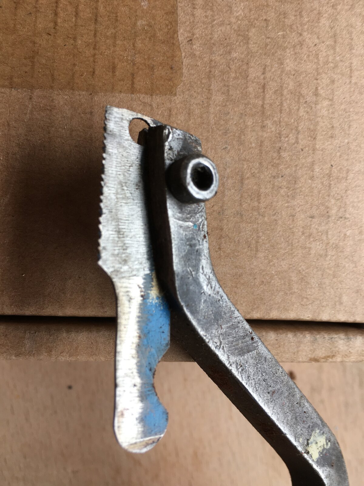

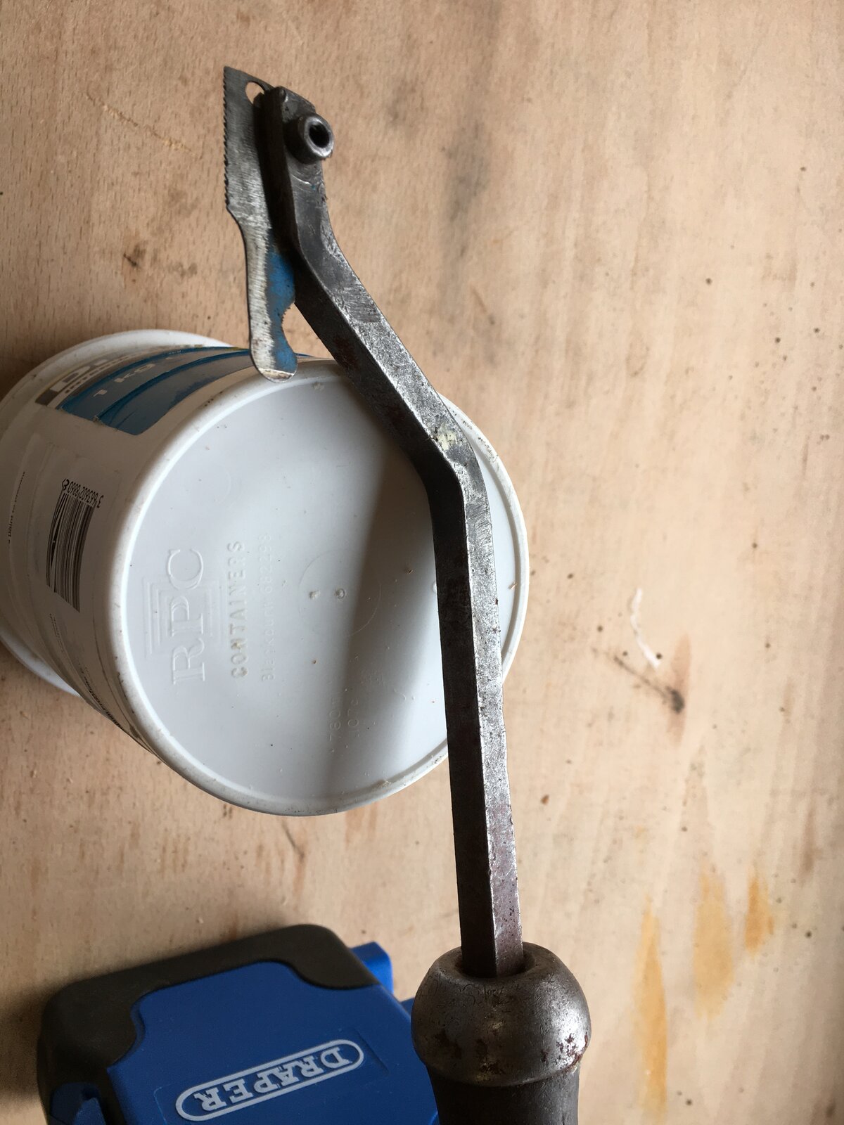

Correct. But instead of a pin we would use a cut-off hacksaw blade which we would run across a grinder to remove the slight kerf on the teeth. GENTLY 'saw' into between the segs until the mica begins to look clean, not forgetting to shave it off the sides of the segs, and take off the minimum amount required to clean away the old carbon deposits. You don't want to go deep as this can destabilise the commutator.
On larger commutators I'd have made the same recommendation, I'm assuming this is something like a drill motor and suggessted the pin to reduce the likelyhood of damage.
At work we had a selection of purpose designed tools in different thicknesses which were basically as you describe - saw blades with about 6-10 teeth but without a set.
This is what I am referring to. Found this in my shed. Thought I had lost it years ago.
