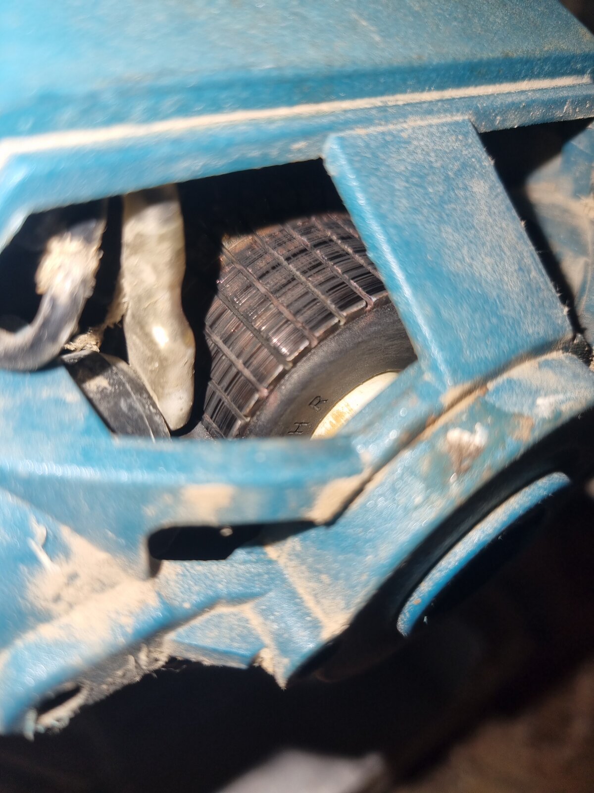

My old Makita saw is sparking when you power it up to cut. I removed the carbon brushes they seem ok. But lots of sparking when I spin it up is it the commutator or? Also note it only one side the rear or right hand brush as you can see isn't sparking at all.

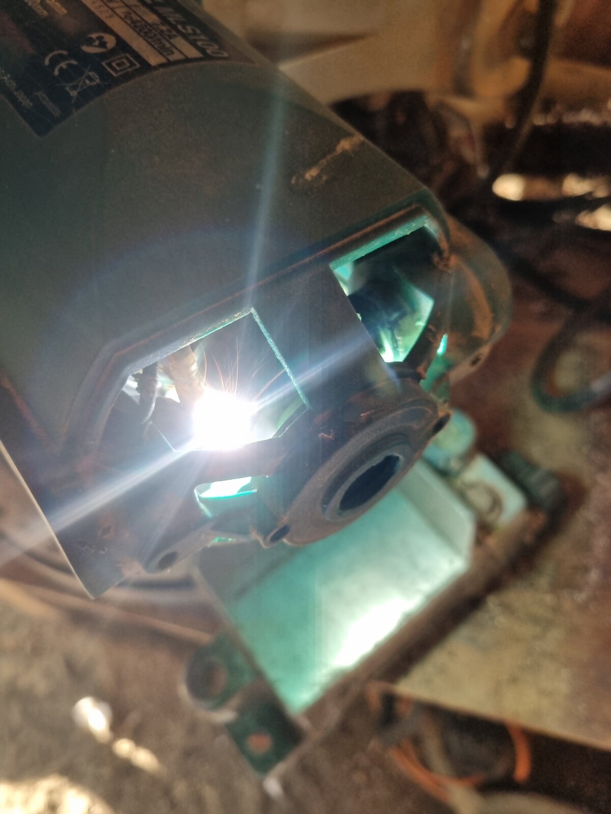

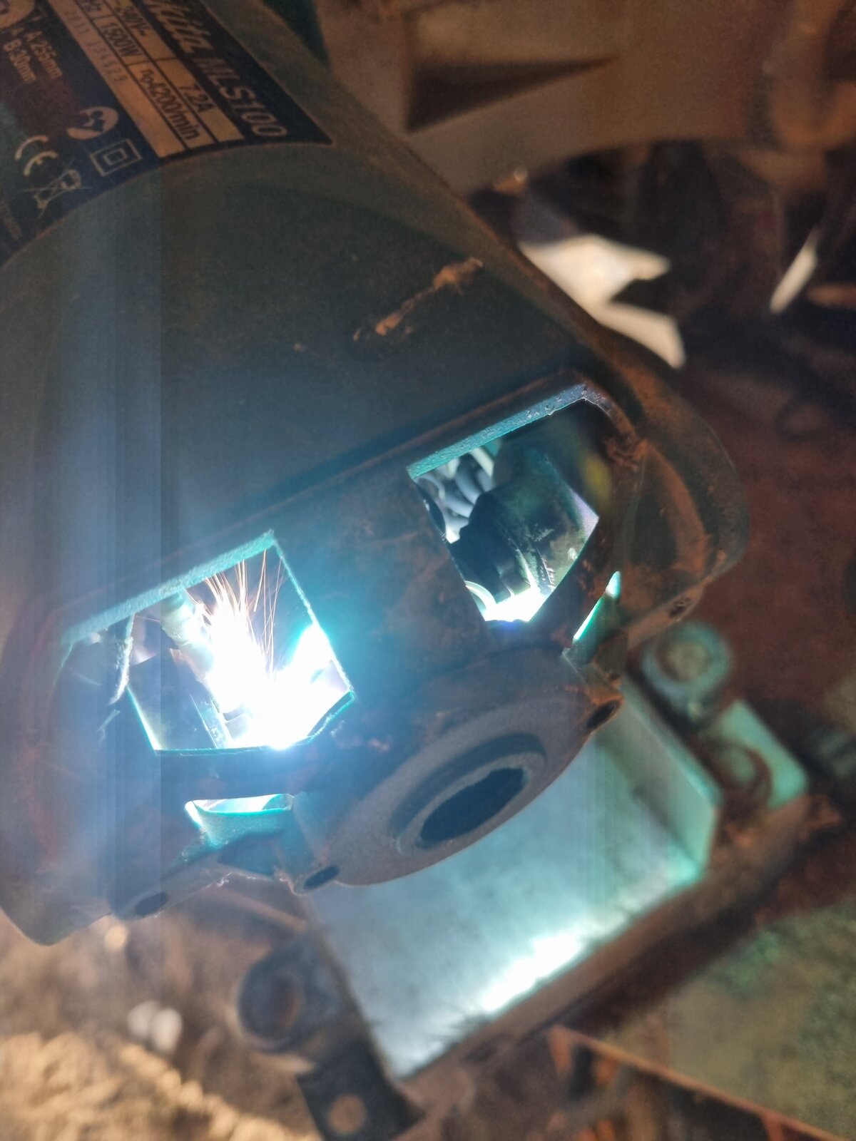

And another pic of commutator
Shorted turns on the armature seems likely. Nothing much you can do, other that buy a new one, but likely to cost as much as a new machine.
