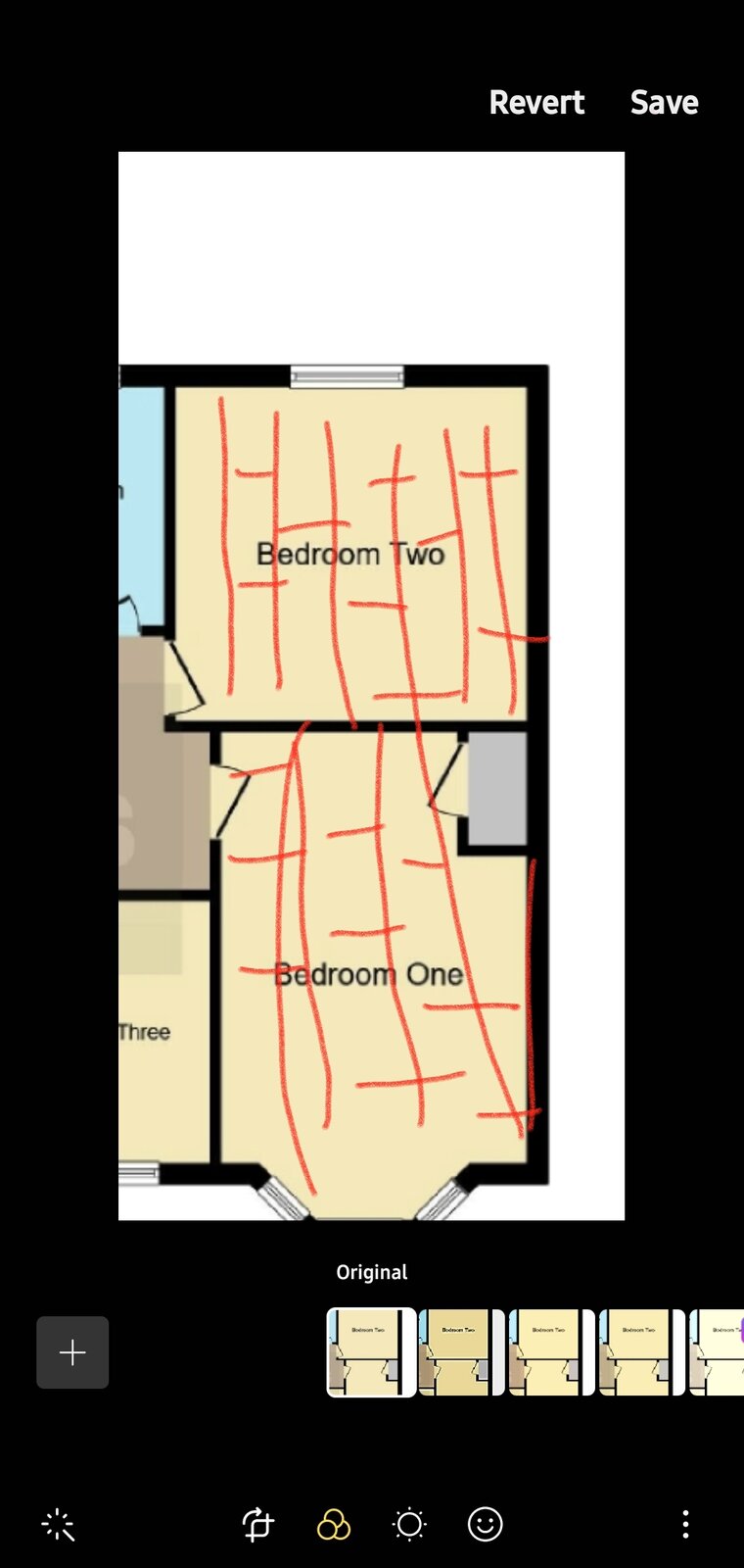

I can see the floorboards are like this. Sorry about the messy drawing.
If the floorboards are perpendicular to the wall in question, then the joists go in the opposite direction, i.e. do not land on the removed wall.
From your sketch it looks like the upstairs floor joists are perpendicular to the removed wall.
In that case it's likely that the wall is (was) supporting the joists.
Get building control involved.
What do structural engineer calculations say?
If those joists run top to bottom of your diagram, then a proper support is needed from left to right in your diagram. What you show in your photo, timbers laid flat, and too short bits, absolutely will not do.

The OP was asked to show the floorboards - I'm guessing that's what that awful drawing is depicting. In which case the joists will be parallel with the removed wall.

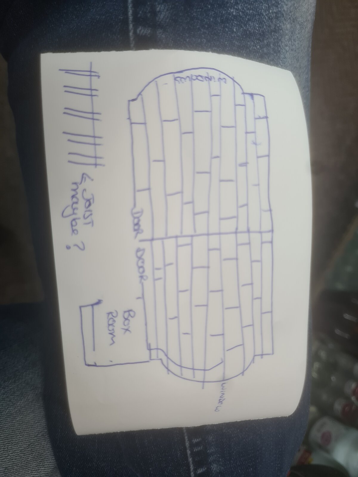

Hi they are floorboards. I will be visiting the house tonight and see whats underfloorboard
Once removed (wall between livingrooms) they ended up adding a long timber saying there is no weight above as the above wall is 1-2foot away (which is the bedroom wall)
That would make sense provided the joists are parallel to the wall removed - as the upstairs wall must be supported by a beam running across below it.
And therefore the ground floor wall was doing nothing, just stopping between 2 joists.
If the joists we’re running perpendicular, then most likely given the large span front to back 2 joists wouldve been used to make the span, overlapping each other above the ground floor wall which would support them. The upstairs wall would’ve been sat on the joists.
those are the most likely options

Sorry, your drawings are still not making sense. Floor boards, always run a right angles to joists - no exceptions. You have drawn vertical lines down your diagram - do those vertical lines represent the way the floorboards run, or the joists?
If they represent the floorboards, then your builder is correct, no steel or any support is needed. If they represent the joists, then a steel is certainly needed.
Hi, the drawing which says door window is drawing of the floorboards with bedroom wall in middle
The drawining at the bottom is what i can see under floor
